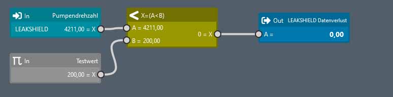

Das Problem ist bekannt und es wird sicherlich auch gelöst werden.
Ich habe dieses Verhalten in unregelmässigen Abständen und mir einfach einen Softwaresensor angelegt, den ich dann an eine Ausgabe leite, Desktoppopup und Mailnotifikation mit Verzögerung.
So bekomme ich nicht bei jedem Systemstart eine Mail, aber sofort eine Desktopbenachrichtigung.
Zur Häufigkeit bei mir, es variiert stark zwischen einem und 8 Tagen.
Hier mein Softwaresensor aus dem Playground

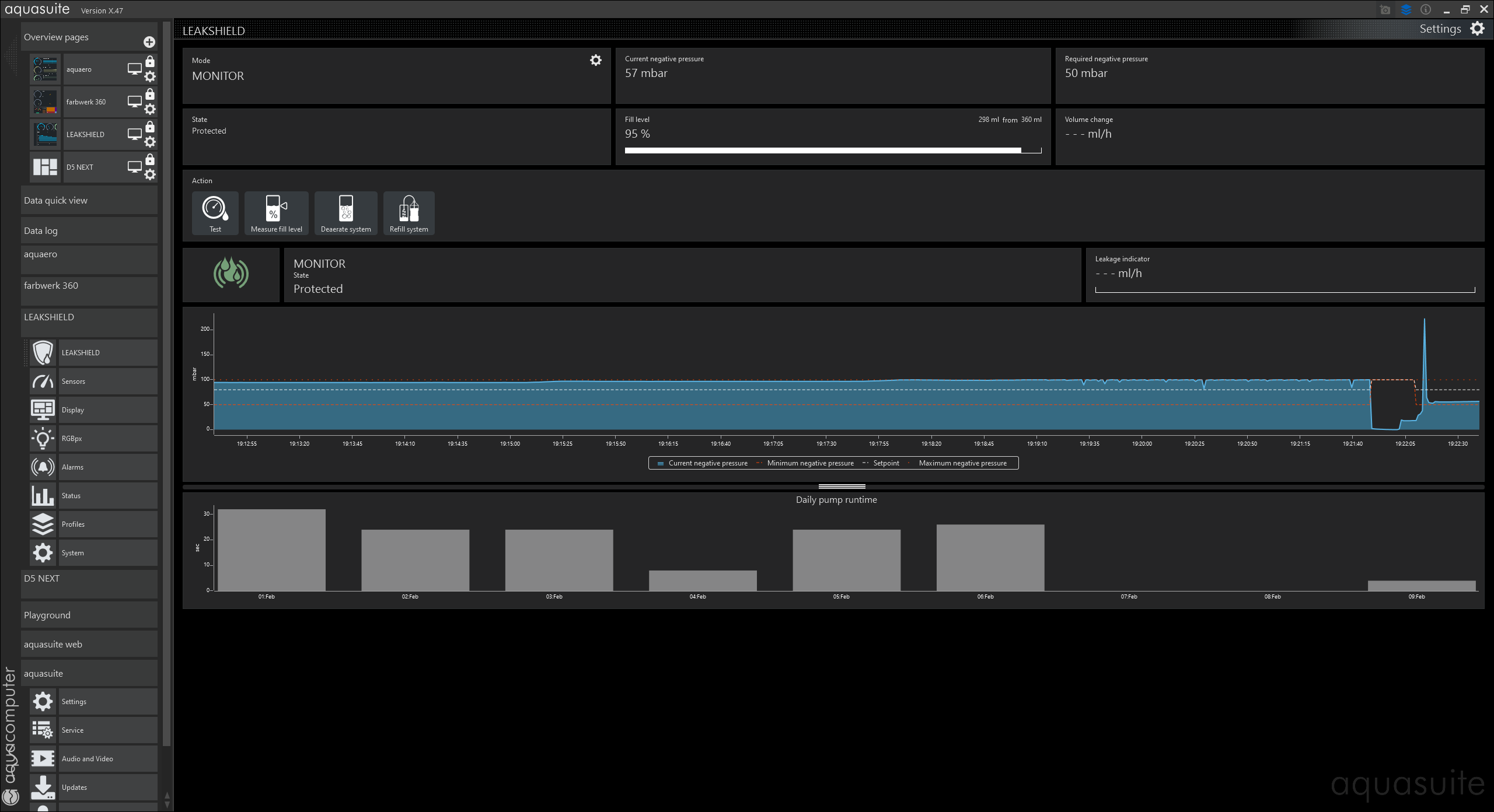

One thing I have noticed is when Leakshield loses the sensor data it's impossible to get it to accept a feed from any source. If I try to setup a constant tone output via the playground, I am able to add it as a source on Leakshield. But it still shows up as "----". Even if I try to add the pump rpm feed to a new software sensor on the leakshield it shows up as "----" but you can see the rpm data in Aquasuite.
To me, this seems like an issue with leakshield itself having some kind of crash. As opposed to an issue with Windows or motherboards. Especially considering that all the data is available to Leakshield to use, and even creating known good artificial data is not accepted.
This happens to me daily. I shutdown my PC at bedtime and start it when I'm ready to use it, typical on time is 12+ hours. The problem is it happens at seemingly random times within the power on window. Usually just the one time and unplugging and replugging the header seems to be a good workaround. It's not like it always fails at x number of hours of on time. Sometimes it'll be within 5 minutes, other times 11 hours.
I have an ASRock B550 steel legend ATX motherboard, 48 GB of ram, an EVGA rtx 3080ti hydro copper, and a Ryzen 7 3800xt.
I really wish they would hurry with a fix. My normal pressure is 100-150milibar and when the feed drops it spikes to 450milibar. The difference is not insignificant and I'm worried about the integrity of my loop. It's kind of ironic a device supposed to eliminate the headache of loop leaks is a potential cause of loop leaks.

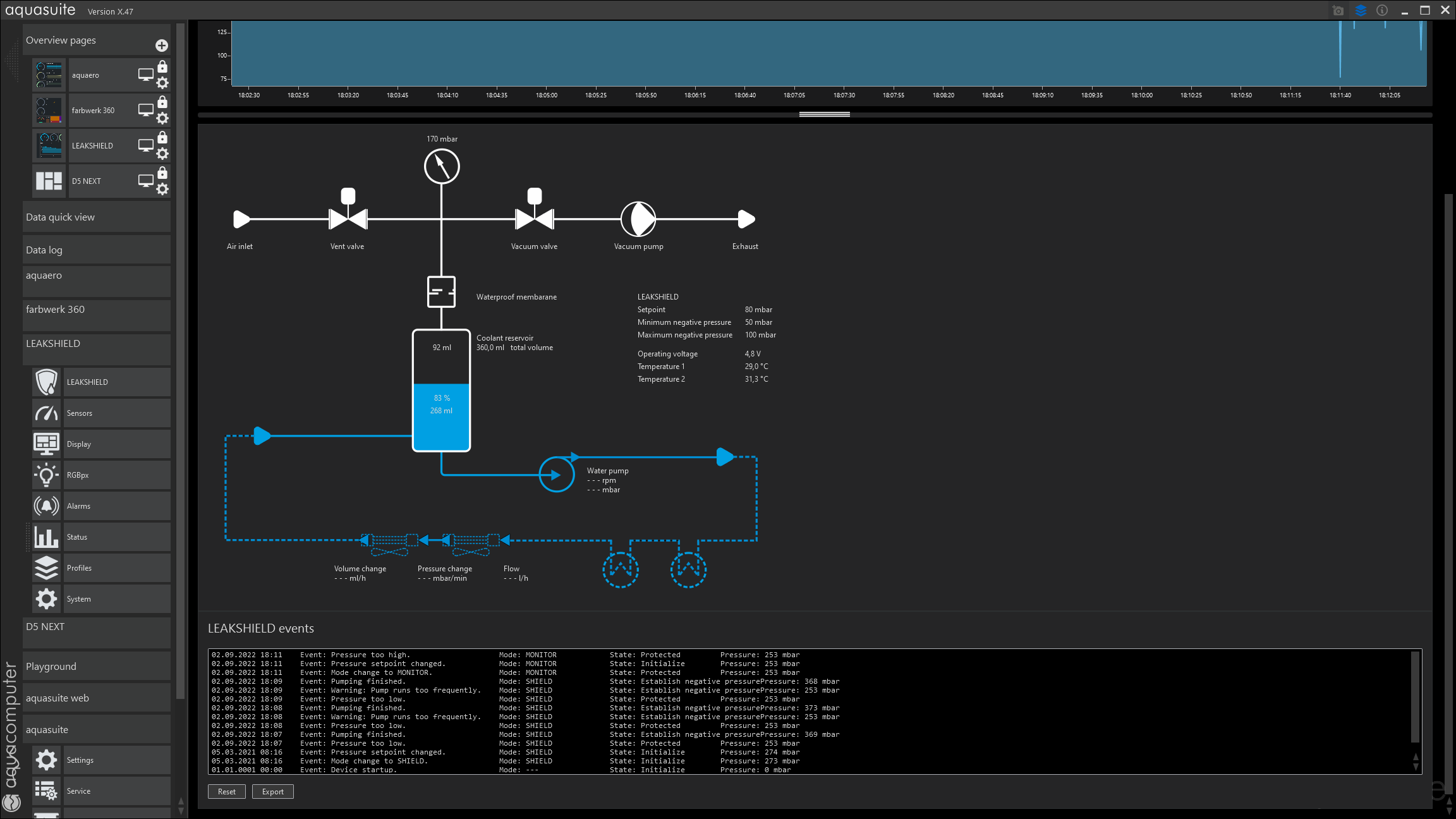

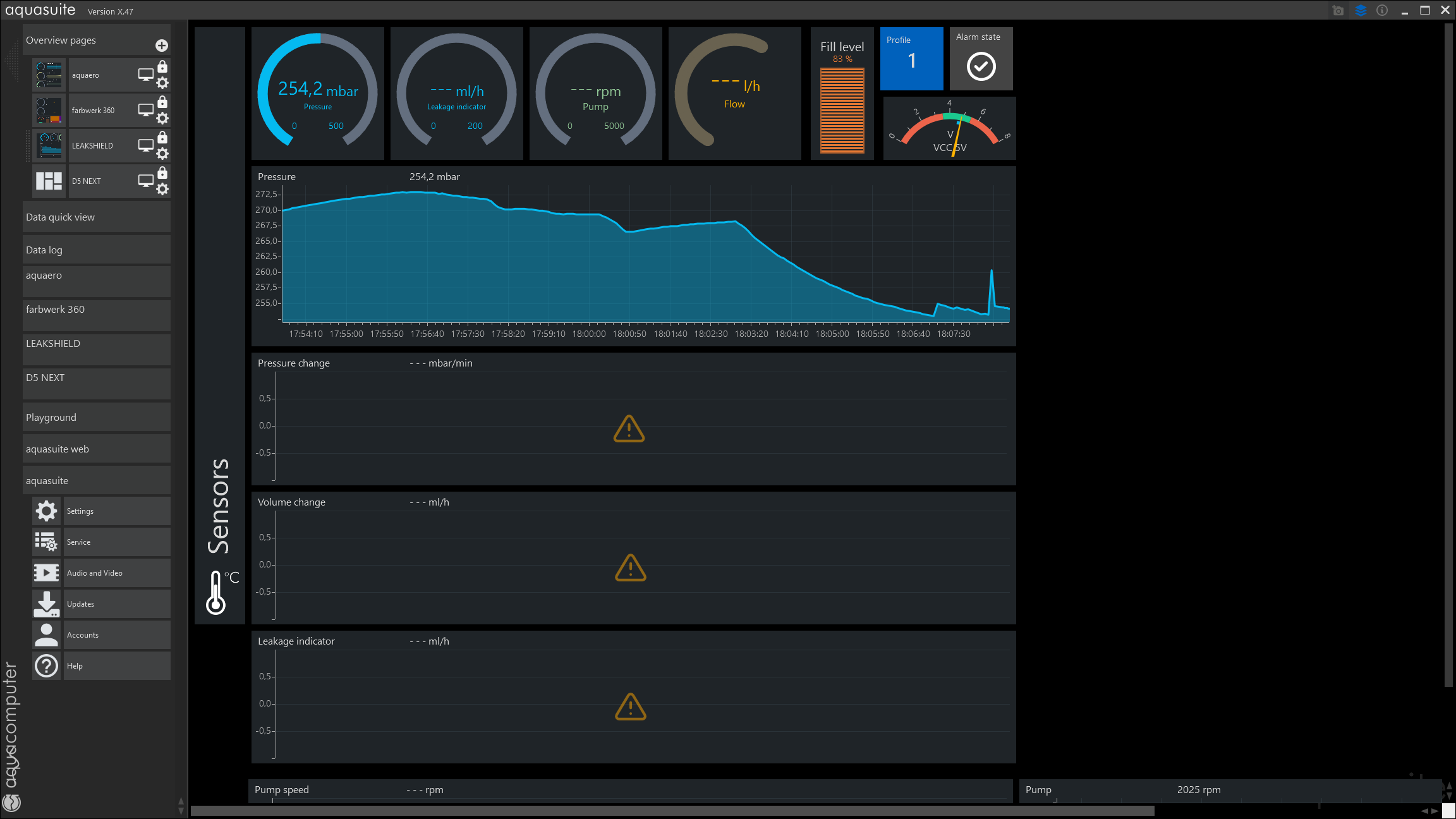

TheRealJayDee
Mittwoch, 9. Februar 2022, 07:15

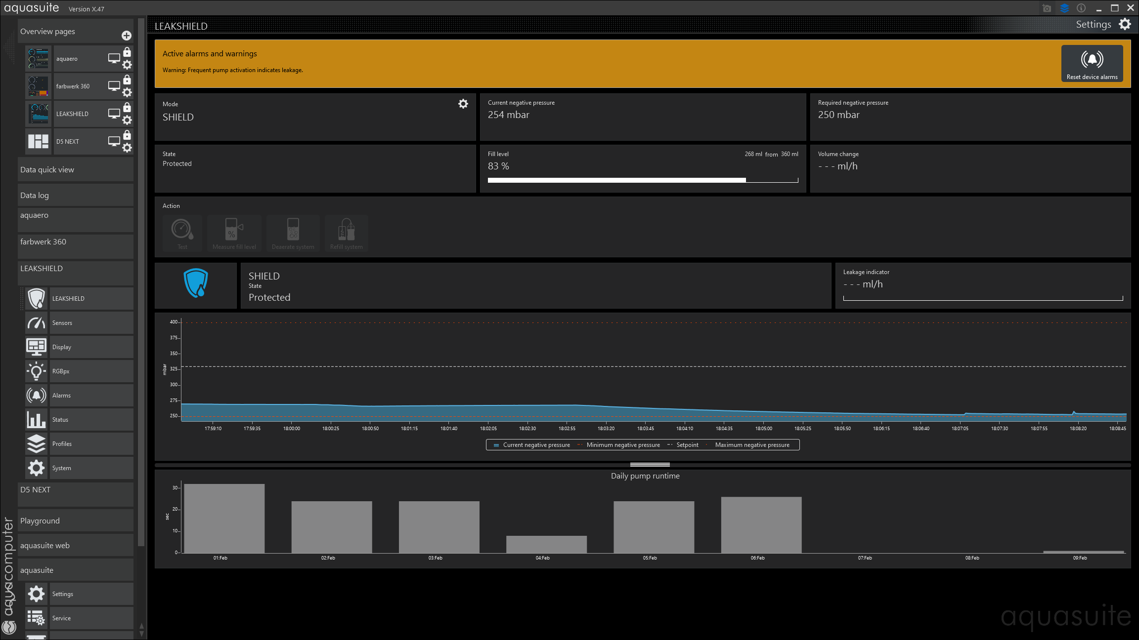

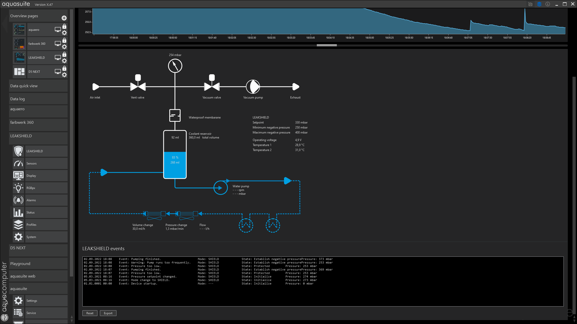

Kann mich dem nur anschließen - Sensorwerte werden in der Aquasuite und beim Auwählen einer neuen Quelle angezeigt, aber im Leakshield nicht.
Hat bei mir auch schon zu mehreren Fehlalarmen geführt weil LS der Meinung war das meine Pumpe (D5 Next an Ultitube mit Leakshield) auf Vollgas läuft obwohl die mit 2k rpm eher idle war. (Siehe screenshot - unten Links der Leakshield-Sensor, rechts der D5 Next-Sensor)
Ich kann gerne eine ganze Screenshot-Reihe anhängen wenn das hilft ;)
Wenn ich bei der Fehlersuche helfen kann einfach bescheid sagen - bin selbst Softwareentwickler und würde auch USBPcap anwerfen oder nen debug-build installieren.
»TheRealJayDee« hat folgendes Bild angehängt:
Mittwoch, 9. Februar 2022, 07:23

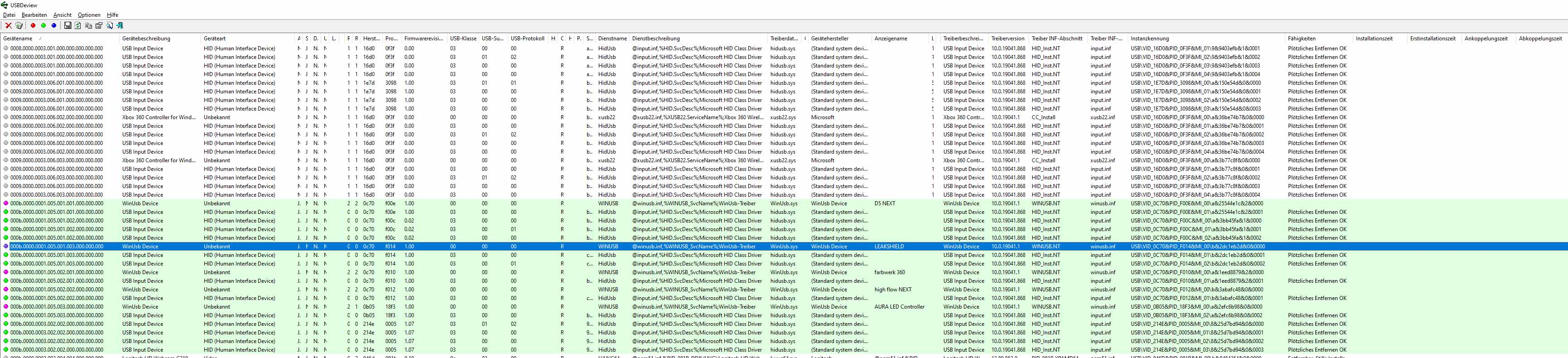

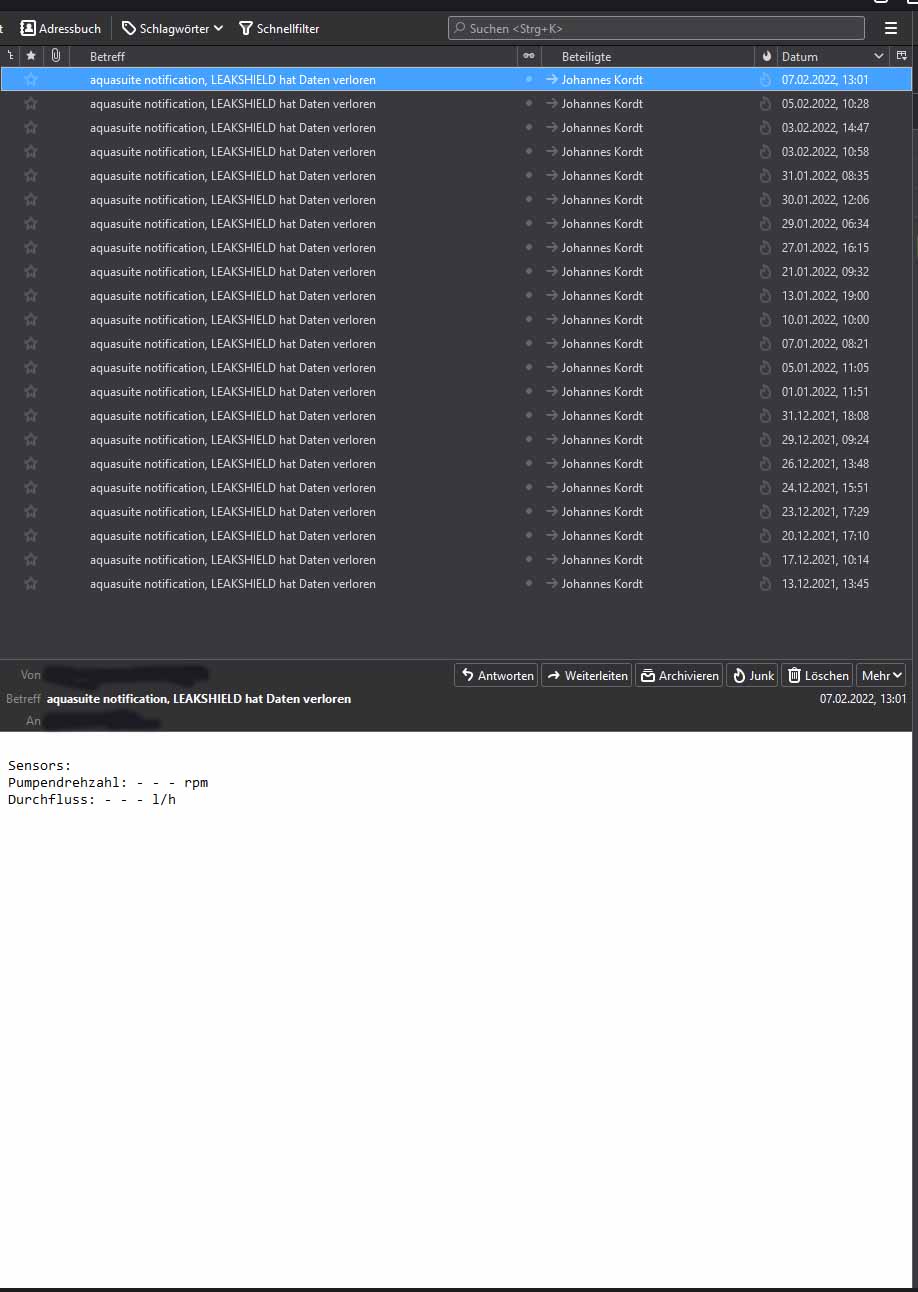

Damit keine Nachfragen dazu kommen, das LEAKSHIELD war auf beiden Boards sowohl am Board selber, am externen USB Port als auch am internen USB Hub verbunden.

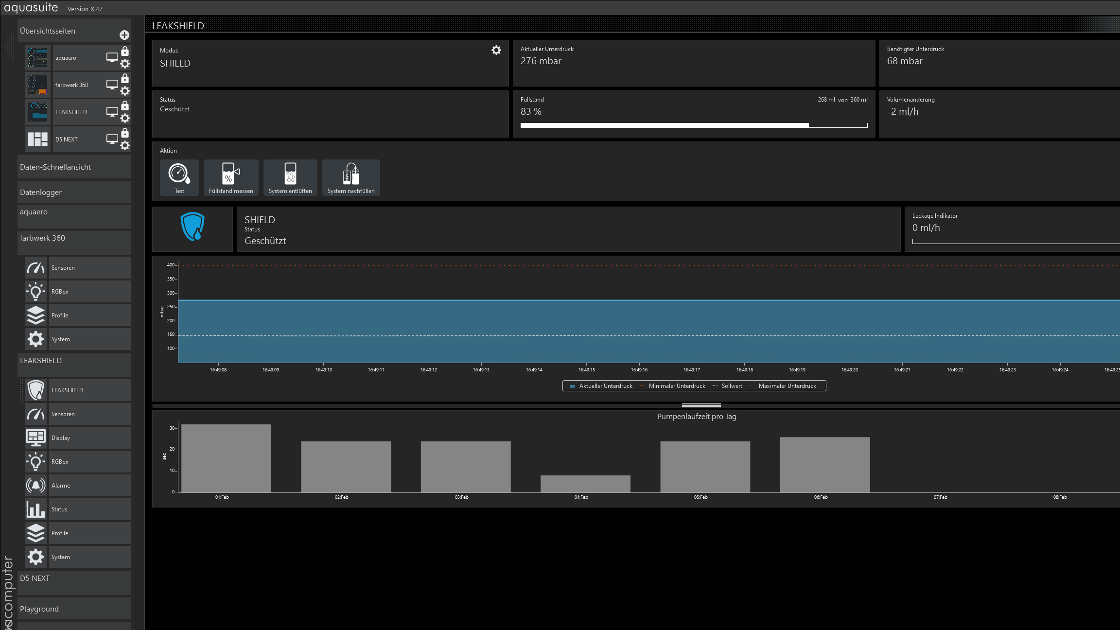

Ich habe mir eine Benachrichtigung eingerichtet und ein Foto von den Maileingängen gemacht.

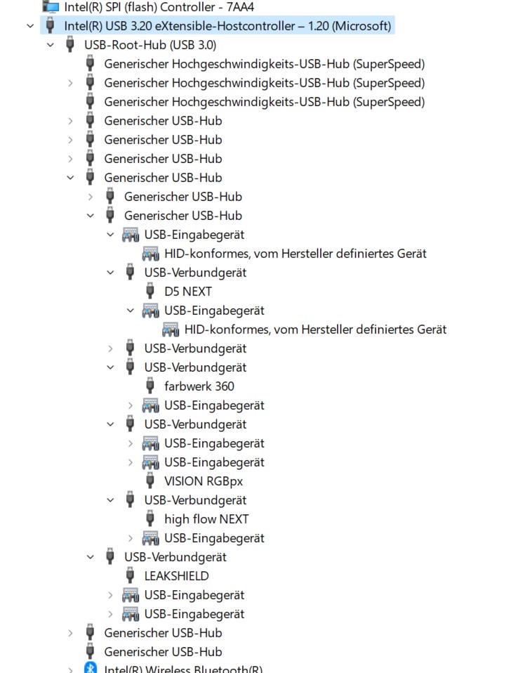

Zusätzlich habe ich ein Bild von USBView angehängt.
Nicht das sich irgendwer wundert, das Problem tritt auf seit ich das LEAKSHIELD habe, nicht erst seit ich die Benachrichtigung eingerichtet habe.
Darüber hinaus ist es unabhängig von der Windows Version, auch wenn es unter Win 11 sehr selten aufgetreten ist, da ich Win 11 sehr sporadisch und meistens kurz nutze.
Darüber hinaus betrifft das Problem nur die eingehenden Werte des LEAKSHIELD, alle anderen Softwaresensoren, die ich bei der D5 NEXT und dem high flow NEXT untereinander eingerichtet habe, die gleichen Werte die beim LEAKSHIELD verschwinden, werden weiter angezeigt.
Um sicher zu stellen, dass dies nichts mit einer Aquabusverbindung zu tun hat habe ich die D5 NEXT vom Aquabus getrennt.
Da D5 NEXT, high flow NEXT und LEAKSHIELD, laut USBView, den gleichen Treiber verwenden wundere ich mich jetzt über das Verhalten des LEAKSHIELD.
Ach ja, mein System läuft jeden Tag von ca 6:00 Uhr bis 19:30
LEAKSHIELD Mails
USBView

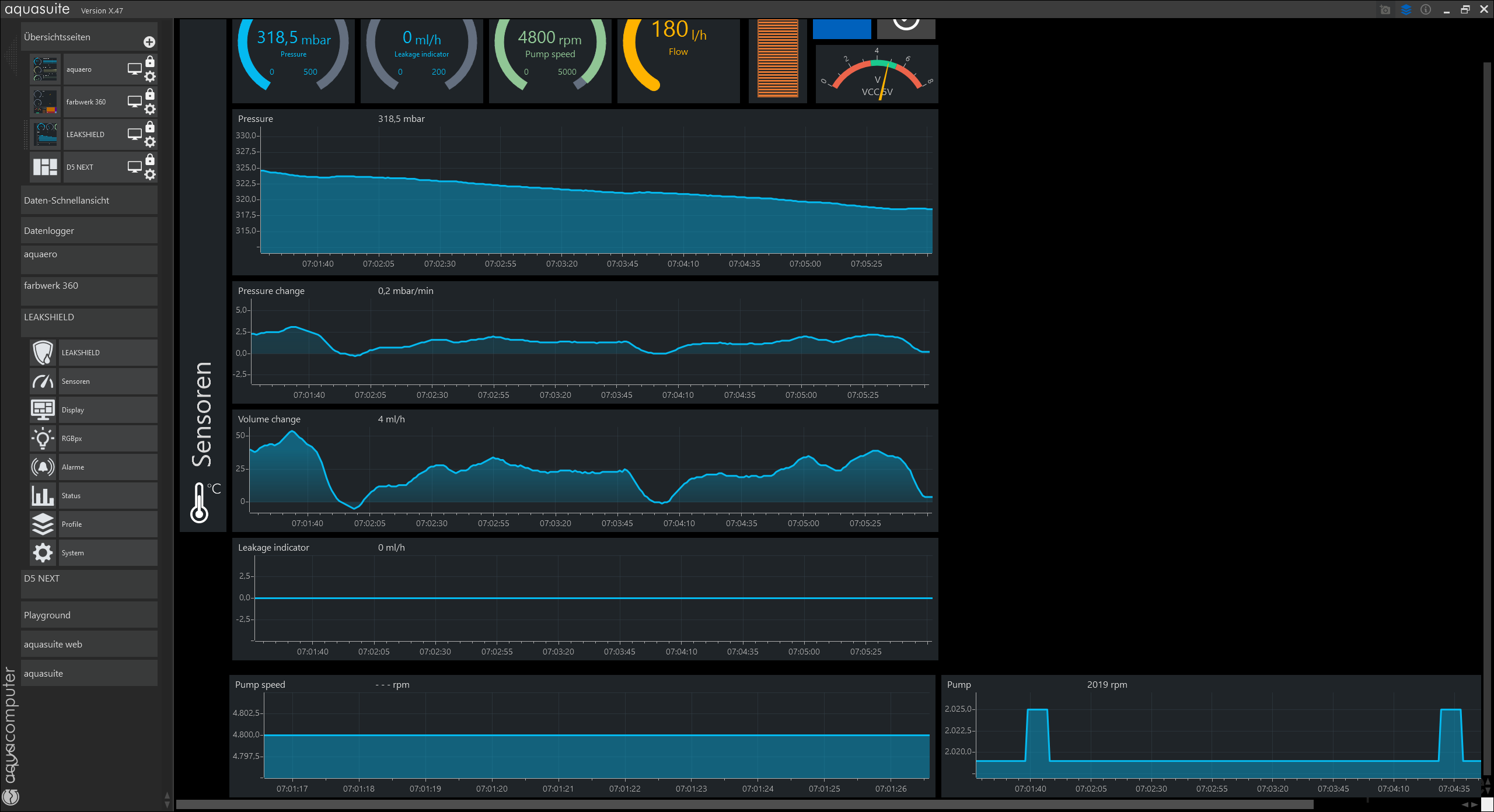

Ich bin etwas irritiert, ich dachte das Problem wäre nun wirklich bekannt, nachdem immer wieder darauf hingewiesen wird. Ich habe das selbe Problem und auch dazu bereits einen Beitrag mit Screenshots geschrieben, der unbeantwortet bliebt.
Das Phänomen ist, dass ab einer gewissen Laufzeit des Systems das Linkshield keine Daten mehr über USB bekommt, d.h. die Daten (Virtuelle Sensoren) werden im LS Display nur noch als --- angezeigt und Daten, die das LS zur korrekten Ermittlung der Druckdaten dient, stehen offenbar auch nicht mehr zur Verfügung.
In der Aquasuite sieht das dann so aus wie in diesem Screenshot:Screenshot 2022-01-26 112110.jpg
Man beachte: Die Datenquelle, die ausgewählt ist (aquaero/Temperatursensoren/Wasser Radiator Ein) wird in der Aquasuite korrekt angezeigt, siehe das Panel rechts. Im gerade gewählten Panel des Leakshields, in dem genau diese Datenquelle ausgewählt ist, wird oben aber nur --- angezeigt.
Und genau das selbe zeigt auch das Display des LS an.
Ebenso sieht man, dass alle Daten der Pumpe und des Durchflusses fehlen, obwohl sie korrekt zugeorndet sind und durch den LS Wizard auch korrekt erkannt wurden.
Nach dem Booten des Systems funktioniert es wieder eine Weile. Ich habe von anderen Usern gehört, dass ein Aus- und Einstecken des LS ebenfalls das Problem für eine Weile behebt, ich kann das nicht so einfach testen, weil das LS bei mir intern angesteckt ist.
Ein Neustart des Services hilft nicht.

Wie gesagt, bei mir ist es ein Intel z690 System. Das BIOS ist V 0811.
Ich verwende Win 11 (aktuelle Release-Version), die USB Treiber sind vom aktuellen Intel Chipset driver set. Ich hab mal Screenshots von der USB Chain und der Treiberversion gemacht:
Firmware des LS ist aktuell (1013).
Das Kabel ist das von Euch gelieferte USB 2 Sockel-Kabel ohne weitere Adapter oder Verlängerungen. Ich tausche es gerne aus, wenn ihr mir Ersatz schickt.

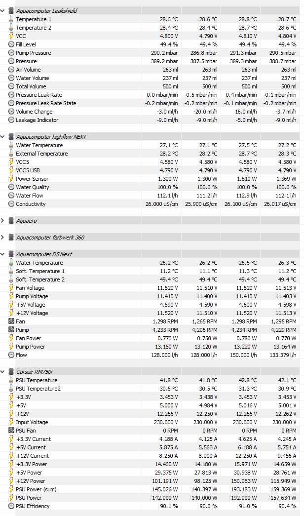

TheRealJayDee
Mittwoch, 9. Februar 2022, 19:41
Da ich gerade beim Daddeln und danach von je einem Fehlalarm bespaßt wurde hier noch eine kurze Bilderserie - vielleicht hilft's ja was.
- Da ich heute vormittag bereits keine Sensordaten hatte habe ich den Rechner zunächst herunter- und wieder hochgefahren (Windows 11 Suspend to Disk "heruntergefahren") - keine Änderung
- Herunterfahren und Netzteil aus hat zum Erfolg geführt

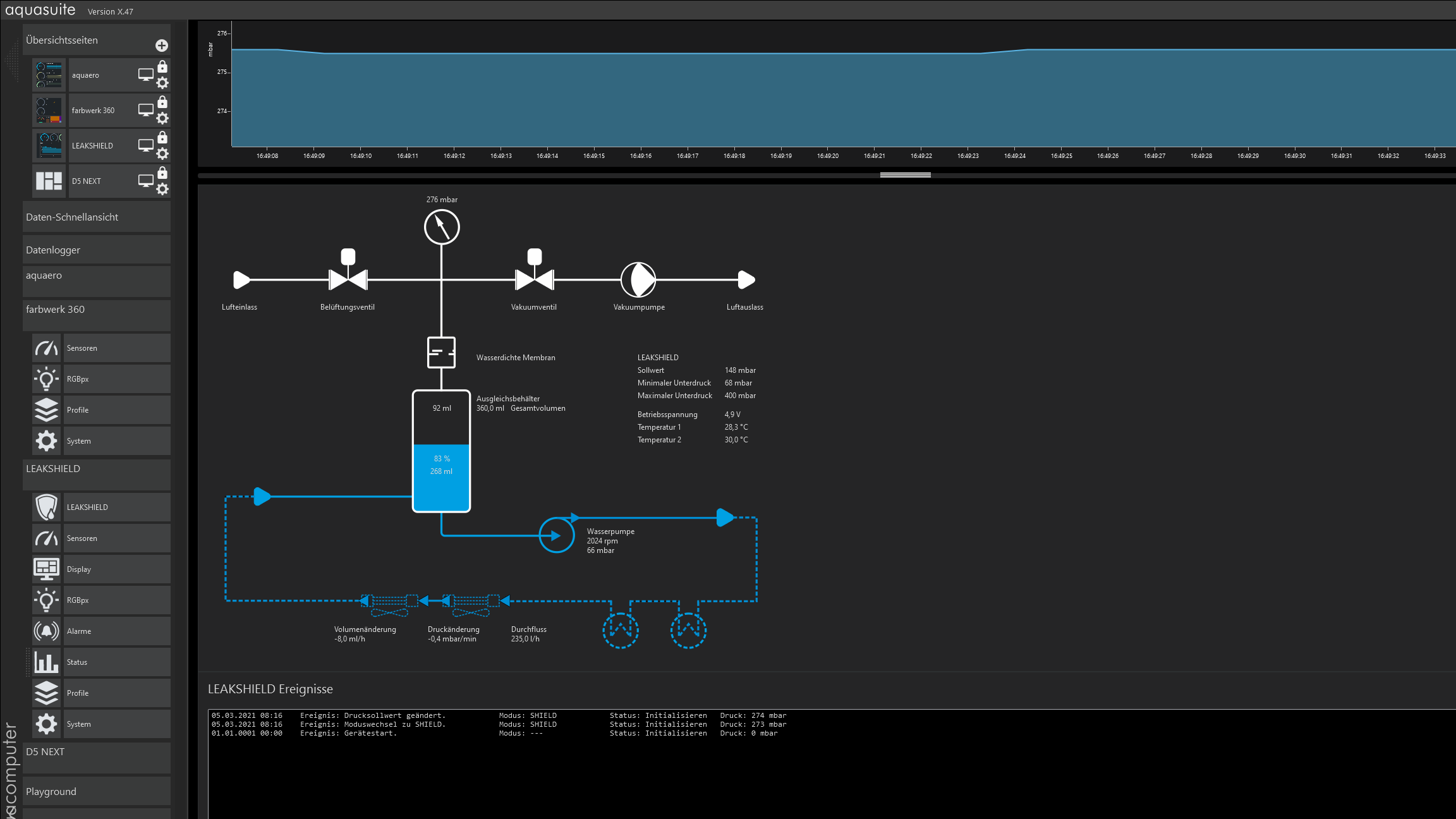

- Nach dem Reboot war alles schick- Beim Zocken dann Ausfall der Sensordaten, LS meint statt 68 mbar >250 mbar Unterdruck haben zu wollen, bekommt die aber anscheinend nicht auf die Kette (mehrfaches kurzes Pumpen)
- (Umstellung von Shield auf Monitor) -> Druck auf ~100mbar
- Nach dem Zocken wird ein Druckabfall angezeigt, Alarm und die Pumpe pumpt auf 69mbar
- Das System hatte ~250mbar von Sonntag bis gerade mit minimalen Verlusten gehalten, also denke ich nicht das ich besondere Lecks habe
- Temperaturunterschied zwischen Zocken und Idle ca. 5° (36° -> 31°)
- Die Pumpe ist fix auf 0% eingestellt (~2k rpm)
Wakü-Komponenten:- Ultitube D5 150 Pro mit LS
- Nexxos Xp³ Light
- Alphacool Eisblock Aurora Acryl GPX-N 3080 FE
- Bykski Flowmeter (Schrott, ich weiß)
- Aquaero 6 Kühlblock
- airplex radical 2/480
Edit: Kann es sein dass das wilde Rumgepumpe durch einen zusammengefallenen Schlauch verursacht wurde? Habe festgestellt das ein Schlauch hinter dem Aquaero sich beim Lecktest (der im Übrigen unspektakulär war) etwas zusammengezogen hat. Knickschutzfedern sind bestellt...
»TheRealJayDee« hat folgende Bilder angehängt:

I have attached a zip folder with detailed screenshots, as well as a dxdiag of my system, documenting how Leakshield looks before and then after it "breaks".
To mitigate the issue in the meantime I have setup static custom values ​​to essentially remove needing the data from the pump.
I don't have any other Aquacomputer devices impacted other than Leakshield, though.
I have an Asrock B550 Steel Legend ATX motherboard. Ryzen 7 3800XT, RTX 3080ti, Soundblaster AE-5 Plus, TP-Link Wifi card, and 48GB of system RAM. I also have the latest chipset drivers and bios.
Would it be possible to get like a reset button for leakshield? Like if it fails to reset it's USB connection?
