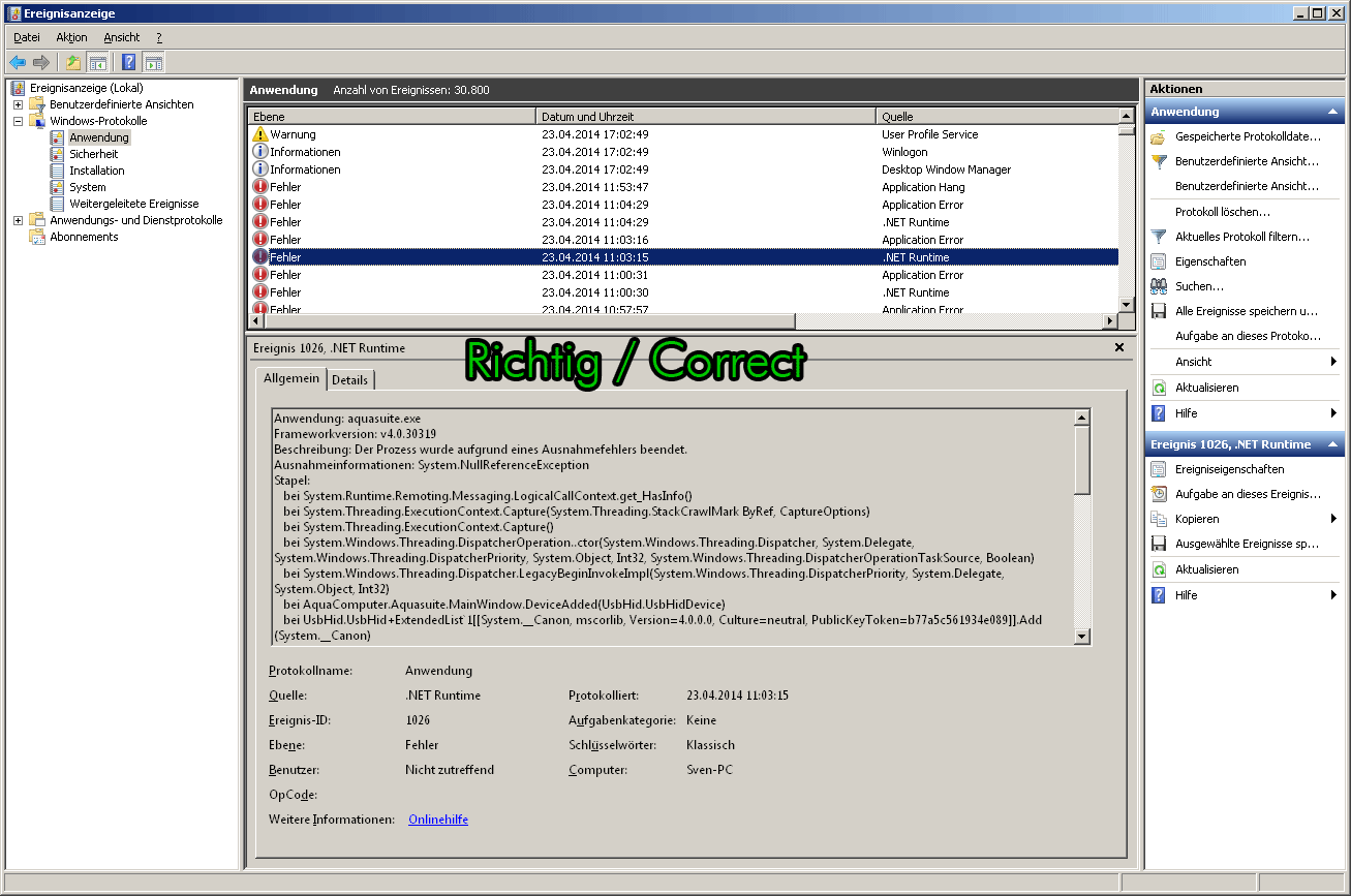

Montag, 8. Februar 2016, 12:17
To analyze these problems we need the full error message from the event viewer:
Rizlaw
Montag, 8. Februar 2016, 20:14
Shoggy,
I don't think my first reply worked, so here goes again. I wasn't sure how to get what you wanted in Event Viewer. Windows is not my primary OS. I only use it for my new Aquaero 6 XT and label printing.
If the two attached files are no help, please explain more specifically where I need to get the logs and how to save them to a file.
Thanks for your help.

Dienstag, 9. Februar 2016, 09:00
There is a problem with one of the chart elements. It is likely that an old chart element is causing the problem. Should be easy to fix with an update.
I recommend to save your overview pages to a files as backup and then do a clean installation without reimporting any old stuff to check if this will run.
