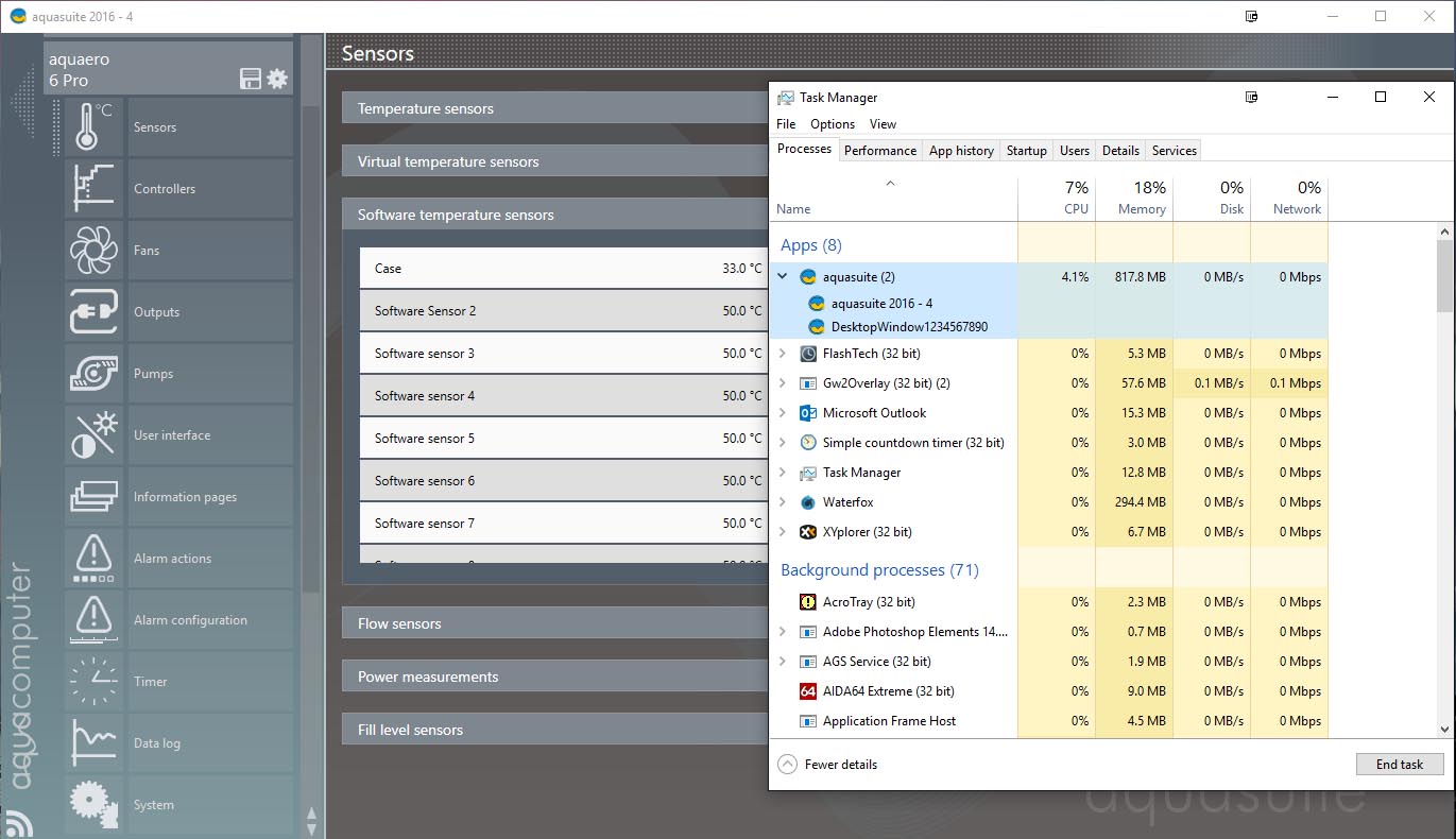

Possible memory leak in Aquacomputer Service?
Donnerstag, 14. April 2016, 13:14
Hi.
Just noticed that the Aqua computer service, slowly hogs more and more memory. After some hours its up to 192 mb, and slowly continues increasing in size. My computer was on for 2 days in a row, and then it was 3 gb.
It was the same with version 2016-2.

Donnerstag, 14. April 2016, 14:19
This is a know problem that has been also reported by some other users. Are you using any software sensors? If so, which programs do you use?

I meant the software sensor feature of the aquasuite ;)

I can confirm the memory issue as well, I'm using HWiNFO64, hopefully this will help with future aquasuite updates :thumbup:
I am using one Software Sensor...

HI i use no software sensor, i only use the aquasuite for controlling my pump. :)
Kind regards
B.
Samstag, 16. April 2016, 10:43
Try the following: go to the system tab of the aquasuite and stop the service. Download this file and extract it to the aquasuite folder to overwrite the current file. Start the service again.
It is a modified version and will very likely solve the problem. Please report back if it helps or not.

Mittwoch, 20. April 2016, 10:17
Great.
So far, so good. No apparent memomry leak now. Though i will leave the computer on for å time, to check.
Thanks for good support.

OK, has been also reported by others that the problem seems to be solved when using the modified version :)
Will be included with the next official release.
