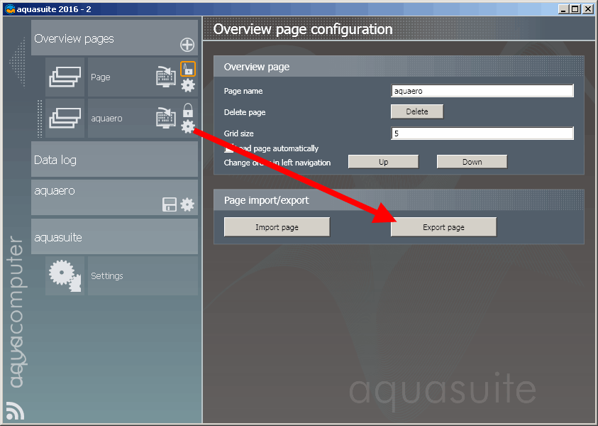

Dienstag, 9. Februar 2016, 16:34
Maybe you have designed your own overview pages. That is the reason why I recommend to save them:
If you have not changed or designed overview pages, then there is nothing to save.
With clean install I meant to uninstall the current aquasuite, also confirm the removal of the config files and install it again where you select a new installation instead of an upgrade installation.
