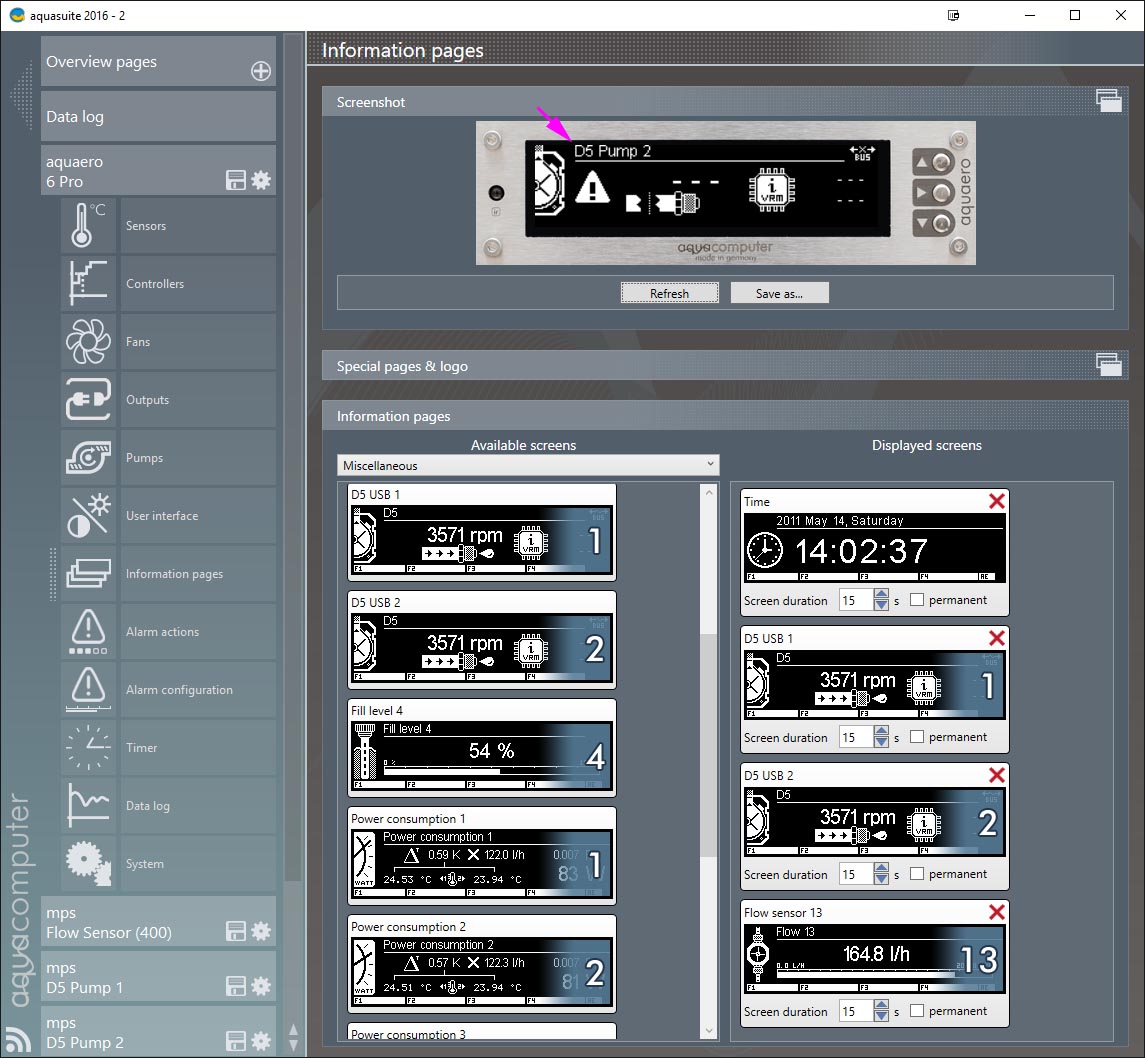

Hey guys
I was happy to see in the changlog for Aquasuite 2016 that an info page had been added for the USB D5 pumps. However I can't seem to get it to work.
I thought maybe this was because it was connected via Aquabus so I added the USB connection but I get nothing with either
Mittwoch, 10. Februar 2016, 14:20
You have to drag and drop it in the information pages tab to the right side with the displayed pages.
Jakusonfire
Mittwoch, 10. Februar 2016, 15:15
Yeah, no I've done that \. That is a screenshot from my Aquaero.
The pump is showing up under currently connected aquabus devices and has its USB tab. I have working speed signal graphs and guages in my aquasuite pages. There is just no info on the info page on the Aquaero LCD
Dieser Beitrag wurde bereits 2 mal editiert, zuletzt von »Jakusonfire« (10. Februar 2016, 15:18)
Mittwoch, 10. Februar 2016, 16:06
There is no screenshot visible in your post.
Freitag, 12. Februar 2016, 13:56
I seem to have the same results jakusonfire did with the aquaero D5/USB pump displays not updating.
2 screenshots of "screenshot" for pump1 & 2.
I confirmed that the aquaero display shows the exact same image as the "screenshot":
Screenshots showing both pump's USB & aquabus connection settings:
Both pumps showing correctly in the aquasuite display:
EDIT: included flow sensor object in aquasuite display
Dieser Beitrag wurde bereits 3 mal editiert, zuletzt von »InfoSeeker« (12. Februar 2016, 16:41)
Freitag, 12. Februar 2016, 22:04
Will be checked. There are already some other minor bugs on the list that must be fixed soon ;)
