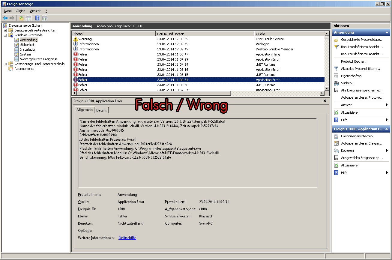

Aquasuite 216-2 crashes in Win7VM
dimanche 7 février 2016, 02:56
I have encountered a similar problem to "Infoseeker" above. In my situation I was successfully running aquasuite 214 in a 64bit Win7 VM using Virtualbox
under Ubuntu Linux 14.04LTS.
After I updated to 216-2, it initially ran well. The firmware update went without issue. I closed the program and VM and then reopened it the following day (today) and that's when the problem showed up. Version 216-2 of the Aquasuite starts and then pops up a dialogue
box indicating a problem with "signatures". The earlier version of
Aquasuite I was using worked just fine in Virtualbox (most current
version).
I know I can't go back to the earlier version of aquasuite
because of the firmware upgrade performed by 216-2. So am I totally out
of luck or is there a way to fix this in the Win7 VM?
I have attached a screen shot of the error message.
Ce message a été modifié 1 fois. Dernière modification effectuée par "Rizlaw" (7 février 2016, 04:03)
lundi 8 février 2016, 12:17
To analyze these problems we need the full error message from the event viewer:
Rizlaw
lundi 8 février 2016, 20:14
Shoggy,
I don't think my first reply worked, so here goes again. I wasn't sure how to get what you wanted in Event Viewer. Windows is not my primary OS. I only use it for my new Aquaero 6 XT and label printing.
If the two attached files are no help, please explain more specifically where I need to get the logs and how to save them to a file.
Thanks for your help.
Rizlaw a envoyé le fichier suivant :
  • Event Logs.zip (10,85 kB - téléchargé 716 fois - Dernier téléchargement : Aujourd’hui, 10:28)
Ce message a été modifié 1 fois. Dernière modification effectuée par "Rizlaw" (8 février 2016, 20:17)
mardi 9 février 2016, 09:00
There is a problem with one of the chart elements. It is likely that an old chart element is causing the problem. Should be easy to fix with an update.
I recommend to save your overview pages to a files as backup and then do a clean installation without reimporting any old stuff to check if this will run.

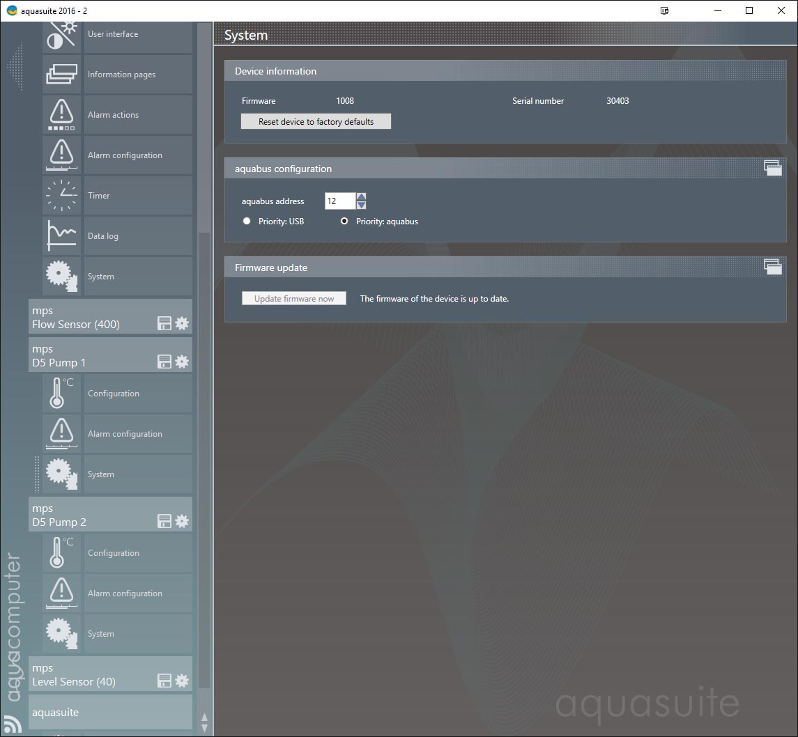

vendredi 12 février 2016, 13:56
I seem to have the same results jakusonfire did with the aquaero D5/USB pump displays not updating.
2 screenshots of "screenshot" for pump1 & 2.
I confirmed that the aquaero display shows the exact same image as the "screenshot":
Screenshots showing both pump's USB & aquabus connection settings:
Both pumps showing correctly in the aquasuite display:
EDIT: included flow sensor object in aquasuite display
Ce message a été modifié 3 fois. Dernière modification effectuée par "InfoSeeker" (12 février 2016, 16:41)
vendredi 12 février 2016, 22:04
Will be checked. There are already some other minor bugs on the list that must be fixed soon ;)
