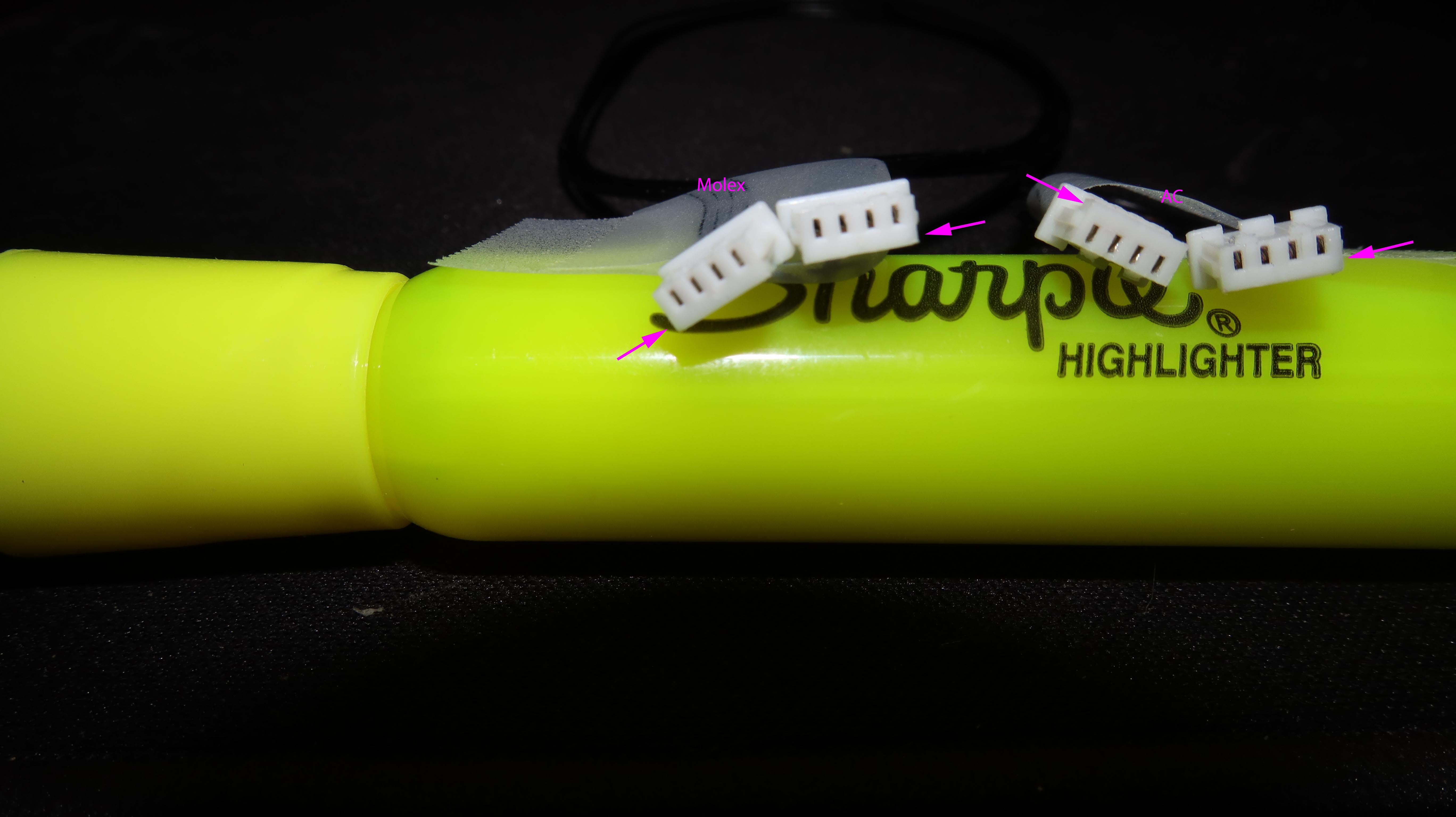

I recall that the Molex Picoblade pre-made cables have a different pinout than the RGBpx cables. The Molex pinout is (I think) reversed on one end relative to the other end while RGBpx is straight through pin to pin. There is a post somewhere on this forum about it. I downloaded a picture that the OP posted showing the difference but looking at it now I find it confusing but think it shows that the Molex pinout is inverted. I have attached the picture and an assembly detail from Molex that shows how their Picoblade cables are pinned. When yours arrives I would check it against an RGBpx cable with a continuity checker. The Molex document shows the inverted pinout which I circled in Red. It also shows the part numbers for the Molex Picoblade cables of various lengths. If the pinout is inverted verses RGBpx you would have to de-pin one end then re-pin it with the RGBpx pin out. I think Molex makes a pin extractor for Picoblade but I could not find it on their site.
I always have trouble trying to insert a picture into a post on this forum. I select the file, upload, it, then select Add to Post. Sometimes the picture will appear in the post but most times it just appears as a link. I have never been able to figure out why.
molex_orientation.pdf
