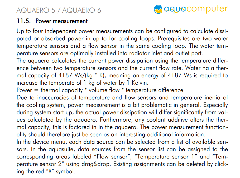

Do you need an Aquacomputer temp sensor to get "power currently being dissipated"?
Ce message a été modifié 1 fois. Dernière modification effectuée par "SgtSixpack" (4 septembre 2020, 13:51)
k2viper
vendredi 4 septembre 2020, 14:24
SgtSixpack
Yes, High flow NEXT has a built-in water temp sensor.
It also has a virtual "Power" sensor, that supposedly works the same way as aquaero's Power measurement: having two water temp sensors (installed in particular points), and a flow rate measurement, makes possible to calculate watercooling loop's thermal power taken. It seems like High flow NEXT has 2-pin (10k probe) sensor connector, so any 10k water temp sensor can be used as second water temp sensor needed for Power taken calculation. No, not only Aquacomputer one, you can find another 10k Ohm water probe.
Though Power measurement limits points where thermal sensors should be installed.

For the power dissipation calculation must the 2nd temperature sensor be connected to the port on the high flow next, or are there Software.Sensors available?
Ce message a été modifié 1 fois. Dernière modification effectuée par "InfoSeeker" (8 septembre 2020, 14:11)
mardi 8 septembre 2020, 14:46
There are software sensors available.
The high flow NEXT also integrates a smart calibration fuction. This will allow you an automatic calibration of the two sensors against each other when the system is shut down for a given time. This function is a great improvement at the accurarcy but will only be available for the connected sensor at the high flow NEXT as values must be available also in stand-by of the system.
