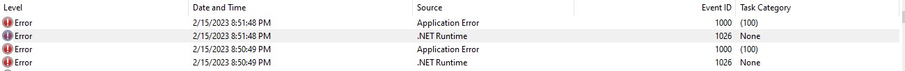

I just tried this and can confirm that AQS crashed when I did exactly what you did. I also tried clicking OK instead of Cancel. It did change to a bar graph but then AQS crashed. I did this 2 times and I also see entries in the Event Viewer. I see 2 entries - Application Error Event ID 1000 but also .NET Runtime - Event ID 1026. The .NET runtime error may indicate what the problem is. I don't know why Aquacomputer has not responded to your posts. There are several bug report posts in this thread that they have not responded to yet. Hopefully they will soon.
AQS Crash Event ID 1026.txt
AQS Crash Event ID 1000.txt

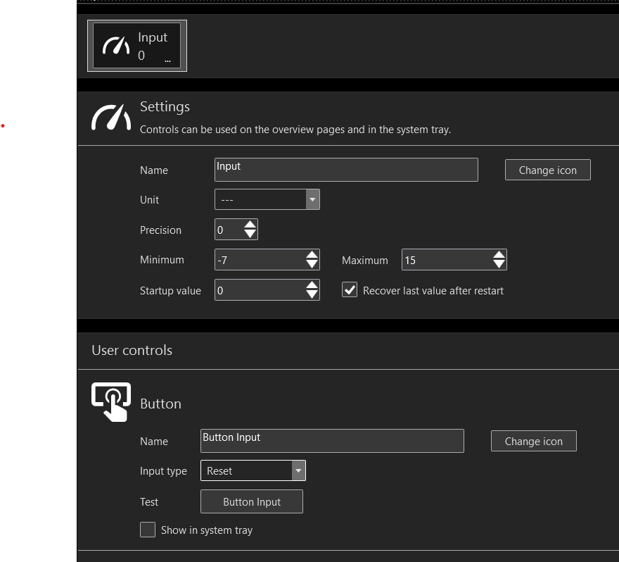

Service crashes after click Reset input button
mercredi 8 mars 2023, 23:53
Hello.
I used QUADRO w/o any issues until last update. I have an input, which type doesn't matter, with a button with reset action. Now when I click this button it leads to service crash. Any other button actions (absolute/relative) work fine.
Code source
1
2
3
4
5
6
7
8
9
10
11
12
