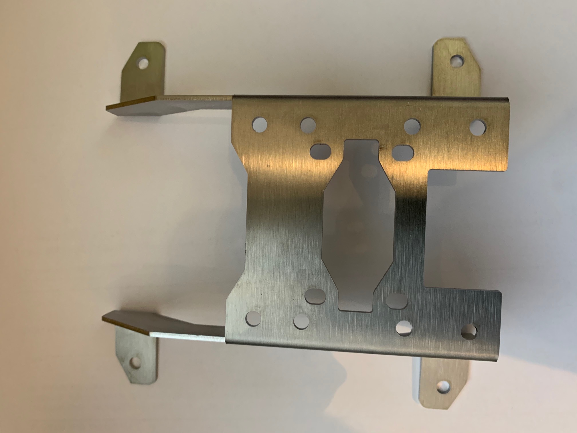

Trying to mount my D5 Next to my PC. I bought the 120mm fan mounting adapter (picture attached). The D5 Next and Ultitube came with a mounting bracket (the black L-shaped one) (picture attached).
None of the holes in the black bracket seem to line up in any way or orientation with the fan mounting adapter.

The problem is that you are using the wrong mounting bracket at the fan side.
You need this one instead for the ULTITUBE: https://shop.aquacomputer.de/product_inf…855&language=en
vendredi 17 juillet 2020, 19:05
You have picked the wrong mounting bracket. Yours is for the ULTITOP but you need the one for the ULTITUBE.
