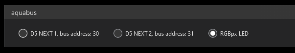

I have purchased an Aquacomputer ULTITUBE D5 100 PRO reservoir with D5 NEXT pump (from Aquatuning.de). After I assembled the watercooling system, everything worked fine except for the RGB ring that came together with the ULTITUBE. It just didn't lit. I switched the D5 NEXT port to the RGBpx mode and connected the cable to the IN port; tried restarting and powering off the pump completely – nothing helped.
From this thread RGBpx wiring Diagram I understand there should be 5V between the red and the black wires, but there is nothing. The only voltage I can see is ~3.3V between the green and the black cables (similar to reported in this thread D5 Next -> kryographics RTX2080TI: RGBpx geht nicht?) which should not be there as far as I understand; and this voltage disappears upon switching the mode from RGBpx to Pump 1/2, so something is happening but not the right thing, apparently.

maybe it's the same setting discussed in this post?
[solved] D5 NEXT: RGBpx output not functionnal
Anddre
dimanche 11 juillet 2021, 22:42
Unfortunately not
