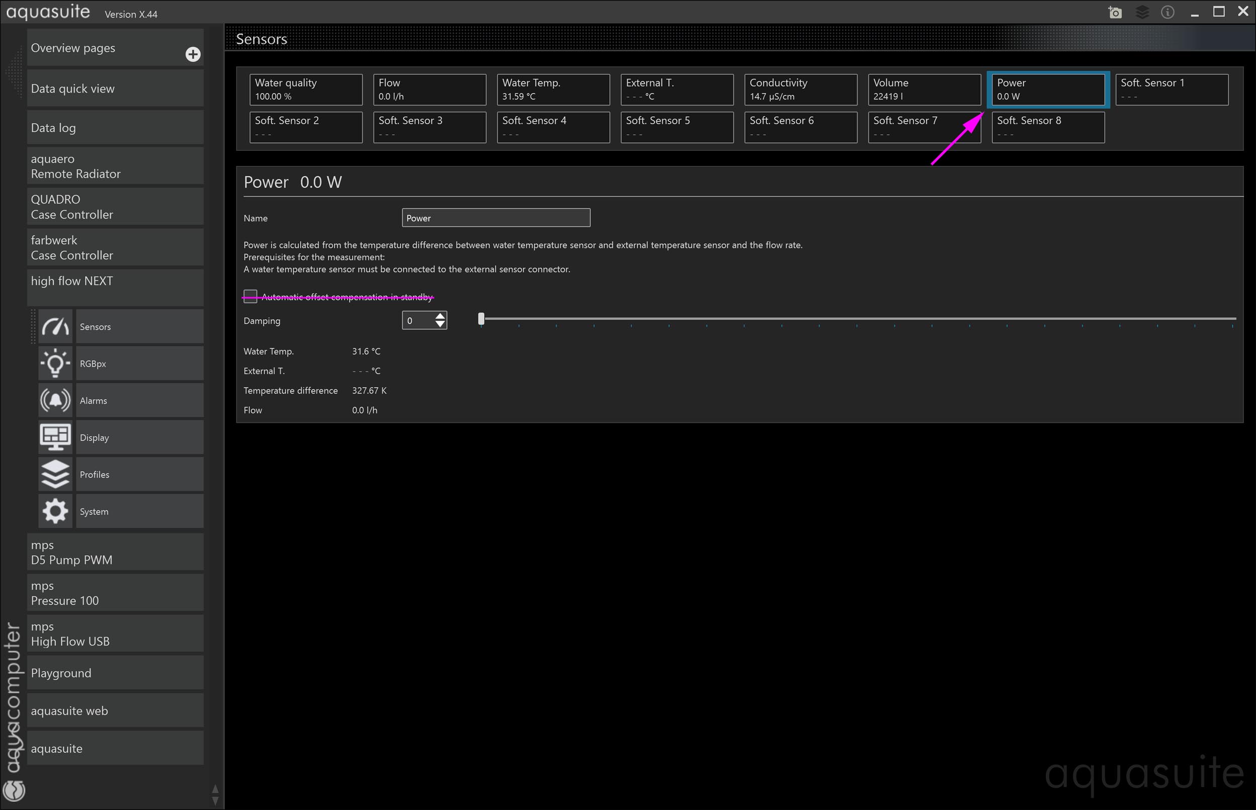

I did not find a part number 50367, but absolute accuracy is not as important as both temperature sensors having the same offset. The High Flow NEXT temperature sensor is fine, if not great.
As for power dissipation across a radiator set, the High Flow NEXT has a builtin function for that (power.jpg), but don't use the 'Automatic offset compensation in standby'.
The only requirement is that the 2nd sensor (one of THESE) be connected to the external temp input on the Flow NEXT.

nice about the integrated power calcualtion :p
basically aquasuite does automatically what the virtual sensor does.
Apparently, you need to have the Next at one end of the rads, and the second sensor at the other end, and that addditional sensor has to be connected directly to the Next, not to the Quadro.
They are the same sensors anyway, so you can plug one that you bought. they are all 10kohm NTC thermistors.
The quantity of water is irrelevant. the only thing needed is to know how much water passes every second. The temperature delta allows to calculate how much energy has been taken out of the water to reduce its temperature. (that's the reading in W).
You can have 500ml, 2 liters, doesn't matter.

one of the two has the same connector as all those on the market. the one not in stock has the picoblade connector required for the high flow next.
for the room temperature obviously you'll need another sensor going to the quadro, but you should receive one in the package :)
you are not stuck using sensors only for one function. You can use the inline sensors for power dissipation, and also to calculate delta T for fan control. But everything will be easier when you'll be in front of Aquasuite, clicking away to see all it can do.
In the Playground, you create virtual sensors from real sensors, with various operations.
"NEXT temp sensor" - "ambient temp" = "dT temperature"
in the Quadro sensor page, you have empty software sensors. You use one of those slots to add the sensor you just created, and then the dT temperature is available on the Quadro to create fan curves.
