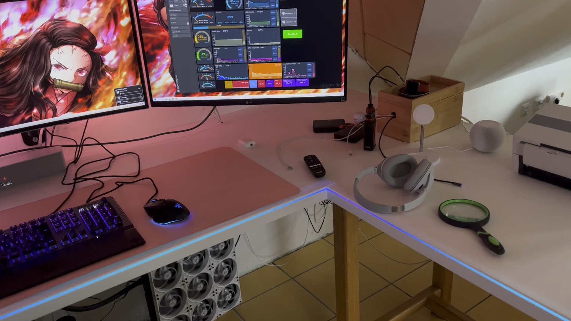

mein Schreibtisch hat einen ARGB Strip in der Sichtkante, der aktuell 208(ca 3,20m) Led enthält. Mein Mainboard kann die alle befeuern bei 18% Helligkeit. Will das aber so nicht lassen. Hab den Quadro mal dran gehangen und der verwendet wie zu erwarten, die ersten 90.
Dazu folgenden Fragen:
Ist es möglich die 3 Kanäle so zu synchroniseren, dass
1. alle den gleichen Effekt zur gleichen Zeit an der gleichen LED anzeigen?
2. der Laser erst durch Kanal 1, dann 2, dann 3 läuft?
Bei 1. teile ich den LED-Strip in gleich groß Teile.
bei 2. teile ich ihn nach Kantenlänge.
Falls beiden nicht geht, Dann lass ich es wie es ist. :)

If you are referring to the 4 RGBpx ports on the Farbwerk360, I think the answer to your first question is YES, if multiple ports are assigned to duplicates of the same RGB effect, they should all start at the same time and run together. I am not sure if they will drift apart over time. All starting at the same time is not really "sync" in that if a channel starts to drift for whatever reason, there is no sync pulse or time code that it would slew to to correct itself.
Aquacomputer mentioned adding the ability to sync RGBpx ports in a future release of Aquasuite several months ago but I have not heard any more about this since that one post. I don't know if that means you could sync RGBpx ports across devices (like syncing the ports in an Octo to the port in a Quadro). I am hoping that they can at least add sync to the Farbwerk 360 so you could sync 2 of them together. The device has an aquabus port on it that the manual says is "Reserved for Future Use". If that port is functional, maybe they could use it to send a sync pulse or some sort of timing word over the aquabus from the "master" Farbwerk360 to a "slave" Farkwerk360. The aquabus does not have enough bandwidth to send actual RGB data, but maybe it could at least be used to sync 2 Farbwerks together.
Regarding the Laser effect going from port to port to port, I don't think that is possible.
Also, since you have 208 LEDs, I would consider dividing that into 4 channels of 52 LEDs each. 208 does not divide by 3 evenly so you would end up with 2 channels with 69 LEDs each and 1 channel with 70 LEDs. That will probably throw off the timing of that channel.

Mittwoch, 11. Januar 2023, 10:46
Ja ich meinte den Farbwerk 360, hab doch tatsächlich vergessen es zu erwähnen.
Wenn ich das soweit alles richtig verstehe, wäre das aufteilen in gleich große Teile, die kleiner als 90 LEDs sind und eine externe Stromversorgung so das alle auf dem gleichen Kanal liegen die einzige Möglichkeit das synchron laufen zu lassen. Asynchron würde das ganze Bild zerstören. Ich denke da bleibt nur einen zu bestellen und mit Teststreifen auszuprobieren.
Bild angehangen zum besseren Verständnis, WAKÜ ist noch nicht fertig montiert, das wird noch hübscher.
»ticaki« hat folgende Datei angehängt:
Dieser Beitrag wurde bereits 1 mal editiert, zuletzt von »ticaki« (11. Januar 2023, 10:53)
