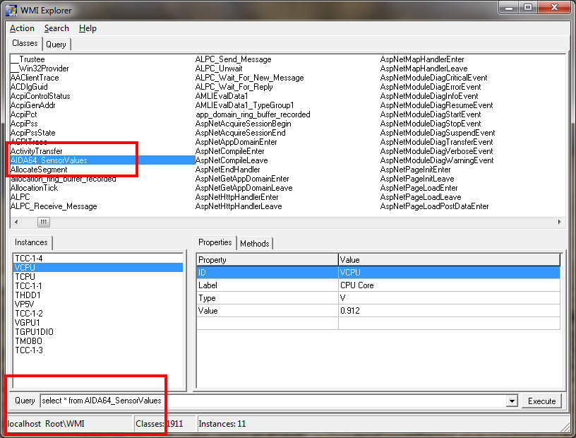

Mittwoch, 25. Juli 2012, 13:49
you can check the Sensor export from adida with ths tool:
WMI Explorer 1.12 from http://www.ks-soft.net/
in the namespace Root\WMI we search the aida sensor values.

cc01
Mittwoch, 25. Juli 2012, 14:23
Thanks, I've checked everything and still get the same error when I try to "select datasource". Anything else I should be looking for?

cc01
Donnerstag, 26. Juli 2012, 05:19
I've managed to get the software sensors working now. I simply shut down AIDA64 completely, including Windows startup, enabled and configured the sensors in Aquasuite, then restarted AIDA64. All is working well. :)
