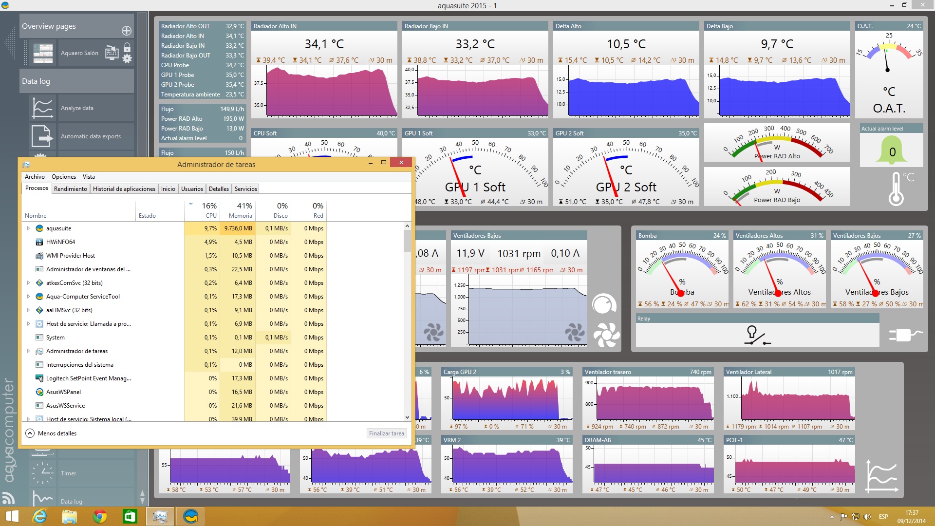

I've found a possible memory leak in aquasuite...
After some time playing (AC Unity) I closed the game and wanted to see the temps with my "very quiet profile". Also opened the task manager... and I found that.
Aquasuite was opened before opening the game. And before I closed it, memory leak reached more than 10gb... it doesn't seem to reach a final point, just continues eating more gb...
Windows 8.1 totally updated.

Mittwoch, 10. Dezember 2014, 07:47
send us your exported overview page and your aquasuite data folder "C:\ProgramData\aquasuite-data" as a zip file to info@aqua-computer.de.
Here we dont have any memory issues after several hours of runtime.
josetortola
Donnerstag, 11. Dezember 2014, 22:20
Done.
By the way, since I've restarted the program after the memory leak, it has been running with zero problems.
