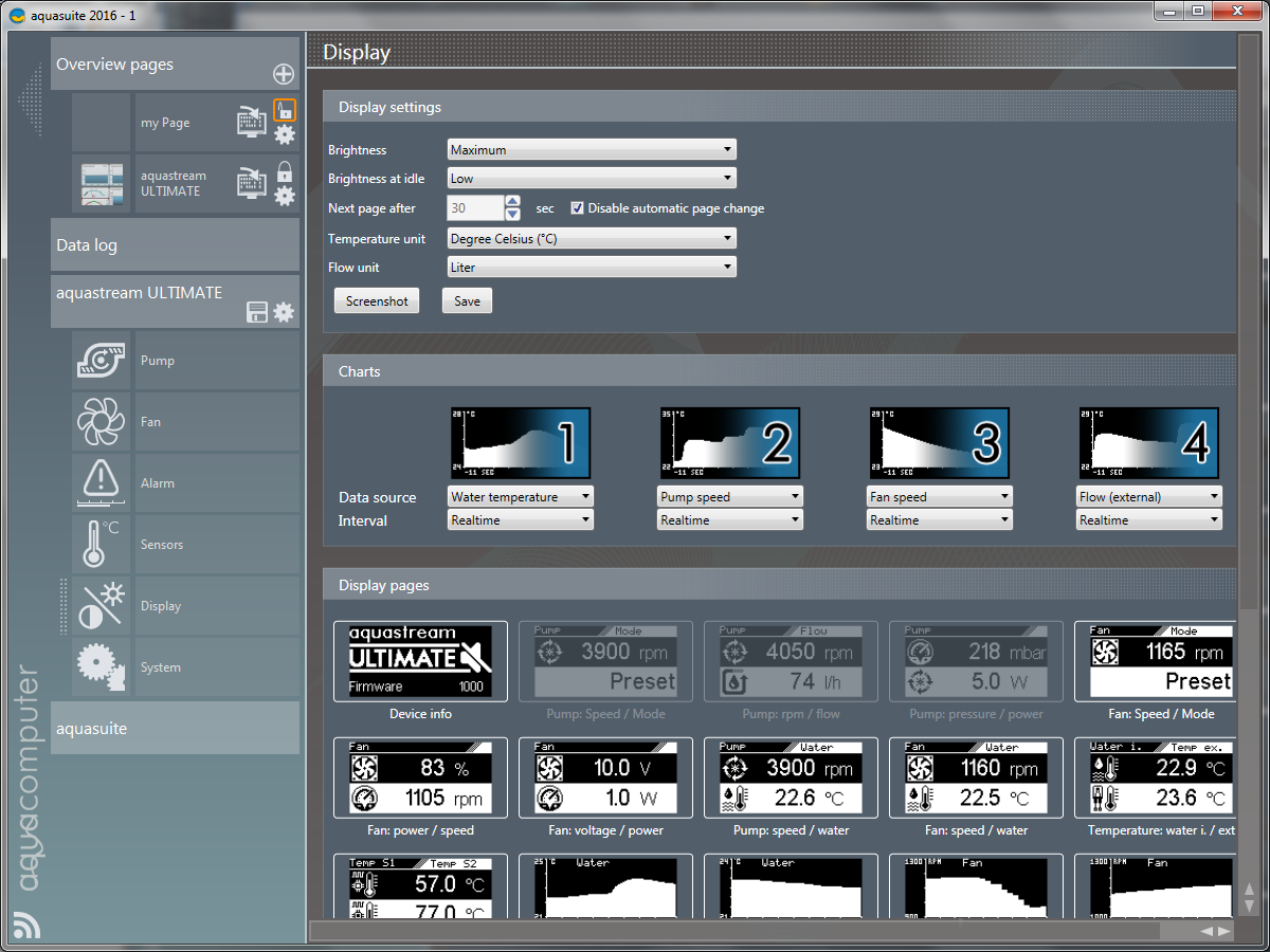

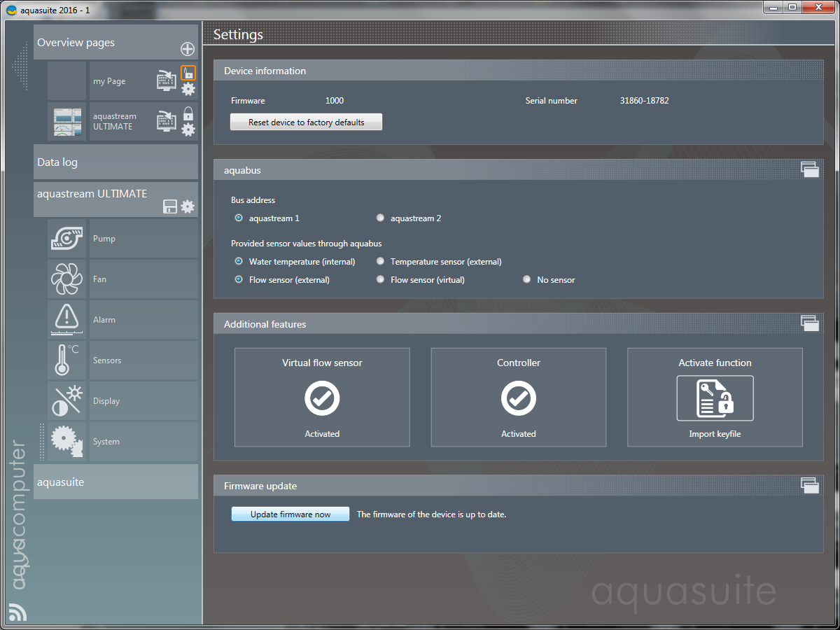

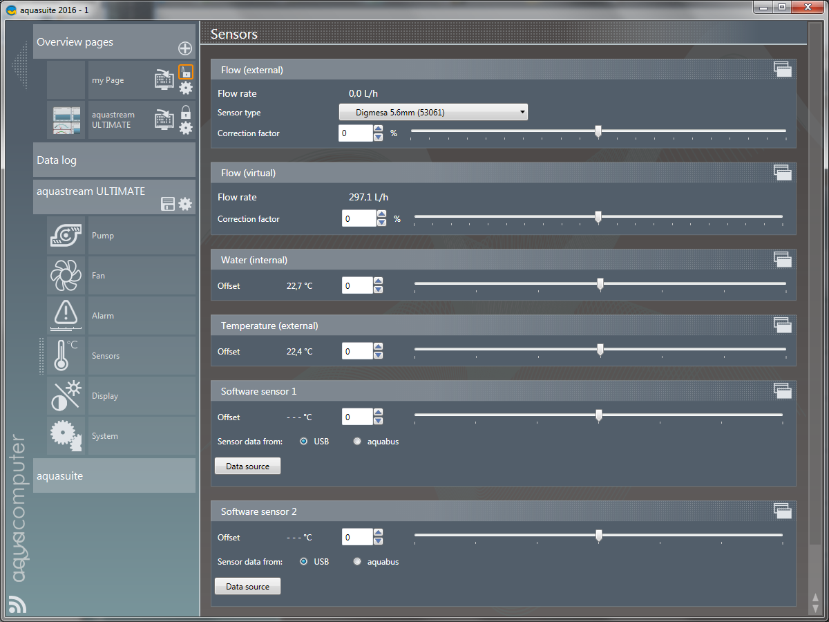

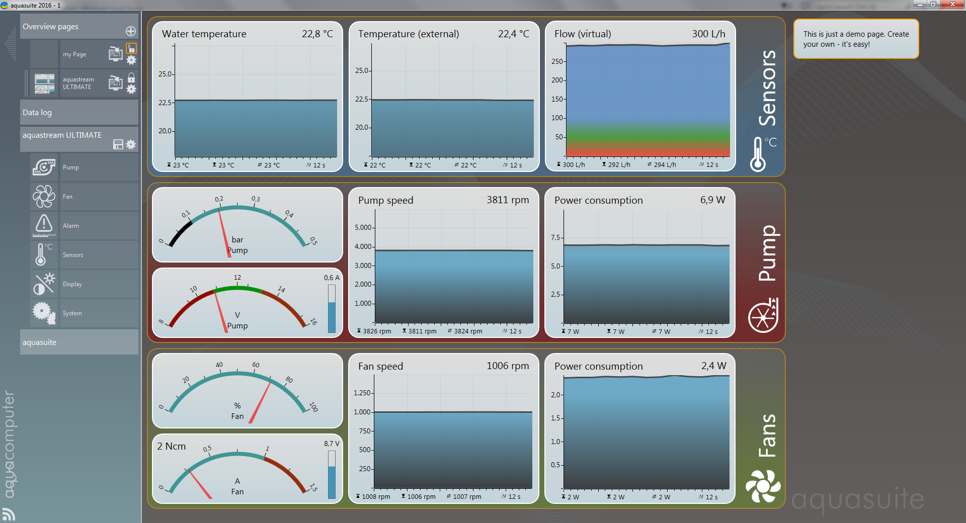

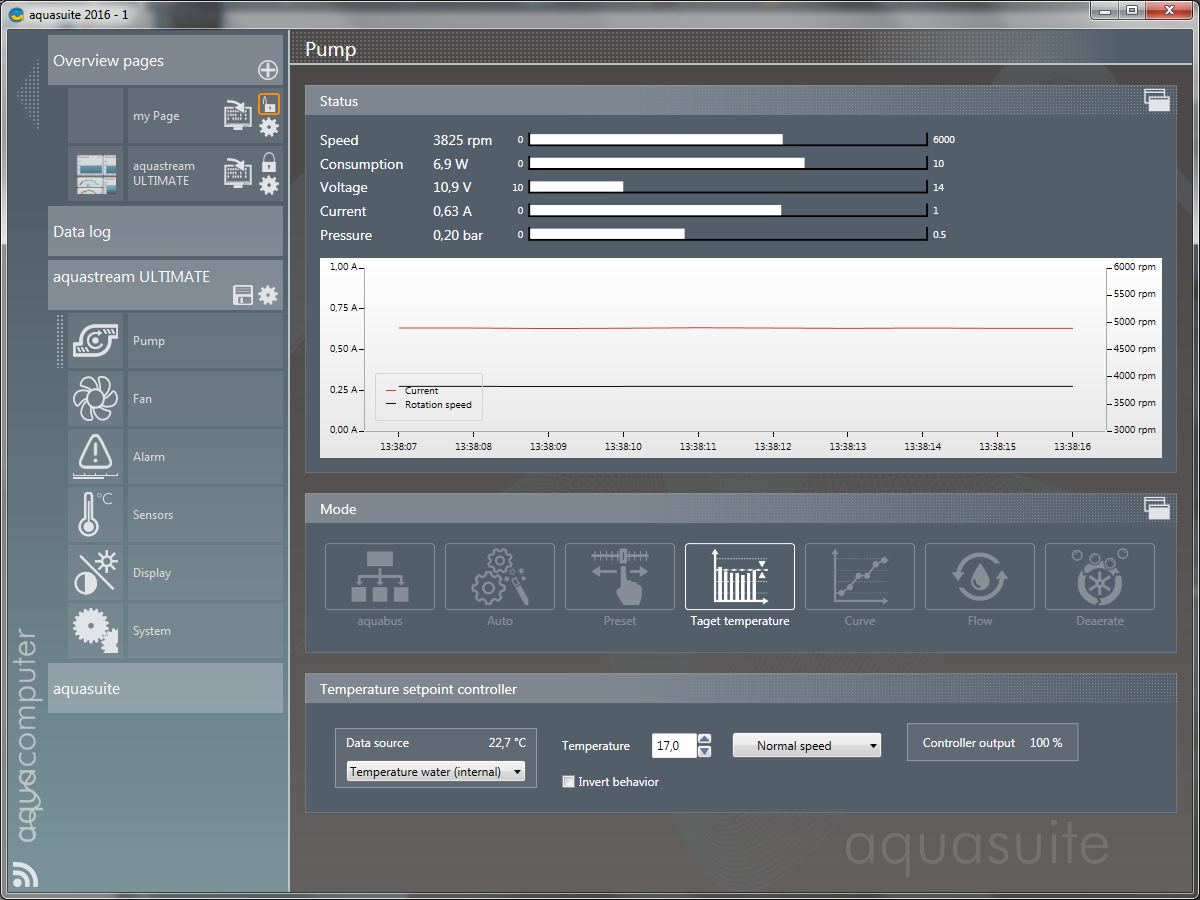

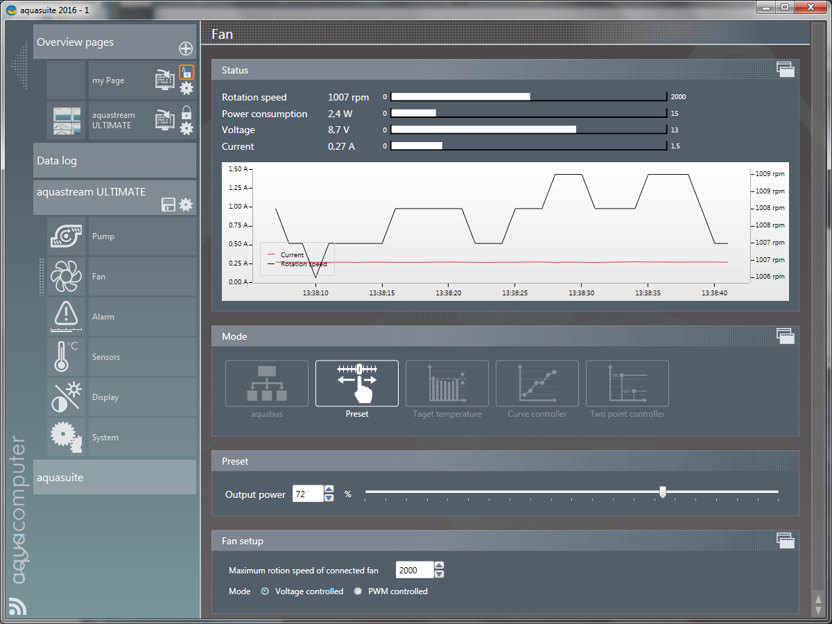

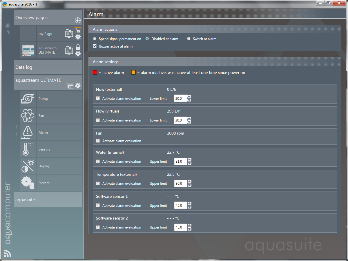

Screenshots of the aquasuite software:

An extended alarm management with acoustic and optical alarms is integrated in the aquastream ULTIMATE. It also provides two options to shut down a PC in case of an emergency: The first is the generation of a virtual fan tacho signal. The signal can be disabled in case of an alarm and the connected mother board can shut down the PC.
