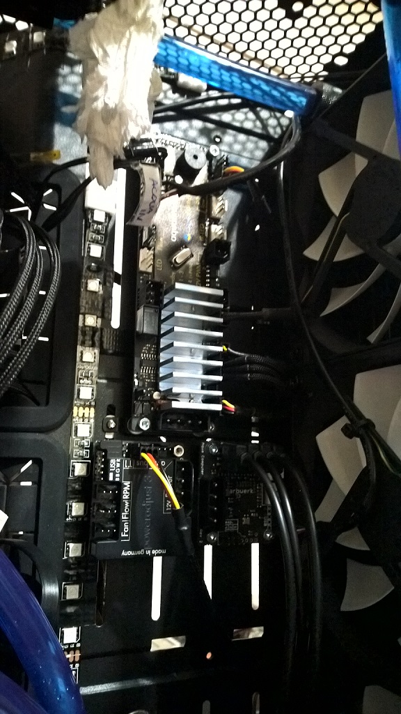

Aquacomputer Led strips + Farbwerk
I had some trouble making the led strips working correctly. The fix was very simple.
I've used Aquacomputer RGB cables with the clamp (no IP65 version) and after installing all of them the only color I was able to show was blue, no matter what I was choosing in the software.
Applying force (pushing) on the clamp made the rgb led working correctly. The issue must be on the clamp for sure.
Infact the problem was I've pushed too deep the pcb strip into the clamp, and it wasn't making good contact.
The fix was very easy: just pull a little bit the strip back (outside) from the cable clamp. It's a matter of less than 1mm. All 4 strips are working correctly now!
Hope it will be useful to other users having issues with led strips and cable :)
I had to use a strong adhesive tape for fixing the strips because the inner surface of my case isn't polished but a bit porous, so the glue of the AC RGB led strips wasn't attaching to the surface for long time.
I placed some strips of adhesive tape in every the gap where there's no led but the resistors, perpendicular to the strip. The tape I've used it's very strong and it should last.
For fixing the cable clamp I've used adhesive pads, which are very inexpensive, they can sustain till 2kg of weight, attach to porous material very good (applying a good force initially to spread the pad) and they leave no traces. Plus they are invisible if you cut it correctly, so the ahestetic of your build wouldn't suffer.
I'd like to share a costructive criticism too: please optimize a bit further the UI of the Aquasuite software, I find it a bit too laggy and clunky even on a fullHD monitor.
And finally here it is how I placed the AC product in the case. They have a dedicated space near the fans to stay cool ;)
Thanks in advance for your help :)

I had the same experience with Farbwerk and the Aquacomputer wire. The solution I did was to take out the 4 metal fins and solder the RGB on the wire itself. Those clips does not hold well.
