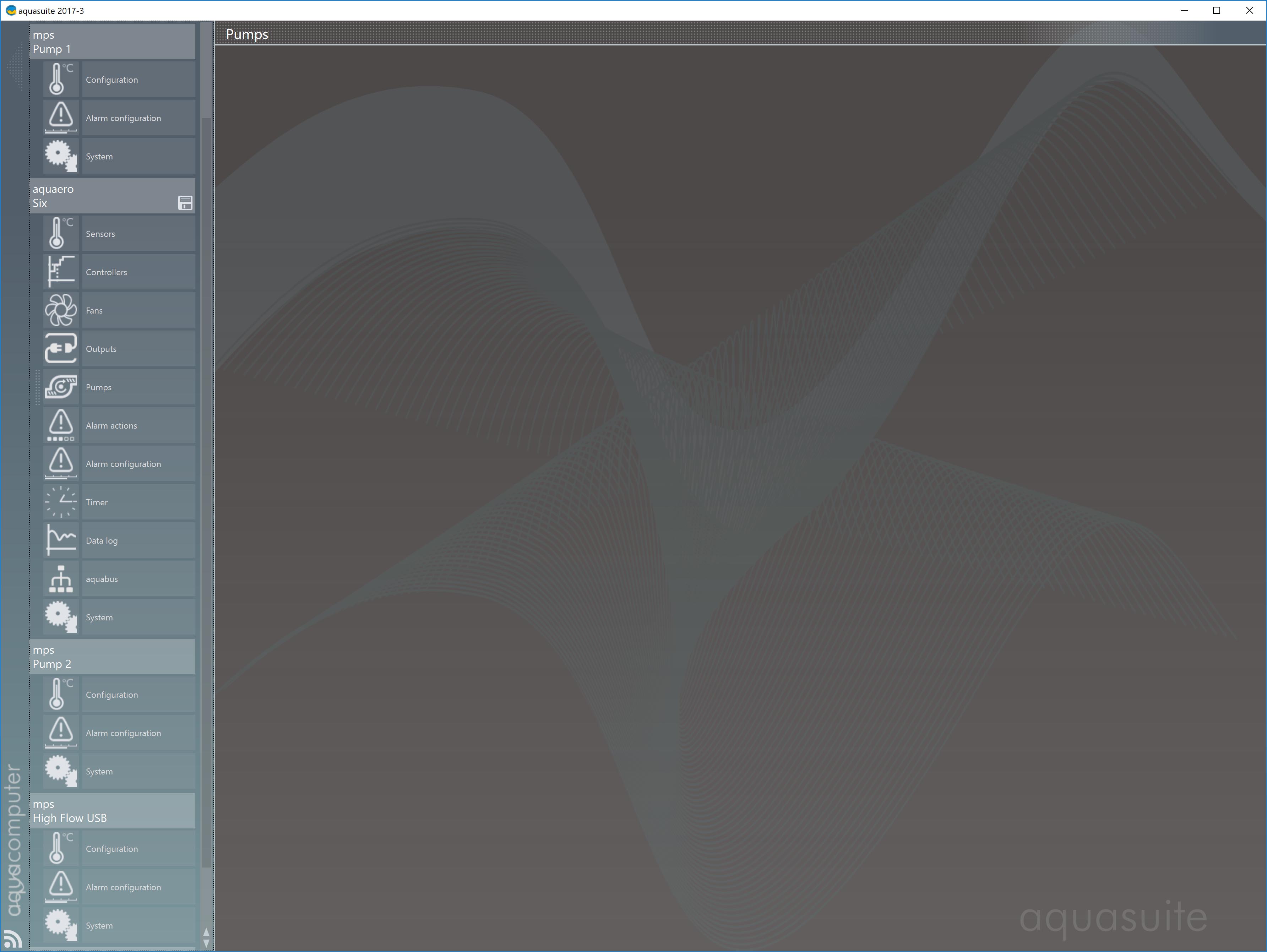

I am about to finish a new rig, and got to the point of filling my loops and configuring them. This is the first time I'm doing water cooling, and therefore the first time I'm dealing with Aquacomputer products. :)
I have two loops with D5 pumps connected to an Aquaero 6 XT. I've read in several forums and documentation that first thing to do (for aquabus pumps) is to fill the loop, connect the pump via USB, install aquasuite and set the priority to Aquabus. Did all that, aquasuite recognized the mps device, I've updated the firmware (to 1010), let the aquabus address as 12 (default, that was my first pump), but there are no options to set priority to USB/Aquabus. Has the priority been removed on the new version??

»StephanWeber« hat folgendes Bild angehängt:

when you connect a d5 (usb), farbwerk, poweradjust via aquabus you can control it without any settings with your aquaero.

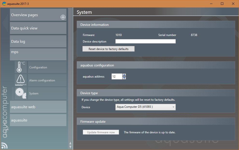

I can't set the priority to aquabus
this option is removed! you dont need this settings anymore.
When you make changes with aquabus devices you have to power of the pc completly (unplug the power cable)!

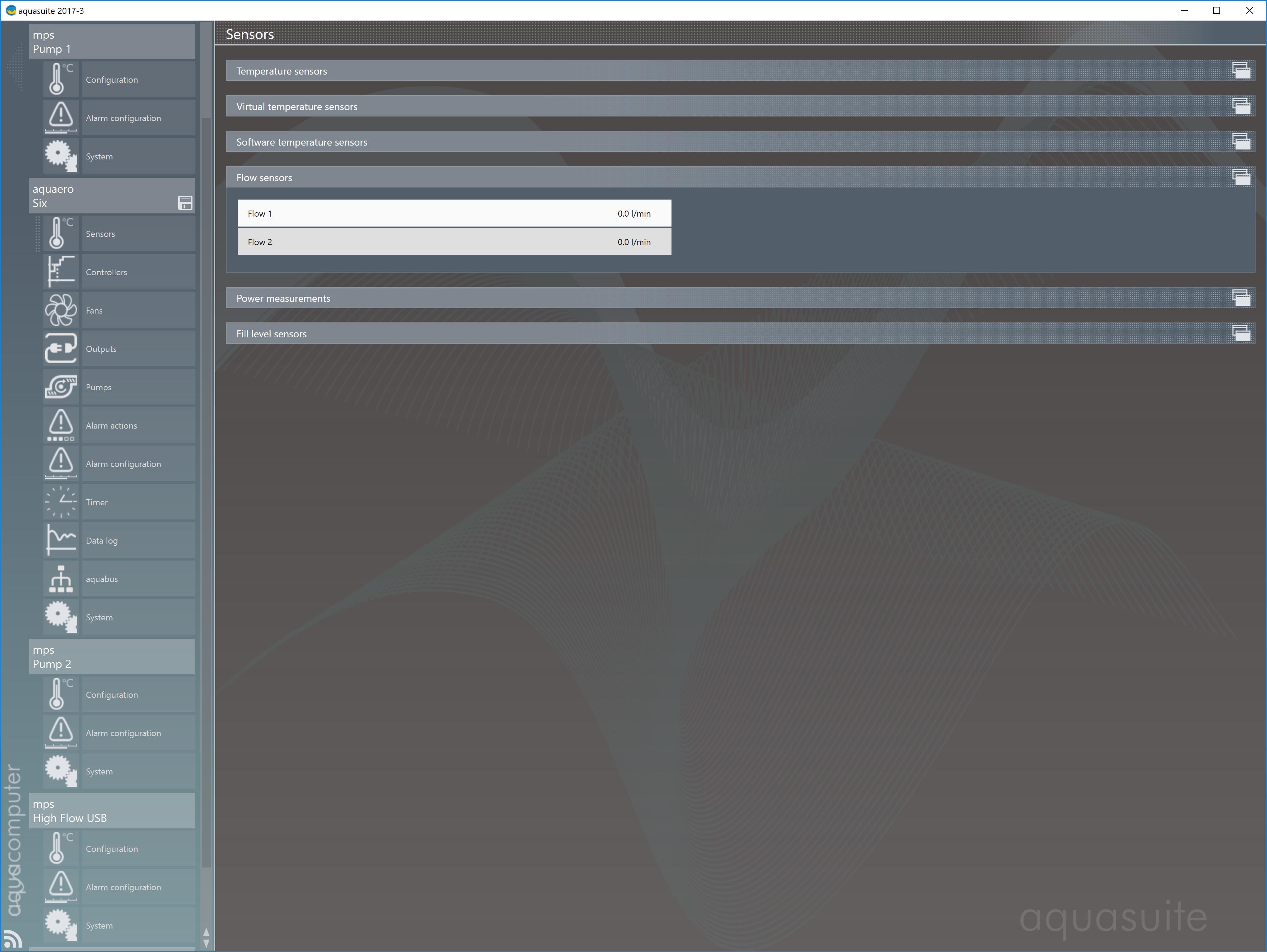

I appear to be having an issue with the aquabus.
The High Flow USB sensor does not list under aquaero>sensors tab (a6_sensors_flow.jpg)
The D5 USB pumps also do not list under the aquaero>Pumps tab (a6_pumps.jpg)
And the D5 USB Pumps are not available as a source for a preset controller (pumps_preset.jpg)

In the original post Shoggy stated:
If you use devices with the aquaero that are only connected via aquabus it is indispensable to connect such devices via USB to perform an update of the firmware, otherwise devices will no longer work with the aquaero or show a strange behavior.
So yes, you will have to connect all aquabus devices via USB in order to update their firmware.

So Do I connect now every PA3 and USB flow meter via USB to Aquaero or M/B?
I assume to aquaero and than update the firmware again with PA3 connected ?
You can leave the aquabus connections between the devices and the aquaero connected.
But you will need to connect each pa3/flow device to a USB port on the M/B for the firmware update.
If you do not have enough USB ports to do all at once, you can do them individually or in groups.
Do not forget to turn off the computer for each cabling change.
Edit, yes, I think Shoggy may want to highlight the USB requirement comment in red in the original post.
There are probably many more who do not have the USB connection on their aquabus devices.
Dieser Beitrag wurde bereits 2 mal editiert, zuletzt von »InfoSeeker« (4. November 2017, 18:33)

Thank you for your advice. Yes I have 2 USB 2 on the M/B so I will leave the USB that is currently connected to Aquaero and use the other to connect each device individually, I'm wonder if you still have to assign port# for each device or it will pick it up on its own
Samstag, 4. November 2017, 18:47
Yes, I think each device will still need an aquabus port assignment, but the device should retain the number that was assigned before. It will show in the system tab after the firmware update.
Dundys
Samstag, 4. November 2017, 19:28
I got rusty and I got spoiled by my system running flawlessly for the past 2 years I haven't done nothing to my system in a long time but it's like with anything else, once get back to something you've done it before its all good.
The USB flow meters are all good now, it took a few minutes once USB got connected, later I will do my PA3 and its all set.
Thank you for your help :thumbup:

Dundys
Samstag, 4. November 2017, 23:12
Firmware of all my devices that were connected to Aquaero went OK and although, everything seem to work there are few things that are little off....
My profiles which I made to my liking have changed, it seems that all of my 6x PA3 voltage has change. If I leave 4 of my PA3 with the voltage that is now and they are controlling my D5 Varios via Voltage they will stop I have to bump the voltage again to get them going and they were set so nicely before.
Also, High speed USB Flow meters, which in my case I have 2 of them, they behave strange.
Before the firmware update if I would to cut the flow rate off it would reflect that straight away, it would show 0 Flow and 0 Rpm, now if I stop any of my pumps the RMP shows 0 but it doesn't reflect the flow rate for the next good 20-30 seconds it still shows the flow rate before I've stooped the pump(s) the flow rate comes down to 0 very slowly, it takes at least 1-5-2 min. but that takes good 1.5-2 min. it seems to have a big delay with either when pumps are starting and stopping as far is flow rate indication
I mean......... flow rate doesn't just jump from 0 to say 80L/h in seconds, especially with my complex and big size system so when I see this behavior its only rational to think the pump would start moving the water accordingly ...maybe this is normal behavior now and I just got used to it with something that wasn't working properly to begin with..maybe .I'm trying to convince myself 8o
