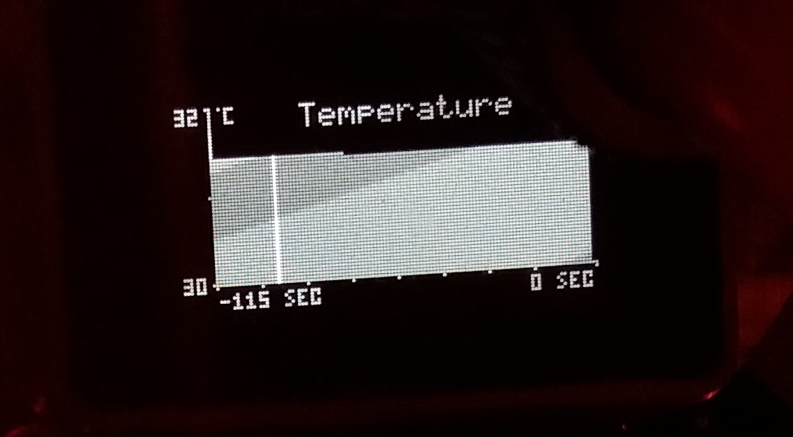

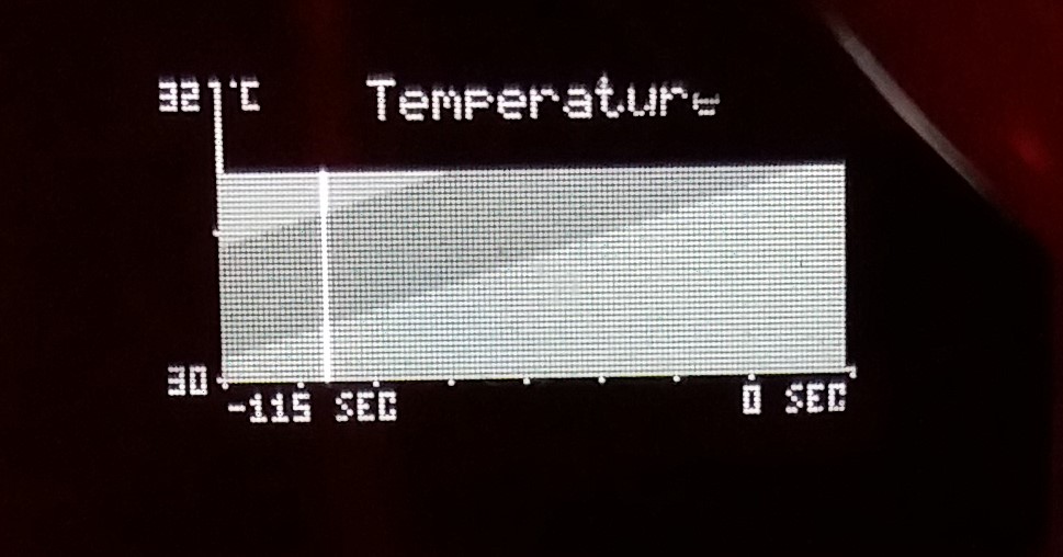

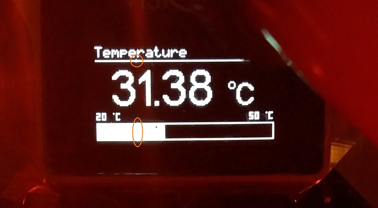

Hello,
I recently installed my Cuplex Kryos NEXT with VISION waterblock and after a couple of days without any issues a strange white line appeared on the screen.(Photo attached).I noticed that the line is visible only over white or grey background and not over black.Has anybody noticed something similar?I tried to switch off and then back on the display from within Aquasuite application to no avail.Notice that the line appears on all different display pages however is more visible when another than black background content is displayed.

The whiteline indicates a problem with the OLE-Display. Maybe it is the display itself or the flexible PCB from the controller board towards the display. Anyway, you won't be able to fix that and the VISION module needs to be replaced. You should contact us by e-mail with your address details or order number.
