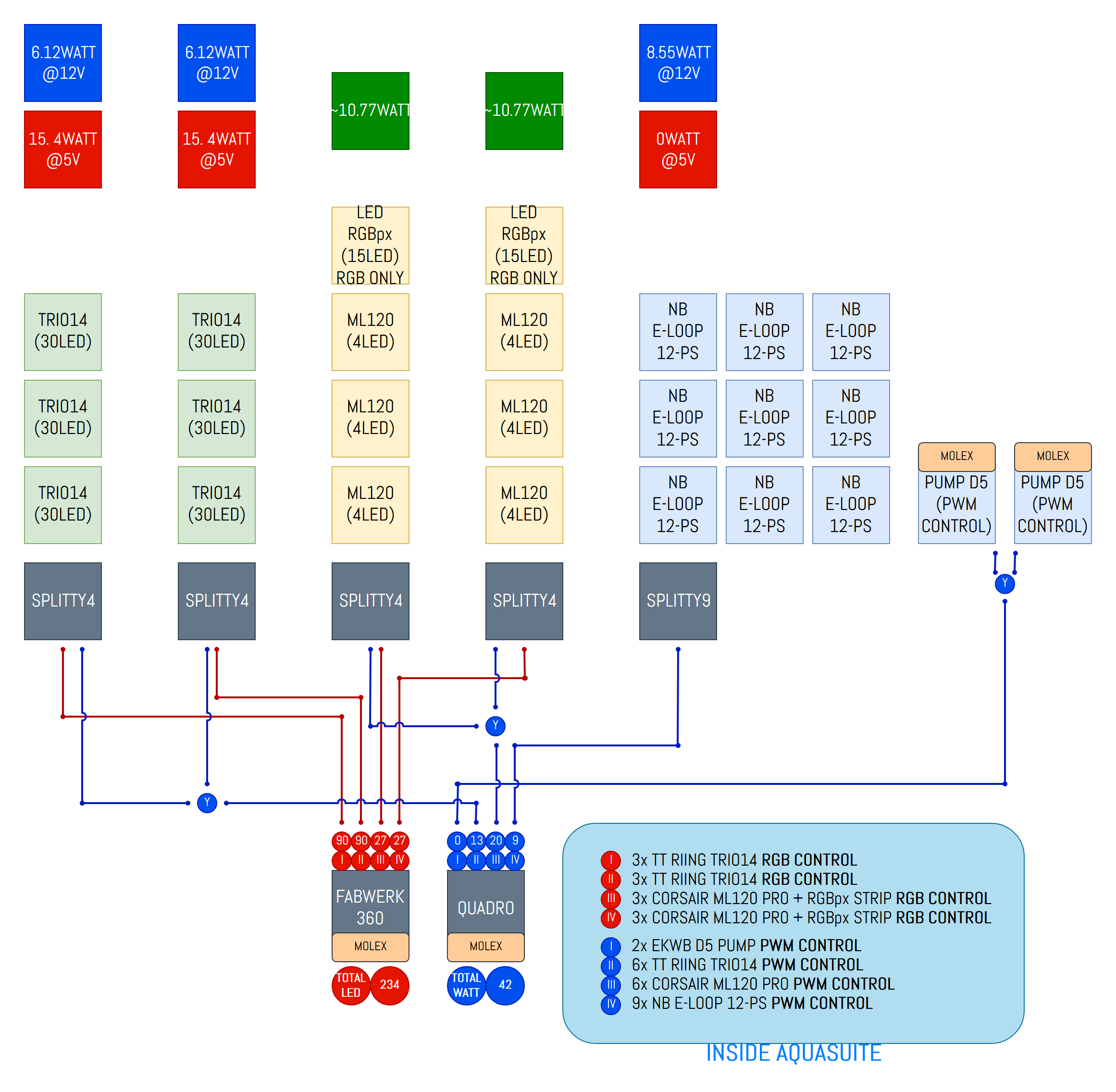

Hello there from France, i'm new to this forum and this is a pleasure to me as i'm finally finishing a project i started a while ago (with some pauses).
First, this is about a simple water loop over a dual system in a double TT X5 Core case.
I learned about AquaComputer products and determined what would interest me.
I would like to accomplish the connection of Riing Trio 14 Radiator Fans TT Premium Edition fans on the SPLITTY4.
Using watchound post as inspiration :
https://forum.aquacomputer.de/weitere-fo…gbpx-splitty-4/
• Does anyone know if the pattern is different from the TT Pure Plus concerning the 4 RGB pins ?
• If not, do you know how to find out with a multimeter ? Even an helpful link would be fine...
• Do you think there is any problem in the schema below ? (higher res as attachement)
Note : I'm not sure yet about Corsair ML120 PRO Fans, if i don't get them, i will just delete 2 SPLITTY4 and connect RGBpx on the RGBpx Quadro pin.
Thank's
Hufeisen
Donnerstag, 18. Juli 2019, 23:03
RGBpx connection is in this thread (see attachments on the first two posts)
RGBpx wiring Diagram
DRF
Donnerstag, 18. Juli 2019, 23:52
Thank you for the reply
Actually i knew about the RGBpx pattern (from the link i posted), but i think i would have more people aware of the answer (the thermaltake side with 4 black wires with no code) on the TT forum.
Or maybe just find the wire with 5V... but how do i find the ground so ? I learned those at school but forgot almost everything.
I'll update as soon as i get it.
(I think about another problem if i don't know how much 5V power i do need for ML120 i might reach the 40W limit of the fabwerk 360)
EDIT : the answer was under my nose, under the sticker of the fan i can see the PCB with 5V DO DI .....

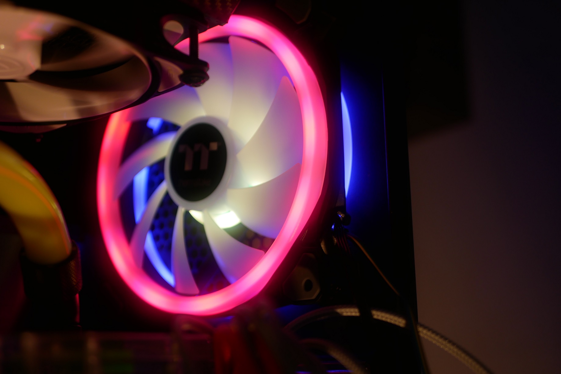

DRF
Mittwoch, 12. Februar 2020, 18:31
Yes !!!
I got it finally working thanks god !
Here is the fruit of this work.
To anybody who wants to know, please keep in mind that this is kind of a "hack" and you must know what you are doing.
Apart from that : Enjoy !!!

eisbehr
Donnerstag, 13. Februar 2020, 10:03
Hello!
May i ask you if this working fine for you? I calculated the current of your lightning setup. If i'm not wrong you draw around 10,4A current from the farbwerk360. But the farbwerk is specified with a max of 8A. Do you have changed anything or did it just work fine?
DRF
Mittwoch, 19. Februar 2020, 14:39
Hello!
Hello
Yes it is, but i don't know how you calculated this since i didnt split 5V and 12V in my diagram for Corsair fans ?
However in my setup i have only the TT Trio + RGBpx 15 Led strips so it 's about ~7A for 210 leds.
And i dont think that the 4 led / Fan ML120 x 6 = 24 led would draw about 3 or 4A

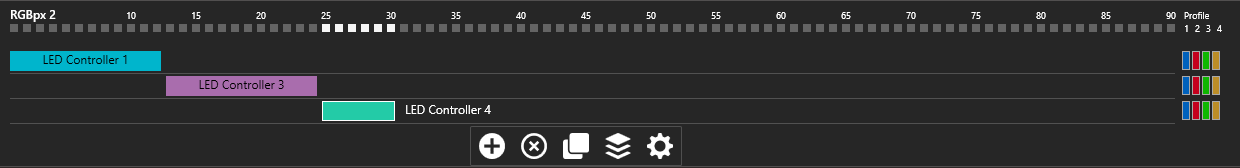

If 20 LED controllers' limit is becoming the ceiling for Riings Trio, i mention their led groups could be merged together in aquasuite to ensure being inside the 20 controller limit.

Which may or may not be an issue based on how it works in aquasuite, as I would want anywhere from 17-24 groups depending on how I can set it up in aquasuite and how it works with the Riing Trio fans. Even aside from that, I would still be worried about the 40W limit on the Farbwerk 360. According to the reported specs here are the totals from Thermaltake on their specifications for how much wattage the components take, it is 15.4W for 3 fans (so 5.13̅3̅W per fan), and according to the specs, two other components have 12 LEDs each that each take 6.5W and one has 12 LEDs that takes 2.4W. This totals to 51.3̅3̅W which is well above the reported 40W limit on the Farbwerk 360.
