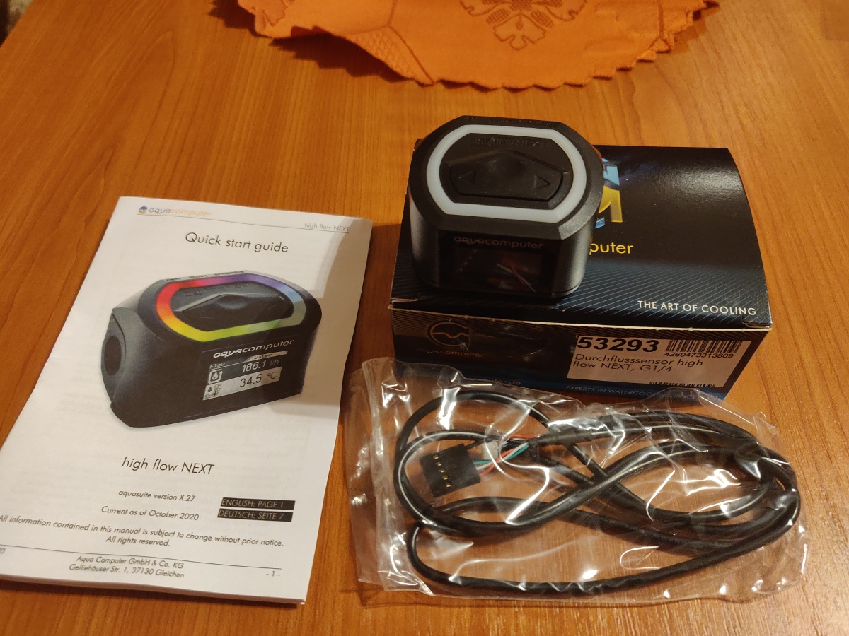

and is here :)
I will install tommorow or over weekend...
»bojer« hat folgende Datei angehängt:
Donnerstag, 22. Oktober 2020, 22:21
An actual picture of one in the wild, nice... and I see the manual is online also.

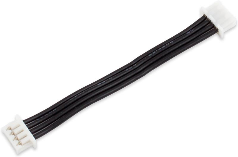

high flow NEXT do not need a connection to OCTO, it can work as standalone device. Connection to "flow" port on OCTO is needed only to have OCTO reading flow measurements outside of Windows. For that purpose, a double-sided 3-pin picoblade cable is needed, unfortunately I do not see it in AQ shop list. Use aliexpress though )
Freitag, 6. November 2020, 11:52
Be careful using standard PicoBlade cables, the pinout between the two end terminals may be inverted from RGBpx by default.
For a four pin terminal:
• PicoBlade pinout is 1 to 4, 2 to 3, 3 to 2, 4 to 1 molex_orientation.pdf
I build my own RGBpx cables using standard of the shelf components (I use mouser.com in USA).
PicoBlade wires precrimped at both ends
PicoBlad terminals
I just click them together, but mind your pinout orientation.
Freitag, 6. November 2020, 12:16
no nothing is invertet.
The RGBpx cables are 1:1 cables => pin 1..4 to pin 1..4
Freitag, 6. November 2020, 12:22
That is what I said, though probably poorly stated.
The Molex PicoBlade standard cable IS inverted from the RGBpx specification molex_orientation.pdf
k2viper
Freitag, 6. November 2020, 14:16
You're right there is a possibility that 2-head aliexpress cables are inverted, need to check before purchasing. There are aliexpress single head wires that can be soldered 1:1, color to color. They are called JST 1,25mm instead of picoblade, but the connector is the same.
