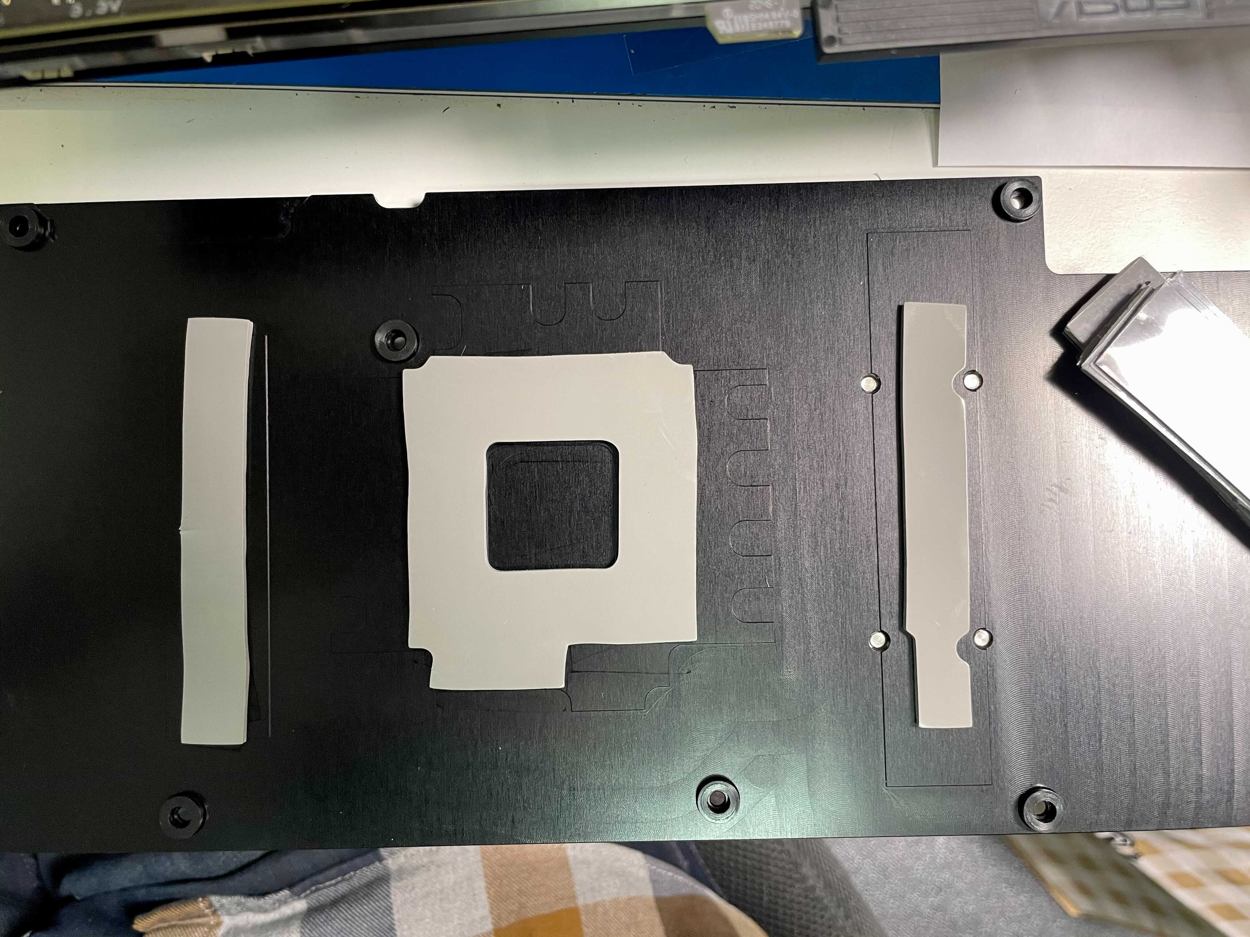

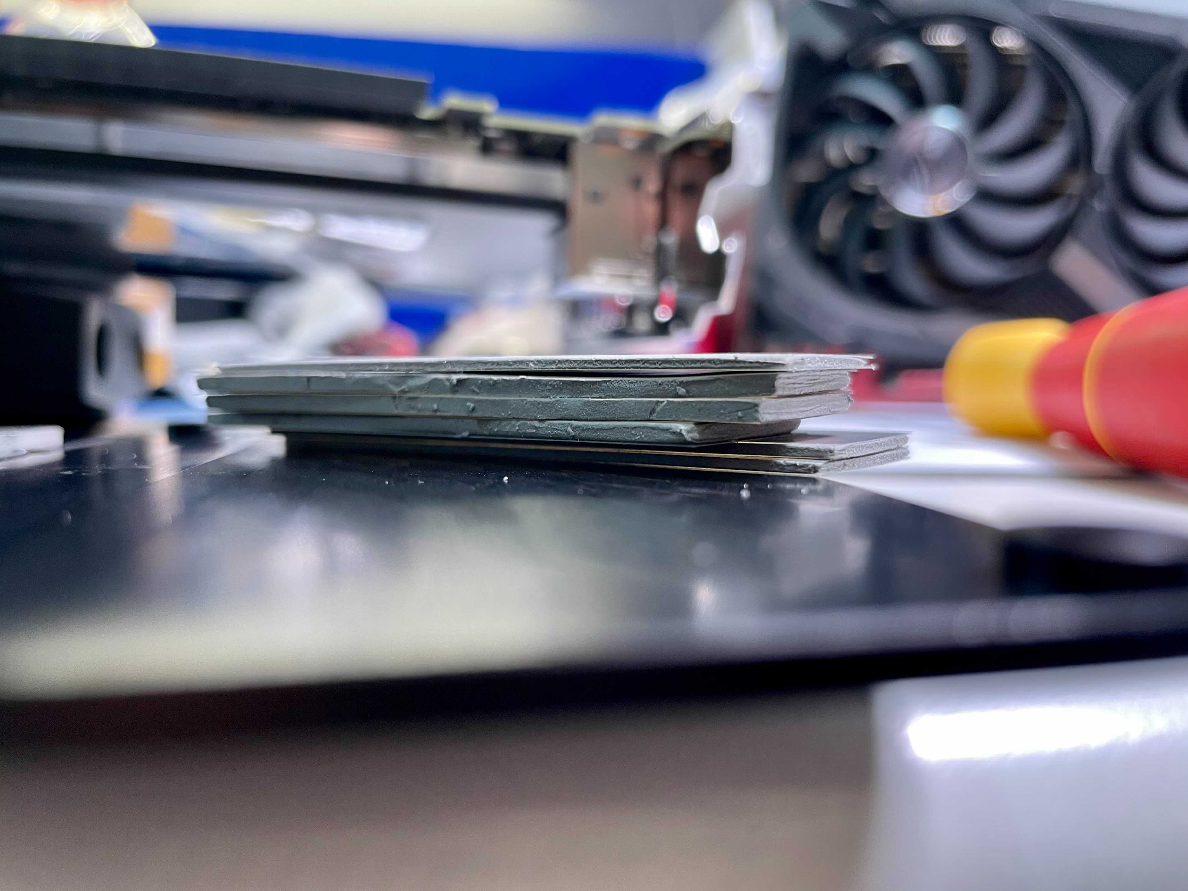

I might have also received the wrong pads. There are three thicknesses in my kit: the thick pre-cut pads, three medium rectangles, and three thin rectangles. Which of the rectangles should I be using?
[img]https://forum.aquacomputer.de/index.php?page=Attachment&attachmentID=8340&h=861d2e666ae0366c6232f845e8bcddbec580055f[/img]
[img]https://forum.aquacomputer.de/index.php?page=Attachment&attachmentID=8341&h=fb58304e4e03fb076231705b5b4964a8fe1434bf[/img]

For the record, the thin ones (1mm) are the correct ones for the red areas. I checked with calipers, and the memory is 1.25mm tall and the backplate spacers are 2mm. This leaves a 0.75mm gap, which would be 25% compression on the 1.0mm thermal pads (the thinnest of the three) in the bag.
