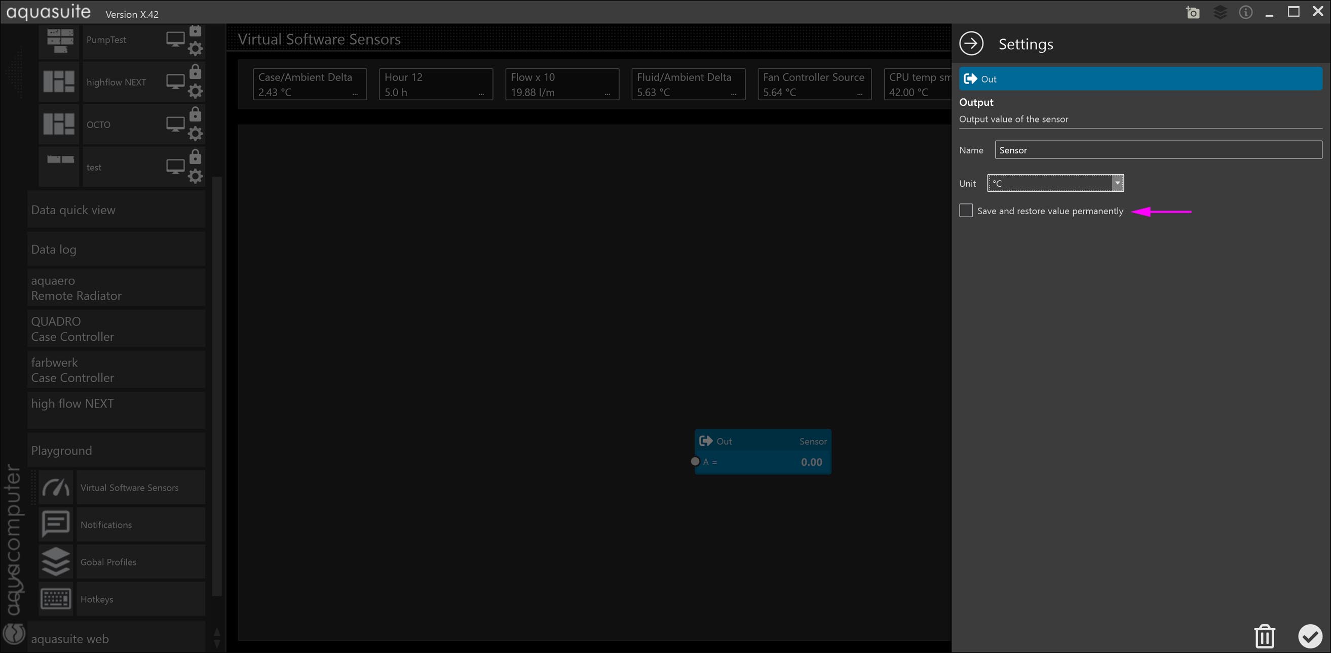

Wasn't sure what it did, so I tried selecting "save and restore permanently" on the software sensors, but that didn't fix anything.
{snip}
I find no reference to it in the aquaero manual.
Dienstag, 3. August 2021, 13:51
This is the initial value when the sensor is the calculated the first time after startup.
Dienstag, 3. August 2021, 16:28
This option saves the final value of the Virtual Sensor at system shutdown, and inserts it at the following system startup until the Virtual Software Sensor is able to generate an updated value?
Dienstag, 3. August 2021, 17:53
I would also like clarification on this. Sebastian's explanation is worded quite strangely and does not make sense to me. I have 2 Farbwerk360s in my system. They are controlling various LED strips and devices. Both Farbwerk360's have a preset that controls LED color based on CPU temp, but it is not the default preset. When I boot up, all of the LEDs connected to the first Farbwerk360 light up bright RED. All of the LEDs connected to the second Farbwerk360 light up bright BLUE. I have no idea why and am wondering if this "Save and restore value permanently" will have an effect on what the LEDs do before Aquasuite starts up.
