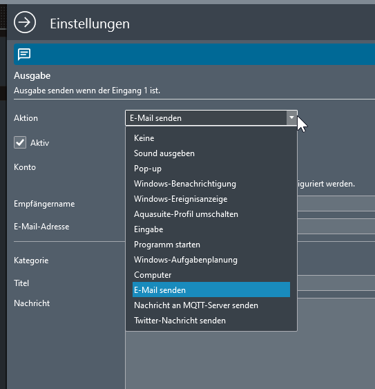

How to setup twitter notifications in Aquasuite?
Sonntag, 13. Februar 2022, 09:10
I have been searching and I found a 2020 (?) post showing that the Notifications tab is under "Playground".
However thats not the case with x.49 that I am using.
Can anyone help with it? I have already set it up through "aquasuite > Accounts" and done the test tweet.
I'm also on X.49 and have the notification to twitter
»mditsch« hat folgendes Bild angehängt:
