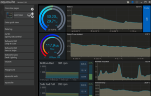

I personally use an Octo, with an EK DDC pump (used an EK D5 before), and a bunch of fans.
no D5 next needed :p
There.. an Octo and no D5 NEXT connected :p
The Octo is an USB device, it works on its own, there's no dependencies between devices. they ALL work standalone.

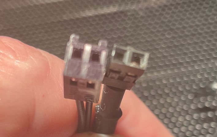

The temp sensors that come with the Commander Pro will work with the Octo but the 2-pin connector is much thicker than the connector on Aquacomputer temp sensors. Because the 4 temp sensor headers on the Octo are very close together, the Corsair temp sensor plugs will only fit in Octo temp sensor header #1 and #4. Its too thick to plug into temp sensor header #2 or #3. You get 1 Aquacomputer temp sensor #53026with the Octo. I have attached some photos that show a Corsair temp sensor 2-pin connector and an Aquacomputer 2-pin temp sensor connector. You can see how much thicker the Corsair one is. If you need to buy more temp sensors, the Phobya #71222 has a very thin 2-pin connector that will fit fine on any temp sensor header on the Octo.

Very nice and important information not to mistake! I have never gotten any idea about that...
I may need one additional sensor for ambient air temp. #53026 or #71222 will work for me.
Thank you, Speedy-VI
