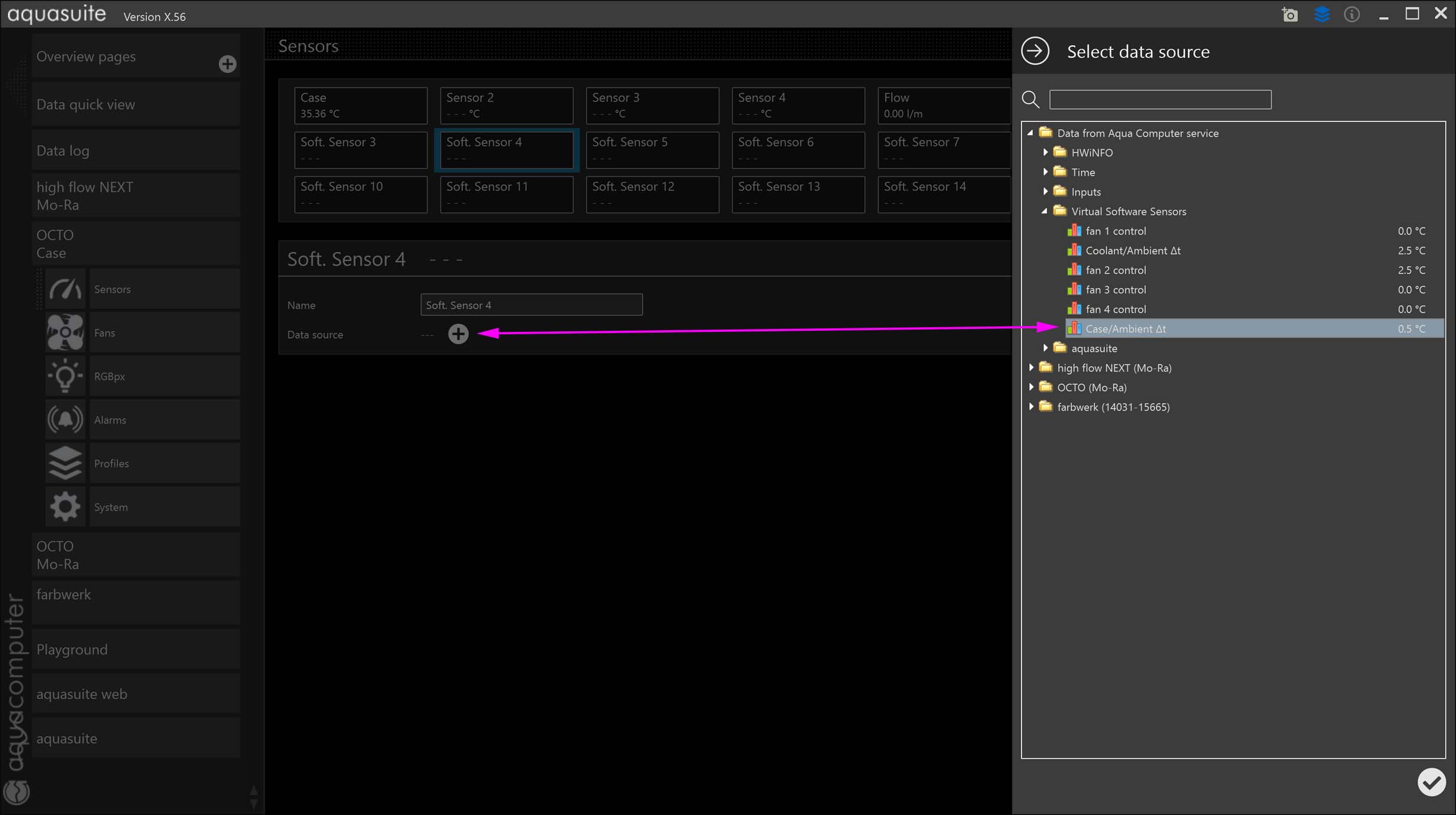

I found the "Data from Aquacomputer Service" under the Data Quick View tab. But when I clicked on CPU Package or GPU Core it just shows a graph at the bottom of screen. It does`nt go to the Overview or Octo Sensors or Fans tab.How do I get to stay?

You have to import the sensor into one of the Soft Sensors in the Sensor Tab under the OCTO.
  • click on the octo tab
  • click on the Sensors tab under the octo
  • click on one of the sixteen Soft Sensors at the top of the Sensors page
  • click on the '+' button below (you can also rename the sensor)
  • select the sensor you want to use from the list that pops up to the right {import.jpg}
  • that sensor will be available as a source for your controller curve

Okay, got the CPU and GPU to show temps. Tomorrow I will connect the ambient sensor and work on the other things.

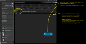

So, I got that Ambient sensor connected now. It`s hanging out the back of the case and a little below the table. I went into the Playground and tried to start adding virtual sensors, but this part is not working out for me. I don`t quite understand how to do this part of it.

The two (+) buttons may be confusing. The top one is to add a virtual sensor, the bottom one is to add stuff inside the virtual sensor.
Basically, creating a virtual sensor is creating an OUTPUT. It can be anything, a temperature, a value in watts, a percentage.... Here we want a temperature.
In the virtual sensor, you then add sources, and various little modules to manipulate those sources into what you want. Can be the 4 basic operations, could be filters, logic gates etc... Here we only need a substraction since it's a delta-T we want to create.

Creating a Basic Virtual Sensor and Using in a Curve Controller
https://www.youtube.com/watch?v=TisPkLBMJo0
(and yes I know, there's a small error in selecting the correct Sensor in the final step)
