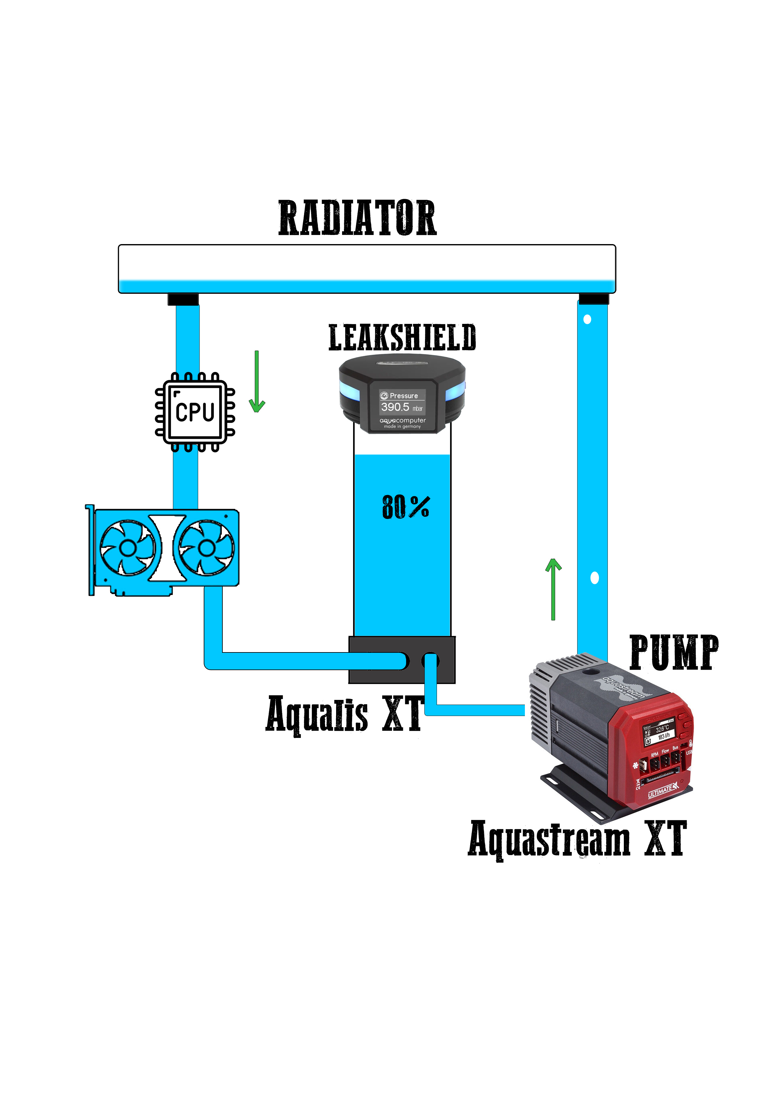

After 3 months of using Leakshield and 2 months of using the Aquastream pump, I want to complain about a problem that I can’t solve.
I want to say right away that I use Leakshield installed on the Aqualis XT 450 ml with fill level sensor. (bought long ago). Simplified flow chart in attached files.
During computer non-working hours, at night, the Aquastream XT pump can pass one small air bubble every 2-10 minutes. This is only observed in SHIELD mode. And only when computer turned off.

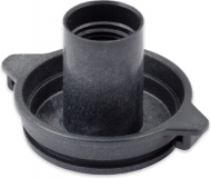

I thought the fittings were the problem, but air is leaking through at the connection to the pump cover (article 41032).
On normal days this is not a problem, rare bubbles from the pump rise into the radiator (Scheme 2) and raise the water level in the Aqualis reservoir overnight from 40% to 50-60%. Turning on the computer fixes the problem.
BUT, if I do not turn on the computer for several days, for example, a weekend, a little bit, one bubble at a time, the air pushes water out of the radiator, which is screwed to the top of the case and raises the water level in the tank to a critical level.
Which ends with an alarm in the Leakshield and then the flooding of the compensation membrane of the leeshield air pump, rendering it inoperable even after turning on the computer.
Alarm: Air volume in reservoir too low or pressure compensation membrane impermeable.
After each such incident, I have to drain the liquid, twist the Leakkshield and dry it for several days! As a result, Leakshield does not work more often than it works.
Please help, do not know what to do.
Want to add that Aqualis fill level sensor not working with Leakshield !!! YES, I know that the documentation says about this, but if the Aqualis fill level sensor worked, then it will theoretically possible command to turn on, for example, a pump or computer (via the aquaero 6 XT relay) and solve the problem, or if the Leakshield itself could identify such a problem.
And yes, I have the pressure equalization membrane that comes with the Aqualis, but I'm not allowed to use it with the Leakshield (according to the instructions).
Guys from Reddit adwised to buy EK-Loop Connect Coolant level sensor or Koolance Liquid Dual level Sensor to fix Aquastream problems, and i am thinking about it..
I would not want to buy solutions from other companies as a bug fix for this problem.
P.S. Please do not adwise me to change Aqustream gasket, already did. And will try to change pump cover (article 41032) as soon as it will come.
And i had the same problem with my previous pump Asetek, which to work without issues before Leakshield installation.

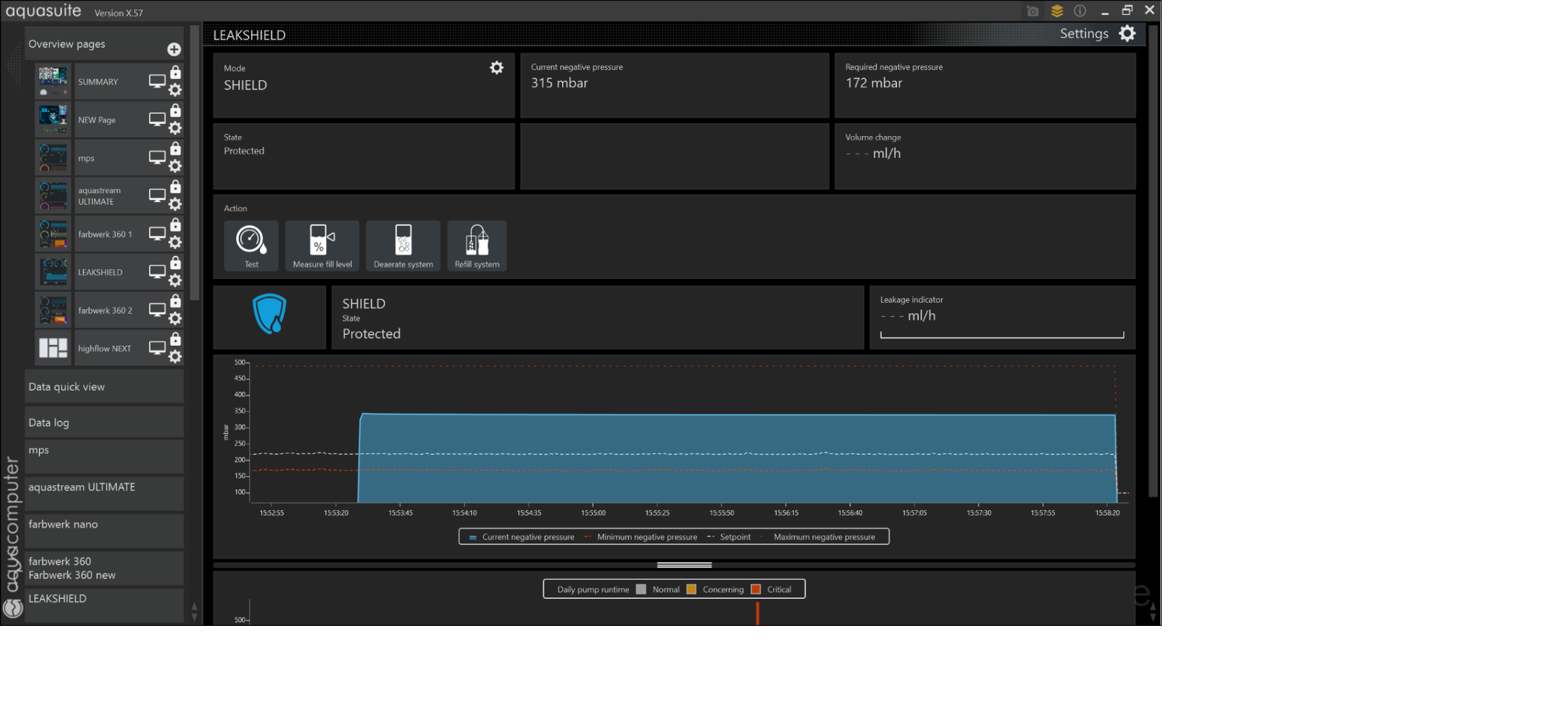

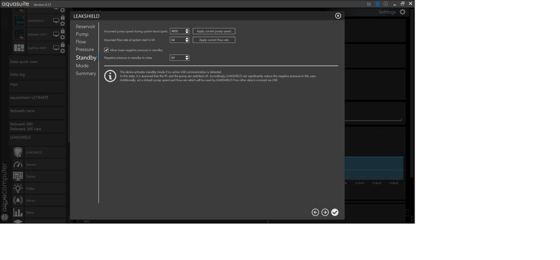

H!, Actually my sytem shema was added in files, but it is Ok to add real picture and screenshots.
On second screenshot hgeneral settings, you can notice that fill level is empty.
On third error after compensation membrane becomes wet. Measure Fill level button pressed.
In other files i have added ALL current leakshield settings.
Sound Allarms turned off, because i want to sleep during night..

As a temporary solution, after the computer is shut off, you can manually reduce the vacuum of the leakshield to 150mbar.
Lower pressure means less air is pulled into your system, reducing the flooding rate. You have to increase the pressure again before you start your computer.

What happens when you go to Leakshield -> Settings -> Standby and uncheck the box "Allow negative pressure in standby"?
This setting will work only if the Leakshield has power while the system is in Standby. You may need to enable USB power during standby in the motherboard BIOS.
