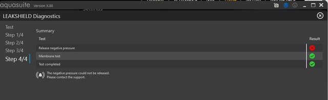

It's stuck at -115 mbar...after I did some tests to try and remove the air, it's now stuck at -251 mbar. I tried releasing via Aquasuite and the Leakshield itself multiple times but no release would actually occur.
I did the test but the one while the Leakshield is still connected and got this:
I reset it to factory settings but nothing. I also updated to the newest version of Aquasuite (X.88 ) around 10 minutes ago. Also, increasing pressure seems to happen much slower than before but I don't know if that's just how the tests are designed with the new firmware and/or software. Also, the unit seems to go up and down in pitch whenever it increases pressure - kind of sounds like it's struggling - goes up in pitch slightly, then down in pitch slightly, and repeat. Again, not sure if this is indication of an issue or intended since the previous update.
Unit pumped fast, no up/down-repeat pitch noise, and released pressure perfectly literally it's whole life including around 1 hour before I updated. If the update had nothing to do with it, and it worked perfectly 1 hour before updating, and then all the issues occurred literally immediately after updating, then that is the most astronomical coincidence of all coincidences. Either way, how to we proceed to resolve this?

Freitag, 6. März 2026, 03:57
Wow - Its been several months since you posted about this. Has the release valve been stuck all this time? Maybe the release valve was stuck for some reason, and the other things you observed are symptoms of the root problem - relief valve stuck closed. Maybe the firmware update was corrupt, or the Leakshield did not reboot properly after the update? Maybe a piece of debris/foreign material somehow got into the valve mechanism? Faulty valve control wire? Grasping at straws here. Hopefully Shoggy will know exactly what is going on. I would cycle the vacuum pump a few times to exercise the valves and see if it gets stuck again.
