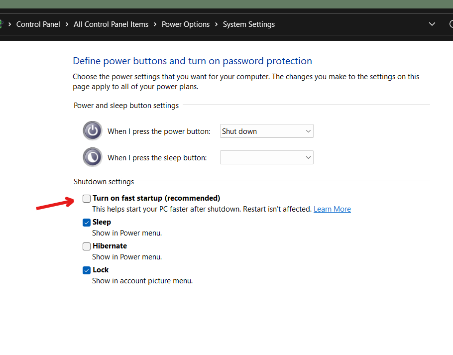

Hey folks, just received my Ampinel, lovely piece of tech. I do however have a very annoying issue. When I shut down my PC Ampinel keeps getting power and ends up going in alarm. Anyone run in to this yet? I also can't shut down the alarms, adjusting the delay doesn't seem to work. It's driving me up the walls.
Edit: Solved by disabling Windows 11 Fast Boot.

Ok for someone stumbling upon this post I'll post some relevant info and weirdness. I ended up installing it again cause I just couldn't let it rest.
PSU. Corsair RM1000x Cybenetics Gold ATX3.1 PCIe5.1
Motherboard: Asrock X870E Taichi
CPU: 9800X3D
I tried disabling the PCIE Devices Power On setting. That didn't do anything. I enabled Deep Sleep, which apparently is the AsRock version of ERP, that also changes nothing.
The strange thing is though, I have it when I shut down from Windows. When I just power down with the power button during the boot cycle the Ampinel also powers down like it should. Power down from Windows with the command or power button and Ampinel stays powered. So atleast it's usable now, I'll dig a bit deeper to see what the difference is in those power down methods.
Edit, ok I found it. For anyone running in to this, disable Windows Fast Boot...
»koji« hat folgendes Bild angehängt:
