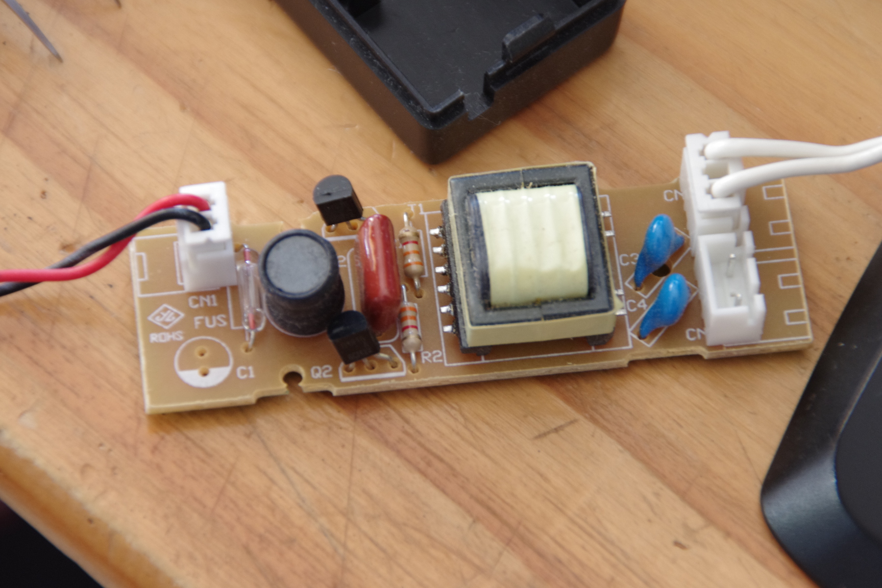

Matter of fact, both are true. Ever cracked one of those converters open? They contain a small transformer for stepping up the 12V from the PSU to about 600V. Problem with that is, whenever you switch current to a coil (ie a transformer) on and off, you get a voltage spike. Since all 12V busses of your computer are connected together, it spikes through all the system. More than one person I know fried an MB by switching off a CC or by having a loose contact in the plug. Those things should contain a varistor or a Z-diode to cull those spikes, but usually you're lucky if they contain a buffer capacitor.
See that spot marked "C1"? That's where it oughta be. Do me (or let's say: yourself) a favour? at least check yours for capacitors. If they haven't got any, don't try to solder any in, you might accidently create an oscillating circuit. Just throw them away.
