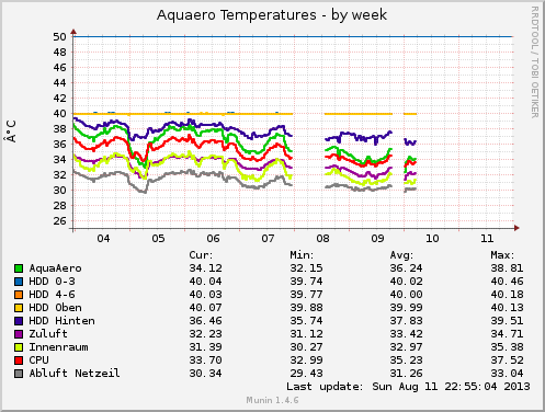

Raptor 2101
Sonntag, 11. August 2013, 22:53
ok with you new version, the "hang to zomby" happens quite often. While running the old version for a weak (through munin) the new version got two hangs at this weakend...
