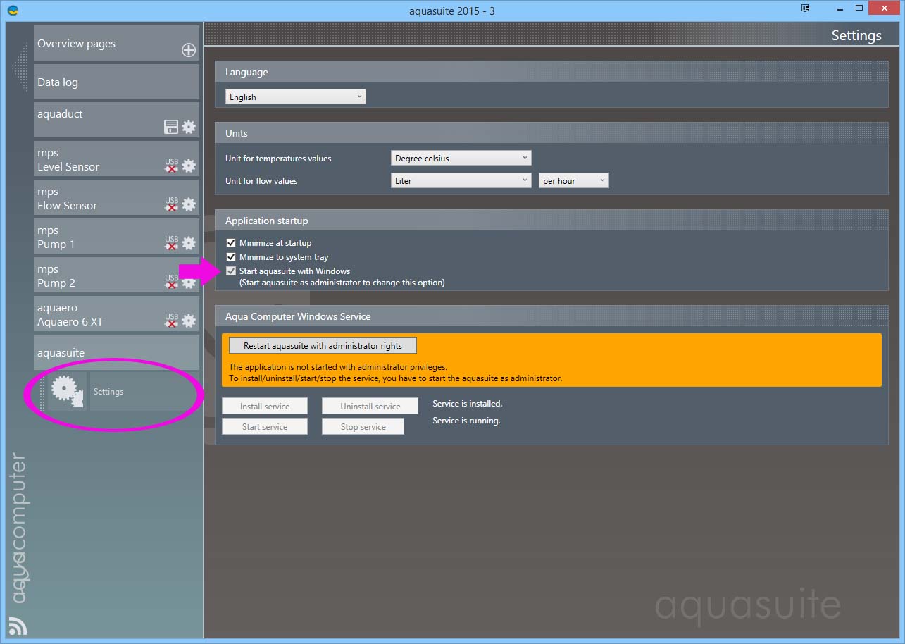

Hello, is there any way to set me after the computer boot automatically display the sensors on your desktop?
Excuse me for my bad English, I'm from Czech Republic ...
Dieser Beitrag wurde bereits 1 mal editiert, zuletzt von »Mayki« (16. März 2015, 16:31)
Montag, 16. März 2015, 16:50
I think you are looking to load aquasuite at system boot-up, which can be set in the "aquasuite>Settings" tab, then select "Start aquasuite with Windows", only in Czech :)
Mayki
Montag, 16. März 2015, 16:59
Problem solved, enough to install the new version Aquasuite 2015-4.
Now it works perfectly ... :thumbup:
