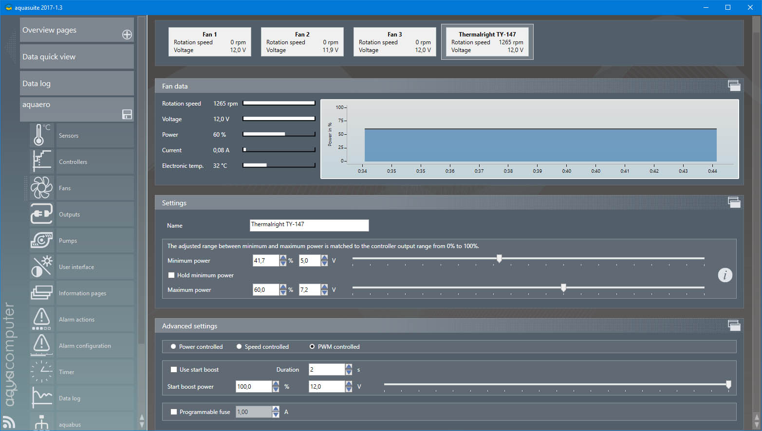

I have a problem with my Aquaero 5 XT when I'am trying to control fan by PWM.
I connected my fan (Thermalright TY-147) to 4th aquaero fan connector and chose "PWM controled" setting on Fan page. But my fan is working on full speed and don't react on changing maximum power value, the RPM are always maximum. If I chose Power or Speed controlled fan is controlling perfect.
There is a screenshot from aquasuite:
As you can see the Power is 60% but Rotation speed is 1264rpm, and it's not change.
And I found another interesting thing. When I measure the voltage between 1st and 4th pins on my motherboard fan socket I have about 4.3V on 100% PWM and about 2V on 50% PWM settings. But when I do the same with aquaero PWM fan socket I have about 4.8V always. Can it be the trouble with aquaero hardware?

It's really strange but now all is working OK. I just removed display module and radiator to check fan header path, and now fan is controlling by PWM normally. I can't really understand why now it's working and why it wasn't earlier.
