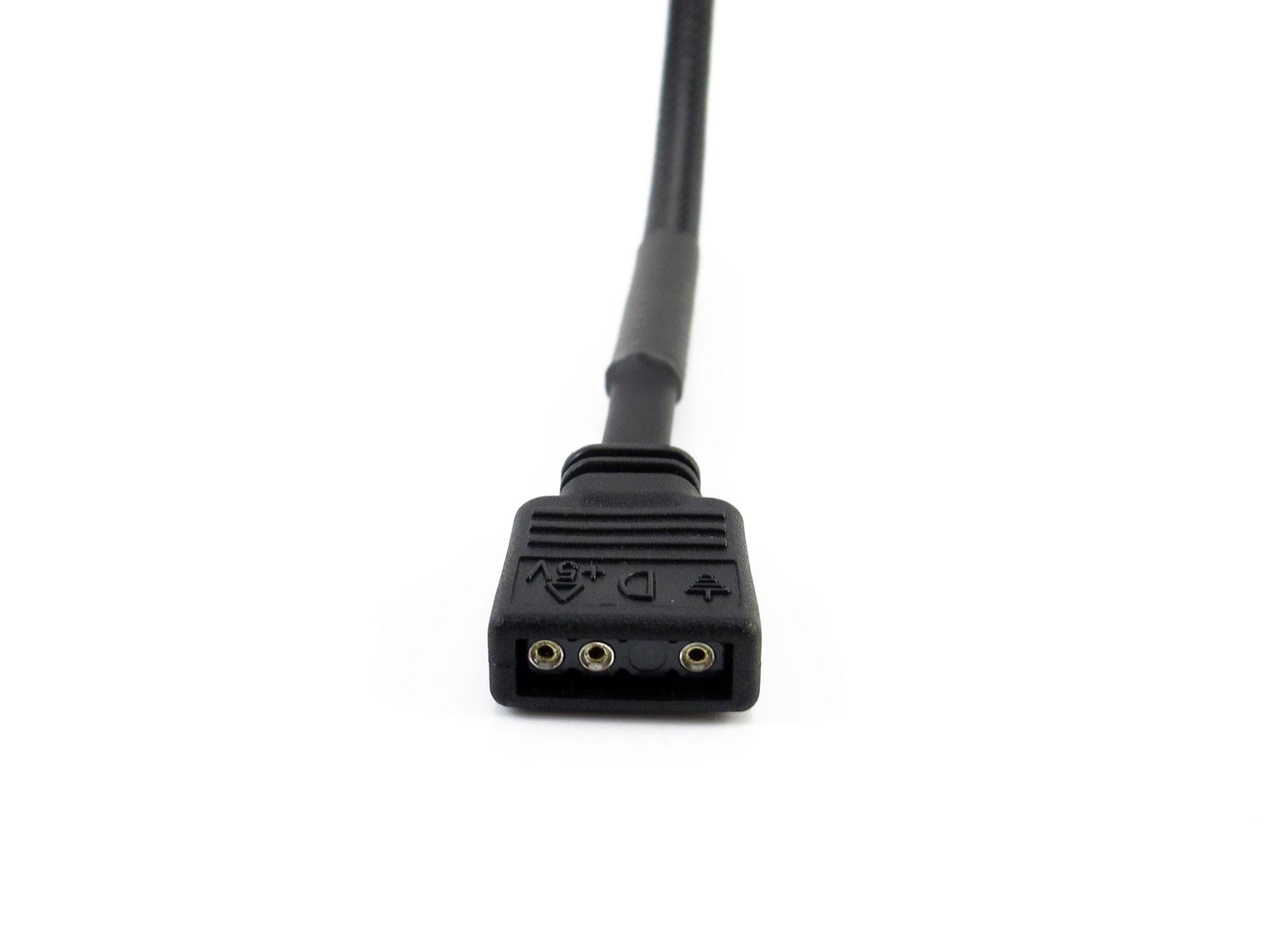

Hi, I have a few 3 pin drgb lights that I would like to manage using the farbwerk 360. Can these be connected and do they need anything special?

no one can answer this without additional Information.
The connector does not show anything about the LED controller that is used on the LED side.
There are a number of different LED Controllers, that require different Data input.
The LEDs can be connected to the Farbwerk, because they have a +5V and GND. You need to find out which Pins on the Farbwerk deliver +5V and GND.
The Problem is, that no one knows if the LED controllers are compatible and if you can change the LED Color with the Farbwerk.
This depends on the LED Controller used on the LED side, and if that controller can process the data sent from the Farbwerk.
You may need to build a custom adapter cable. Because the Pin configuration of the Farbwerk is not listed in the Manual, I dont know which Pin delivers +5V and GND.
If you connect the LED incorrectly, you will damage the LEDs, and it may cause damage the Farbwerk and other Components, like the Mainboard and Power Supply Unit.
I strongly suggest you to buy compatible LED Stipes from the Aquacomputer Shop.

Enzomatik, that looks like a fairly standard digital rgb pinout. Do you know if these are 5v powered? Can you share what manufacturer and model they are?
I've successfully made custom cables to adapt the farbwerk 360 to control thermaltake and phantek 5v digital rgb products, thanks to the rgbpx pinout provided by Noryss on this forum.

Let me clarify - My CPU block, GPU block and water distribution panel all have led strips built in that are addressable. They all use that 3 pin cable (5v) and plug into a drgb splitter which is connected to my Asus motherboard. Asus aura has bad lighting options imo and so I want to connect them to the farbwerk 360 so I can manage the lights in aqua suite.

Ok then. If you're handy with a soldering iron, and willing to accept the risks of modding, you can make your own adapters. I would recommend getting some rgbpx cables, and some 5v 3pin drgb extensions. This way you can hack up cheaper parts, and keep your original connectors intact on the stuff you already have.
You can get the rgbpx pinout from this thread, attached to post #2:
RGBpx wiring Diagram
Since your devices are 3pin 5v drgb, you won't be able to chain them together, so ignore the white wire. Instead you'll have to make 3 adapters and dedicate 1 channel for each item.
From the picture in your initial post, just match up the 5v, data, and ground wires to the ones noted in the picture found in the thread linked above.
