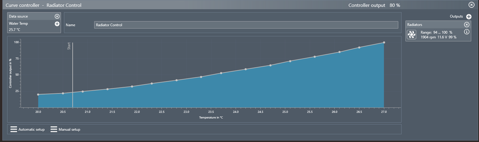

I have an assortment of brand new A12 and A14 industrialPPC-3000's and I am also having issues. I actually was able to get the fan curves working for the fans but it seems intermittent and changes with each reboot.
Based on what I have seen playing with the software, the output will drop voltage even though I have PWM selected and seems unreliable from day to day. I have attached a picture of the settings that I have that seem to be working fine right now. My issues are the PWM is inconsistent and I will see fluctuations in rpm speed, will not maintain a base rpm speed and jumps from about 2k to 3k rpm with no in between setting.

I did but it's not really a solution. I am trying to progress tweaking the software to at least get a workable solution. Otherwise, I just bought aquaero hardware/software that is useless.
