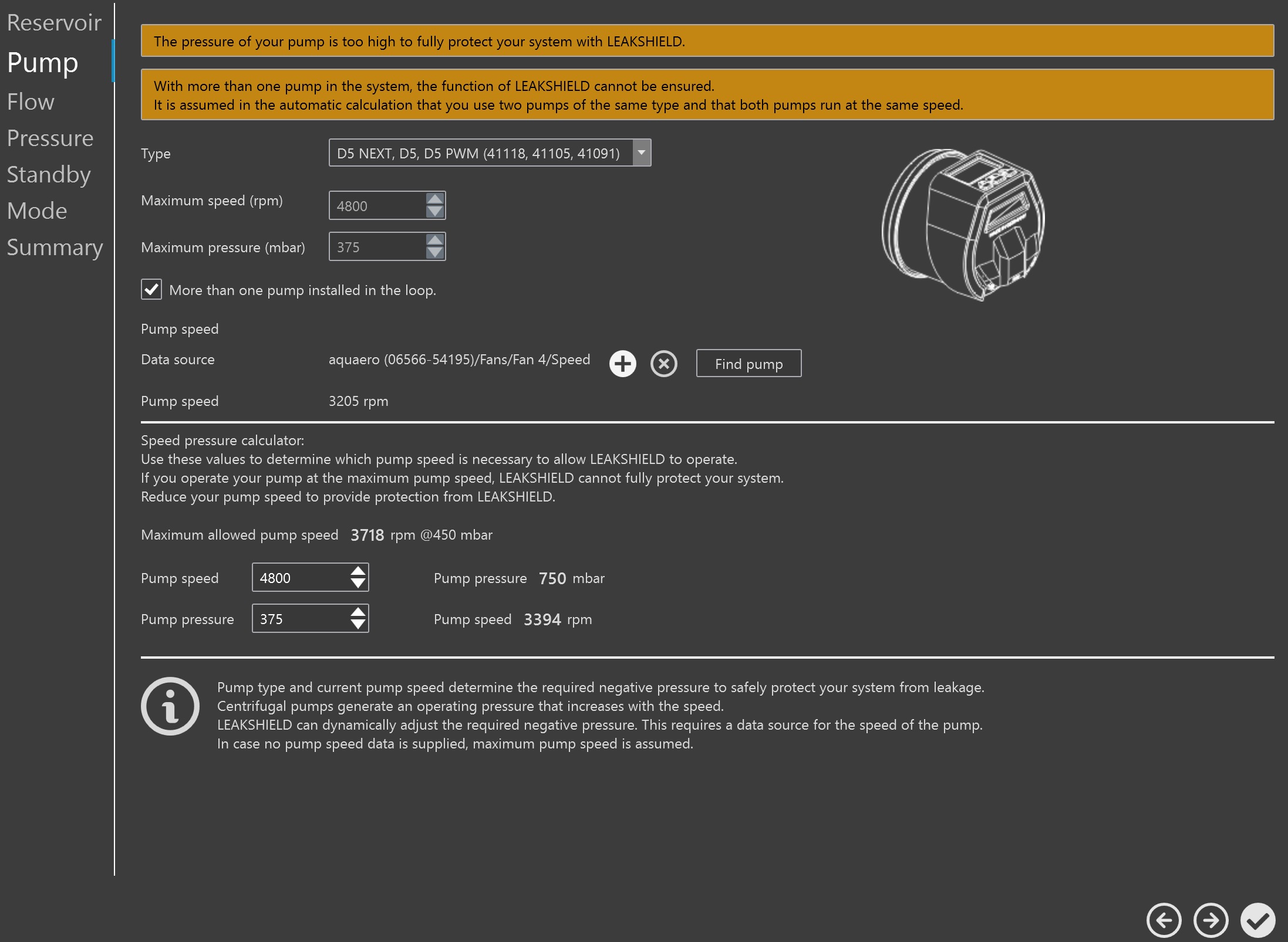

I'm using two serial D5 at 3200RPM and still got warning "pressure too high to fully protect" in aquasuite. Is it right or aquasuite bug?
As far as i understand, the max RPM is 3400 for two D5.

The positive pressure created by your two pumps exceeds the full negative pressure created by the leakshield
The total pressure of the two pumps should not exceed 450mbar
Otherwise, leshield only has monitoring and does not have the function of preventing water-cooling liquid leakage
I have two D5 NXET pumps
I will control the pressure created by the speed to below 450mbar
Please refer to leakshield's FQA :)
Two D5's @3200RPM gives 333mbar which is way lower 450mbar limit, but warning still appear and blocking further automatic calculations on the pressure tab (due false failed validation i guess).

Maybe you can try to remove the power supply of one of the D5 pumps and test again. :)
denny
Freitag, 17. September 2021, 09:59
Why? Its supposed to work with two pumps at low speed.
I found another bugs: 1) daily pump runtime chart not updating for last 3 days (actually the pumps works at least for 20 seconds yesterday).
2) Required negative pressure value suddenly dropped from 320 to 30 mbar after cold restart. Minimum negative pressure value in settings still displays 320 mbar.
3) Display off settings always setting to on at every restart.
