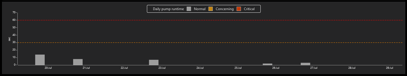

I upgraded the tubing in this machine to the 16/10 EPDM tubing from Aquacomputer and just got my first leak alarm. As far as I know, there are no actual leaks in the system and the alarm is simply due to the highly dynamic loading of the loop. At idle, no fans need to run and the pump slows down considerably. When a render comes in, the coolant temp quickly rises from 35C to 40C while the pump and fans respond to the increase in loading. The setpoint for everything is 38C (min fan speeds keep it below the setpoint at idle), but it overshoots by 2C even though the pump and fans are already set to "Fastest + 2." When the render is done, the coolant temp falls even more quickly than it rose. If the render job is a sequence of frames, then this full cycle could repeat as quickly as 60 times in 2 hours.
Am I correct that this cycling could be what's triggering the alarm? If so, what can I do to avoid the false alarms?

Varying the pump speed will have an effect on the loop pressure, but very little effect on system cooling. Perhaps to leave the pump at one setting might help?

It is a fairly restrictive loop, so with the D5 NEXT at its max of ~4800rpm, it flows only ~130 L/h. When I slow the flow rate down to 110 L/h, the coolant temp rises almost 2C while the system is under load. That's why I have the pump speed set to vary: it needs to be at max in order to keep the coolant temp down below 40C, and I figure that it's probably best if the pump isn't always running at max.
Am I just being too conservative with the coolant temp? Should I be allowing it to run higher? All of the blocks are Aquacomputer, flow meter is a HighFlow NEXT, the pump is a D5 NEXT, the res is an Ultitube, tubing is Aquacomputer 16/10 EPDM, all fittings except the barbs are brass ones from Alphacool, barbs are brass ones from Bitspower, the rads are copper from Alphacool, and the coolant is pure clear Aquacomputer DP Ultra.
GPU & CPU temps under full load are good, so those would be fine if the coolant got a bit warmer. I sort of arbitrarily chose 38C as the operating temp and 40C as the upper threshold. If the loop can safely handle 24/7 use at a higher temp, then I'll happily slow the pump down and leave it at a fixed speed.
Here is the daily pump runtime. I got a leak alarm on the 27th but not on the other days.
