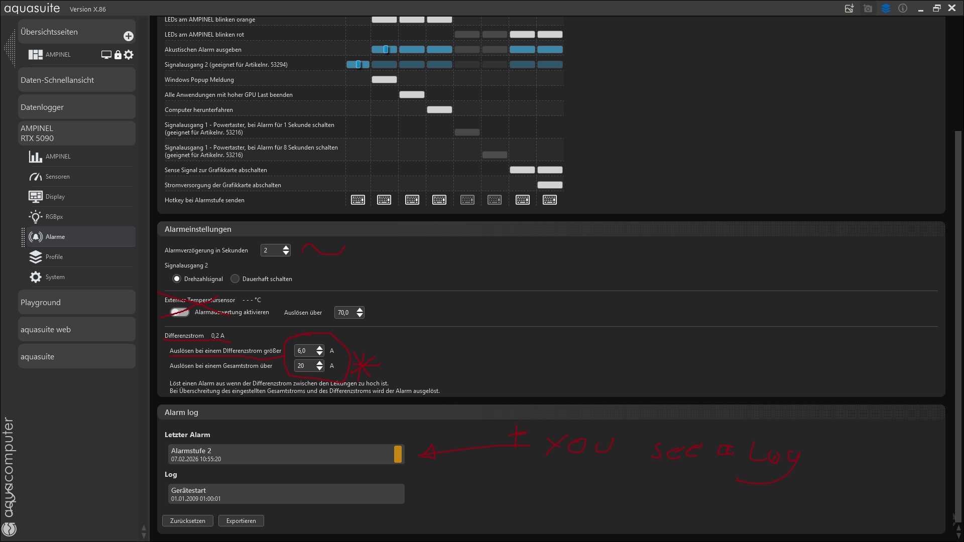

I just picked up an Ampinel and I'm still finding my way around Aquasuite. Is there a way to deliberately trigger the alarms and protections to verify they work — for example by lowering the current thresholds far enough that the device intervenes?

you could try to lower the amp difference settings in 1A steeps down.
and make a "stress Test" with 600W with the implemented Ampinel test
(depends on the quality off your Cable and Pin contacts).
»MTM« hat folgende Datei angehängt:
  • Ampinel Setting.jpg (267,61 kB - 30 mal heruntergeladen - zuletzt: 10. September 2026, 10:00)

So the exact settings on the picture? Because I also got the 53216 csble and would like to test that too... im not too sure what the settings say on the Pic as I don't speak German but I'll try figure it out...
