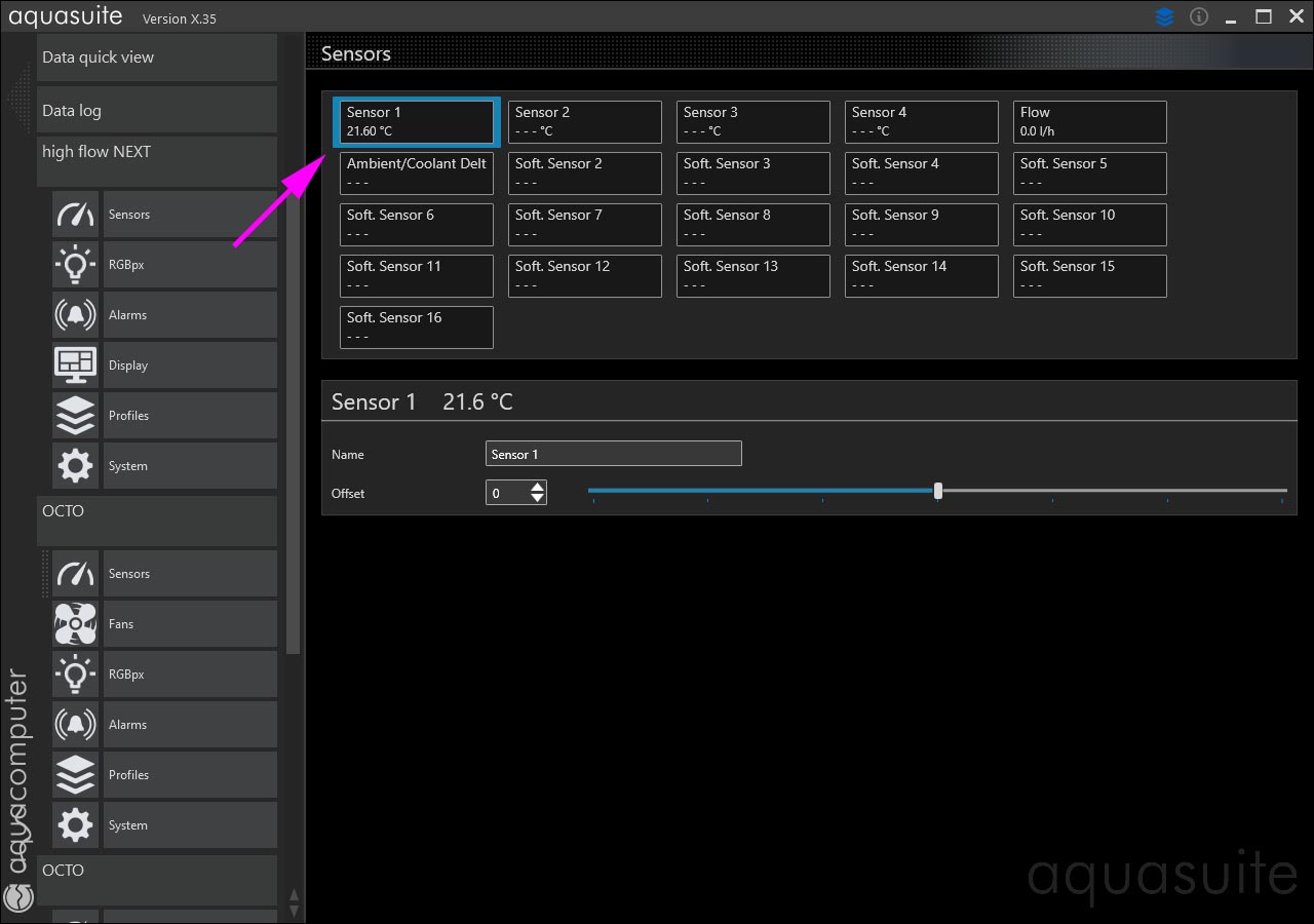

As to dissipated power calculation. the High Flow NEXT has a temperature sensor, and there is 1 external temperature sensor on the flow sensor, which is all you need, The power dissipated value will be most correct if the two temperature sensors are at the inlet and outlet of the radiator.
You can bring in temperatures from the OCTO by using the Soft.Sensor feature, as long as both devices are connected to USB.
