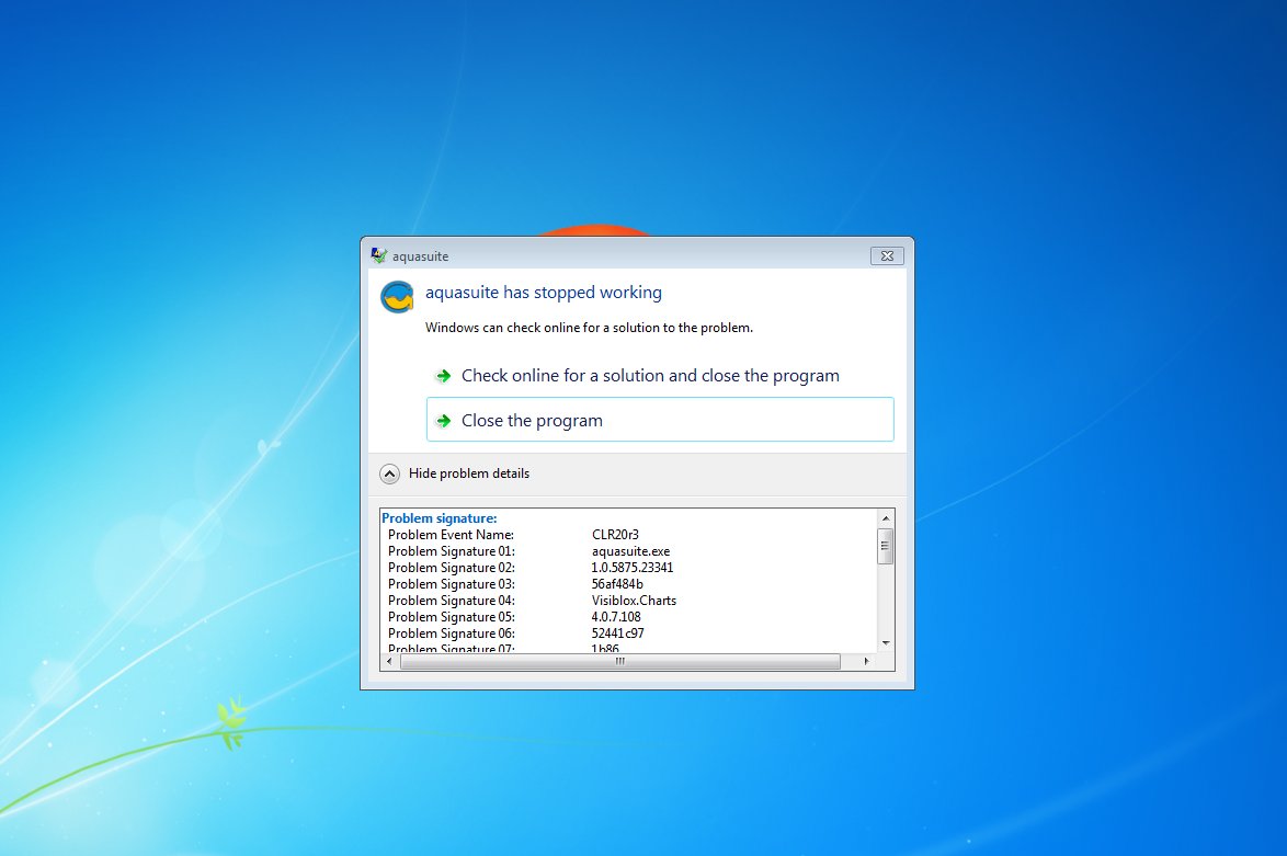

Aquasuite 216-2 crashes in Win7VM
Sonntag, 7. Februar 2016, 02:56
I have encountered a similar problem to "Infoseeker" above. In my situation I was successfully running aquasuite 214 in a 64bit Win7 VM using Virtualbox
under Ubuntu Linux 14.04LTS.
After I updated to 216-2, it initially ran well. The firmware update went without issue. I closed the program and VM and then reopened it the following day (today) and that's when the problem showed up. Version 216-2 of the Aquasuite starts and then pops up a dialogue
box indicating a problem with "signatures". The earlier version of
Aquasuite I was using worked just fine in Virtualbox (most current
version).
I know I can't go back to the earlier version of aquasuite
because of the firmware upgrade performed by 216-2. So am I totally out
of luck or is there a way to fix this in the Win7 VM?
I have attached a screen shot of the error message.
Dieser Beitrag wurde bereits 1 mal editiert, zuletzt von »Rizlaw« (7. Februar 2016, 04:03)
Montag, 8. Februar 2016, 12:17
To analyze these problems we need the full error message from the event viewer:

Dienstag, 9. Februar 2016, 09:00
There is a problem with one of the chart elements. It is likely that an old chart element is causing the problem. Should be easy to fix with an update.
I recommend to save your overview pages to a files as backup and then do a clean installation without reimporting any old stuff to check if this will run.
Rizlaw
Dienstag, 9. Februar 2016, 14:59
I don't understand what you mean by "save your overview pages to a file as backup".
1. What are "overview pages" and where can they be found?
2. How do I save them as a backup?
3. By "clean installation" do you want me to uninstall the broken 216-2 version of Aquasuite and then reinstall version 216-2 again, or do you want me to uninstall 216-2 and wait for an update?
Dienstag, 9. Februar 2016, 16:34
Maybe you have designed your own overview pages. That is the reason why I recommend to save them:
If you have not changed or designed overview pages, then there is nothing to save.
With clean install I meant to uninstall the current aquasuite, also confirm the removal of the config files and install it again where you select a new installation instead of an upgrade installation.
Rizlaw
Dienstag, 9. Februar 2016, 17:20
OK, I now understand. I have no "overview" page. I will reinstall as recommended and advise you how it went.
Rizlaw
Dienstag, 9. Februar 2016, 18:09
Thanks Shoggy,
I did as you recommended and everything is amazingly back to normal. I thought, with a new install, that I would have to recreate all my data settings, but it seems everything is stored in the Aquaero 6 computer. The re-installation of Aquasuite 216-2 picked up all the sensor, fan and controller data perfectly. :thumbsup:
Dienstag, 9. Februar 2016, 19:30
The general configuration is stored in the memory of the device and each time you start the aquasuite it will read the current settings from the device.

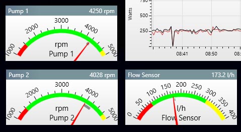

Freitag, 12. Februar 2016, 13:56
I seem to have the same results jakusonfire did with the aquaero D5/USB pump displays not updating.
2 screenshots of "screenshot" for pump1 & 2.
I confirmed that the aquaero display shows the exact same image as the "screenshot":
Screenshots showing both pump's USB & aquabus connection settings:
Both pumps showing correctly in the aquasuite display:
EDIT: included flow sensor object in aquasuite display
Dieser Beitrag wurde bereits 3 mal editiert, zuletzt von »InfoSeeker« (12. Februar 2016, 16:41)
Freitag, 12. Februar 2016, 22:04
Will be checked. There are already some other minor bugs on the list that must be fixed soon ;)
