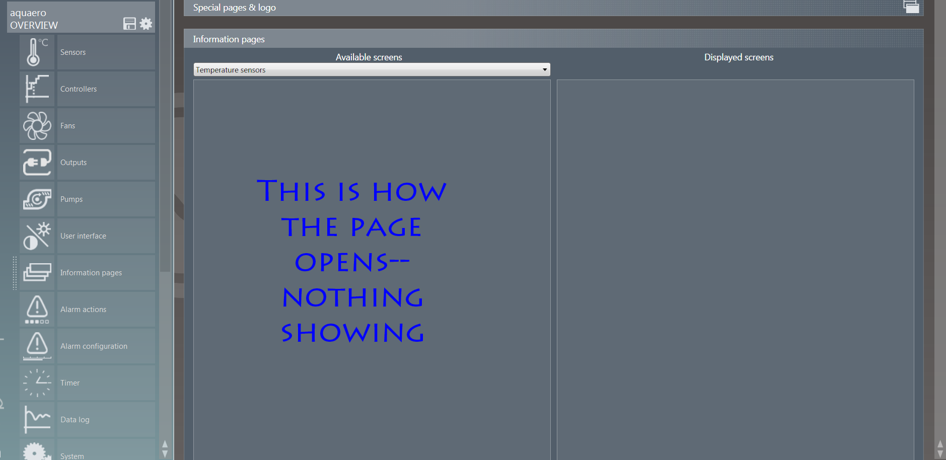

One last question, I am getting a blank section on the information page so I cannot customise which screens my XT is showing. Any ideas whats happened?

Are all the "Available screens" pages empty?
razortime
Samstag, 4. Juli 2015, 19:45
Hi Infoseeker, yes mine are all empty. I might try reinstalling aquasuite and see if that solves it.
razortime
Sonntag, 5. Juli 2015, 01:23
Done a fresh install and even setup as new and still I cannot select which screens I wish to display? The page is just blank???? :(
Yup!!... Got excactly the same with me I'm afraid!!.... Lucky I've only updated this one PC of my 3 PC's that run Aquasuite... Have also tried the re-fresh to Factory Defaults & done a complete re-install of Aquasuite ... No imorts of old saved files & not installed using any previous settings e.t.c, A Pretty much total new clean install & still I'm getting the same blank "Slightly Wobbly" Information Pages e.t.c.
Both my other PC's are running Aquasuite fine with the previous update we got, But this newer one seems to have cocked up somewhere along the line :-(.... Anyway ... Hope if others have been getting this problem have notified AC & maybe they'll be able to look into it & see if it's a fix that can be done soonish like.... Fingers crossed & all that :-)...

At least I am not going crazy and there is an issue with this information page. I also get the wobbly bits on mine.
Any input from Shoggy on this, it would be nice if this could be looked into? :)
This is an issue with the user rights when the software wants to access the images for this tab. There must be something messed up with your system configuration and/or user profile. Unfortunately I can not provide any help here how to solve this but it is no general problem with the aquasuite.

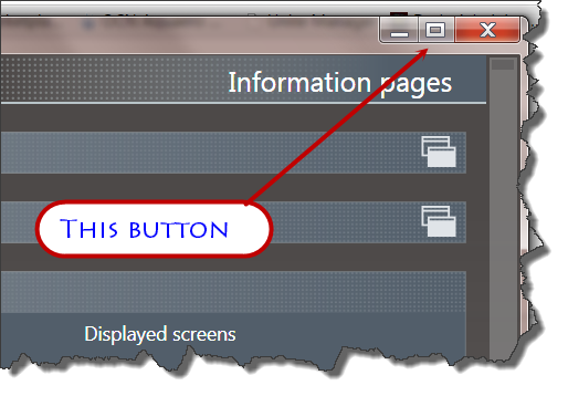

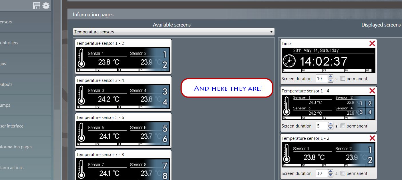

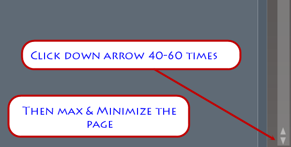

I experienced the same issue. By accident, I found a work-around.
With the "Information Pages" selected (and yes, it will appear as a blank page just as you stated), (1) use your mouse and click repeatedly on the light grey down-page arrow located in the bottom right side of the screen. Yes, I know, it appears that nothing is happening. But keep clicking--about 40-60 times. (2) Then minimize the page and then again maximize the page. If you do not see anything yet, repeat step 1. Then repeat step 2. This work-around works for me every time. Try it, you'll like it. :thumbsup:

Reads a bit weird. Could you please take a screenshot how it looks when you open the page, mark where you click and also provide a screenshot how it looks afterwards.

The Disappearing Information Pages
Donnerstag, 27. August 2015, 09:36
On another computer, all I have to do is to maximize--minimize--maximize the page several times, and the information pages appear.

What do you mean by minimize and maximize the page? Do you open another page inside the software or do you minimize the program itself?

In addition, once I click on "Information Pages" (and nothing appears), I simply can manually resize the window horizontally--and then the Information Pages appear--without maximizing--minimizing the window. This is much simpler.
All the other pages appear to function properly on my computer. So, this little hiccup on my particular machine doesn't bother me too much because I seldom need to access the Information Pages.
