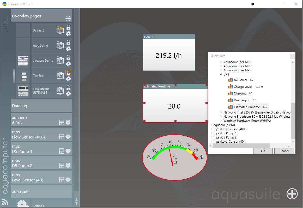

Currently, the "title" in aquasuite objects displayed on the desktop have the option for a user defined title in addittion to the default.
It would be most useful if the same approach could be taken to the "unit" name for the variable being displayed in a object.
This would be useful for items brought in via the Windows Services option, in that the imported information may have a "unit" that is not covered in the existing aquasuite "units" list.
For instance, the UPS battery status is displayed in minutes remaining, but aquasuite does not understand the provided unit and it is ignored.
If a similar procedure for title naming is implemented for "units", then the issue melts away.
No, we have implemented all units that we can get from the external interfaces. Some values has no units.
Montag, 15. Februar 2016, 15:30
Agreed, there are values without units, particularly switch state items, yes/no, on/off, etc.
And most sensor values use core units, volts, amps, RPM, temperature, percent, Hz.
But some sensor value units are unique, i.e. Min(utes), MB/s.
As system monitoring programs expand the devices they look at, the resultant sensor value units may be unknown to aquasuite.
My request was predicated on the concept of it being inconsequential if a particular unit type is not recognized, by allowing user defined units, similarly to what you do with sensor titles.
In the sample screenshots below the unit of interest is Min(utes).

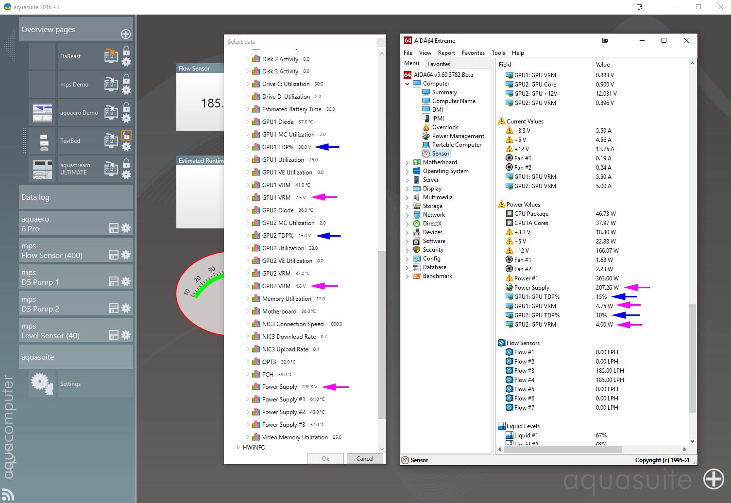

I noticed a couple anomalies regarding Sensor Units transferring from Aida64 via Shared Memory.
Some Units that should be Watts or % are all showing as Volts by aquasuite.
Dienstag, 15. März 2016, 14:47
this is currently when we cant read a valid unit. we are in contact with the aida64 team.
In the next version this issue is fixed and some more units are supported.

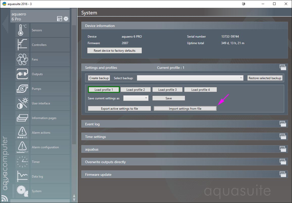

I have the Aquero 6 Pro. I went through some hell when I updated to 2016 - 3 from 2014/2.3. I did the update on top of 2014, didn't uninstall it but it wasn't running.
The problem started when everything went 100%, fans and pump. The firmware never succeed to update so I couldn't use the program. I managed to find my old software 2014, installed it, but no features in the aquaero tab where showing up, so I couldn't roll back and use it. System restore didn't fix it either. I deleted the software and installed 2016 - 3 again, did the firmware update and succeed, now I have to fix my old fan/pump settings.
Please advise how to update the software so it don't happen like this again.
Samstag, 26. März 2016, 01:49
When you upgraded from 2014/2.3 to 2016-3 you should have had to update the aquaero firmware also, once that is done you cannot go back to 2014.
The upgrade automatically saves the aquaero's profile prior to updating the software.
To retrieve your last profile, go to aquaero > System > Settings and profiles...
then click on the "Import settings from file" option, and import the last saved profile.

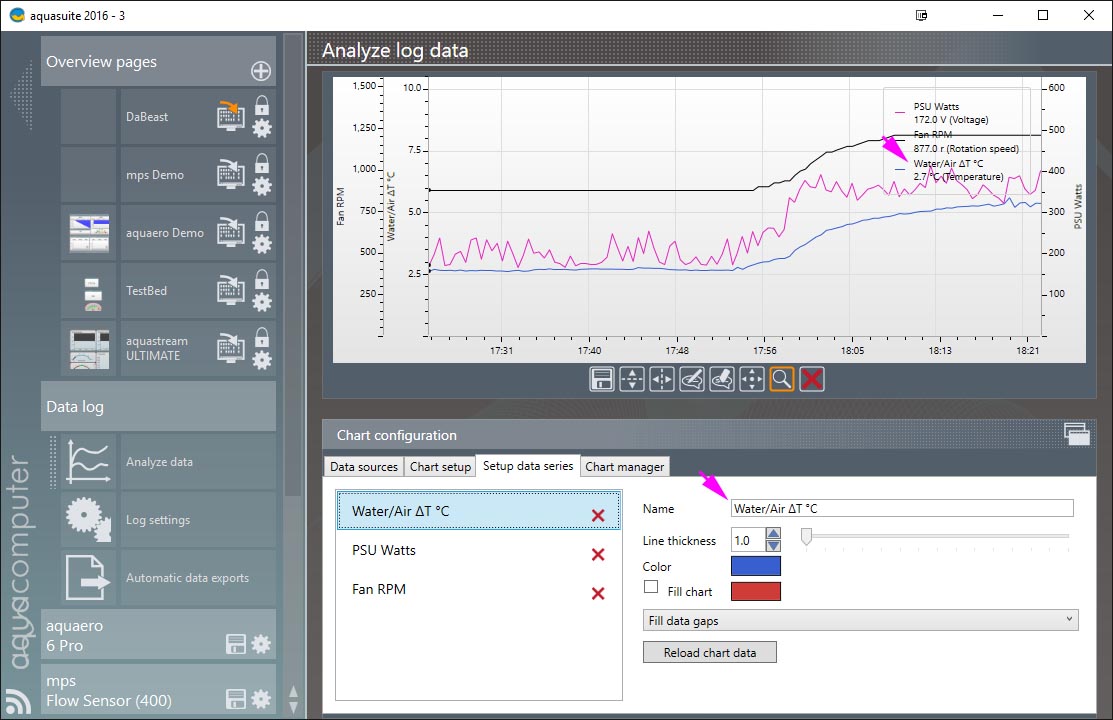

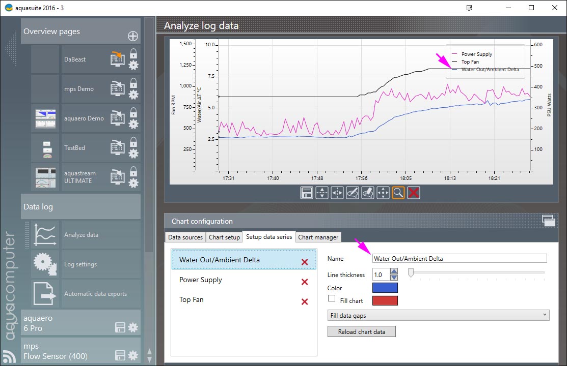

Minor Analyze data issue
Samstag, 26. März 2016, 02:03
When I create a chart with the Analyze data function, renaming the data sources under "Setup data series" is not persistent.
After saving the chart, and later reloading the same chart, the original names from the Log settings are listed again.

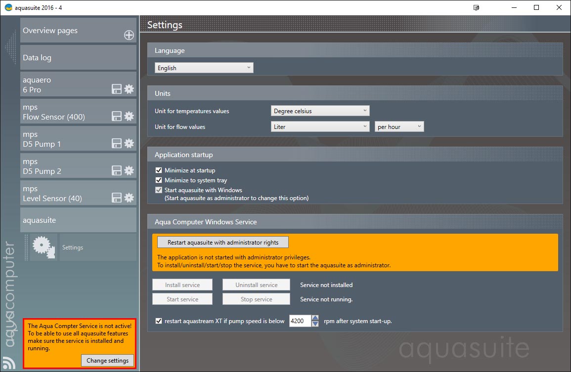

A comment on the AIDA64 Windows Services module... the Watt units are there, but all the % unit's are missing. They are present from HWiNFO.
The "min" unit (UPS estimated run time) is not there in either service, but it is unique and one of, so I expect that may be intentional.
2016-4 installed with Windows Services inactivated. Simple to correct, just not sure if that is the intent.
