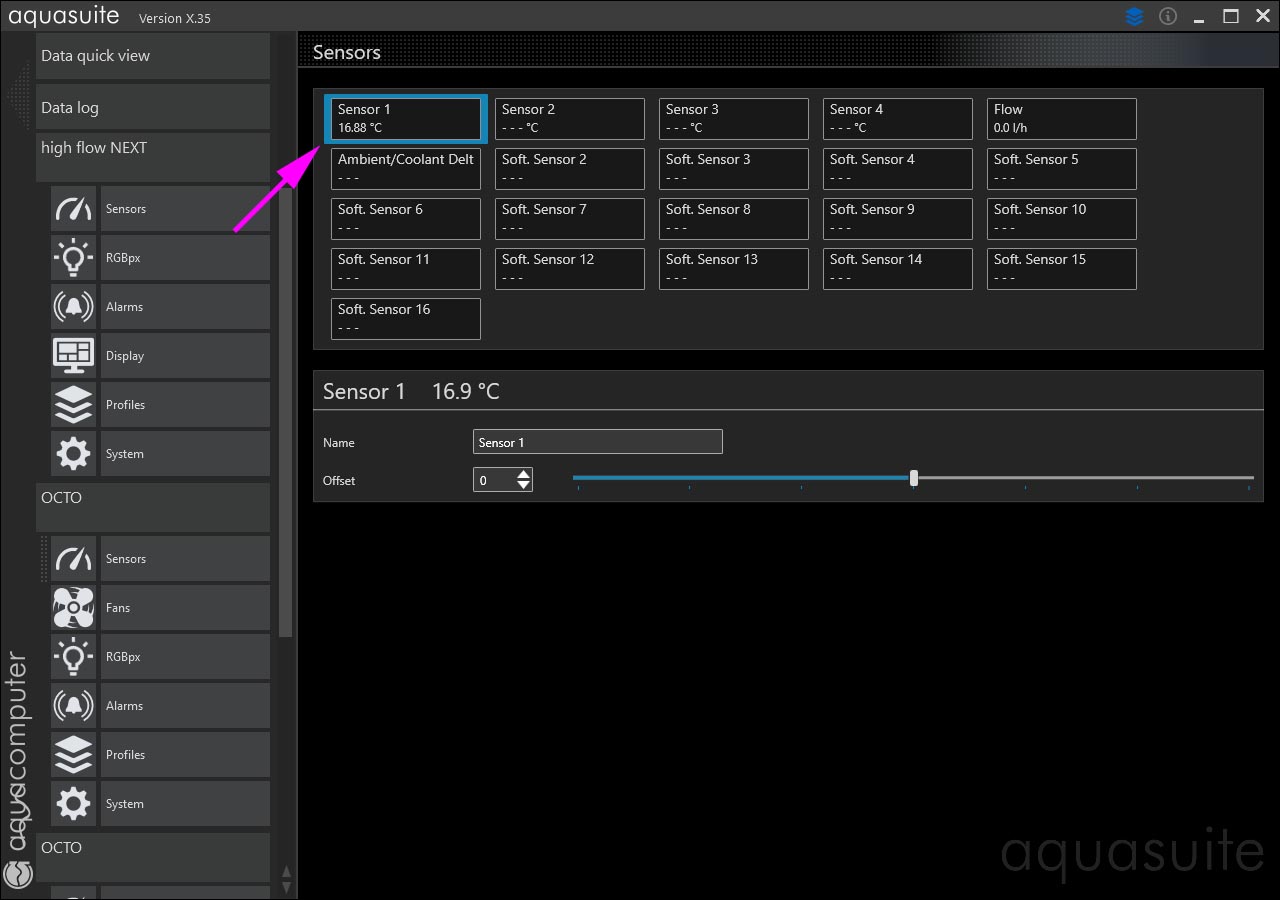

Samstag, 16. Januar 2021, 17:49
With the disconnect_all_to_firmware_update issue recently introduced, I thought I would update two octos and a flow next before I placed them in service.
That went well, no additional issues... will just have to install firmware items front and center for future updates.
But I noticed one item that may be an issue with the flow next, the temperature was reading 26 while in open air (ambient 16) flow_next_internal.jpg
I added a sensor to an octo to see what it read as ambient, which confirmed 16 degrees octo_external.jpg
I then inserted the octo sensor into the flow next's coolant tunnel which showed a result between ambient and the flow next internal sensor octo-inchannel.jpg
This 10 degree delta is substantial.
For my build the flow next will be right after the radiator, and a 2nd coolant sensor will be at the entrance to the radiator.
I had intended to allow the flow next to calibrate the 2nd sensor during downtime, but now I am concerned this will cause a not insignificant erroneous bias.
