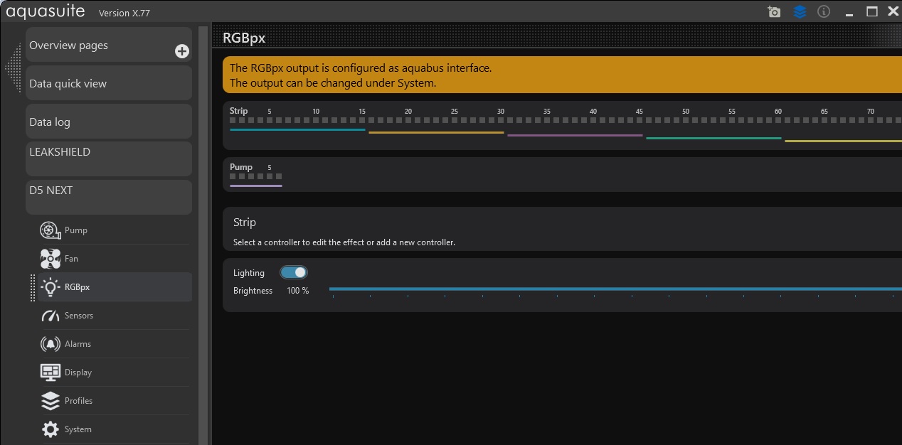

Hello team, this is my first post here, i hope I'm in the right section.I have an Ultitube LS 150 but i can't get the LED strips to work, do you have any advice please?
the LED strip is connected to the pump, i looked on the software but i never managed to get it to workThank you and good day
Dieser Beitrag wurde bereits 1 mal editiert, zuletzt von »lqx4684« (21. Januar 2024, 15:13)
PvF
Montag, 22. Januar 2024, 04:06
The LED-Ring has an "in" and "out" marking - be sure to connect the cable to the "in" Port.
The connector at the Pump is also very tiny - is the cable plugged in correctly?
Could you provide us a screenshot of the RGBpx Tab from your aquasuite? There should be two "LED configuration Lines" at the top - one marked with "Pump" and the second with "Strip"

The connector is well connected, and it is also well connected to the "in" i have never managed to get it to work
»lqx4684« hat folgende Datei angehängt:
lqx4684
Montag, 22. Januar 2024, 12:38

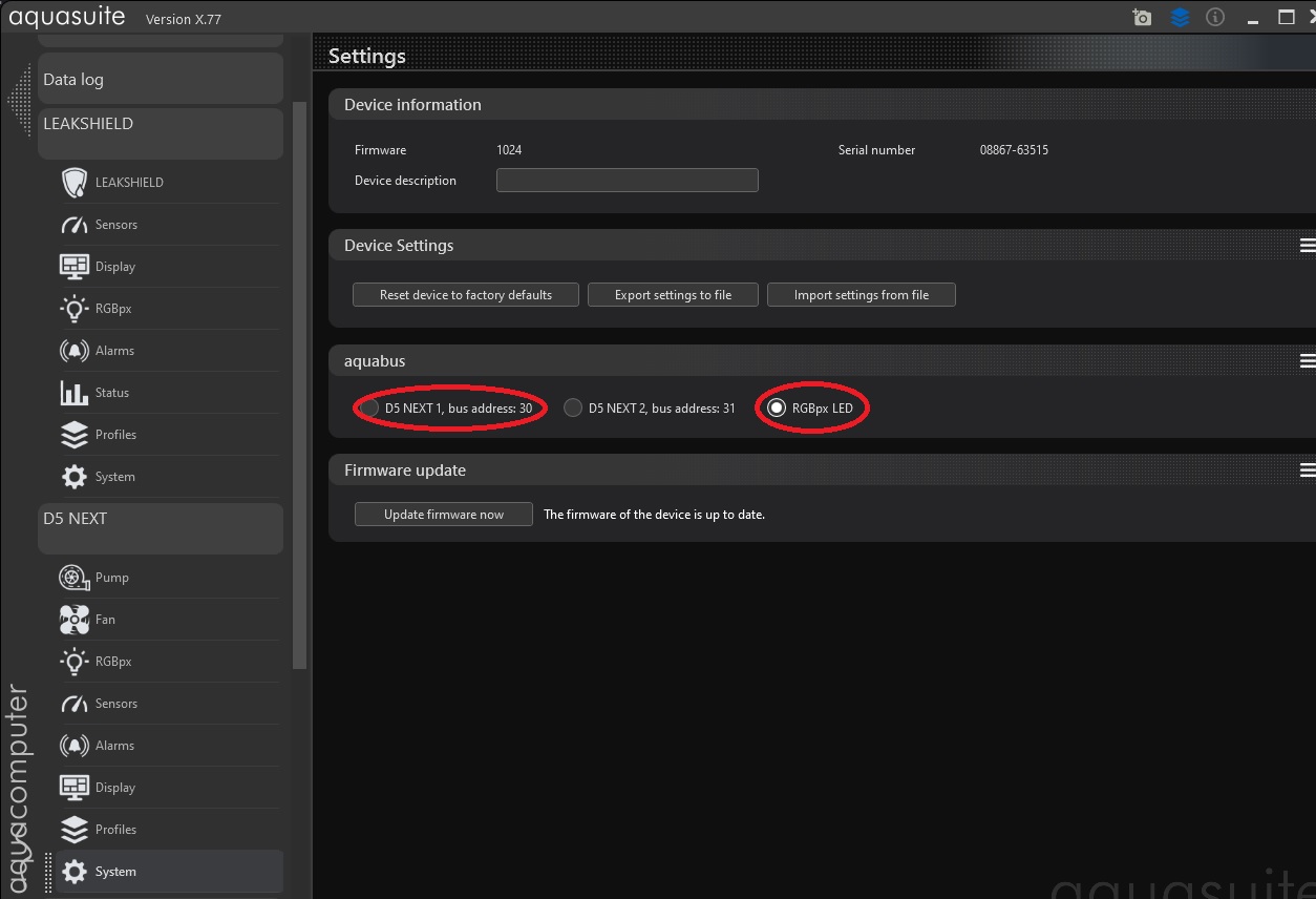

Ooooh !! I succeeded!! :D :thumbsup: I modified this:
I would still like to know what these 3 options represent?

PvF
Montag, 22. Januar 2024, 13:33
If you don´t connect the pump or other devices to the mainboard via USB and have an aquaero, the devices can exchange data via the so called "aquabus". You can assign one of two addresses to the D5 Next within the "aquabus" if you have a second Pump.
You have already figured out the third point yourself. The output is then not used as a bus interface but for controlling the LEDs.
The connection to the aquaero via aquabus has the advantage that it also works under Linux, for example, but then you are not able to control an additional LED stripe (as you already know)

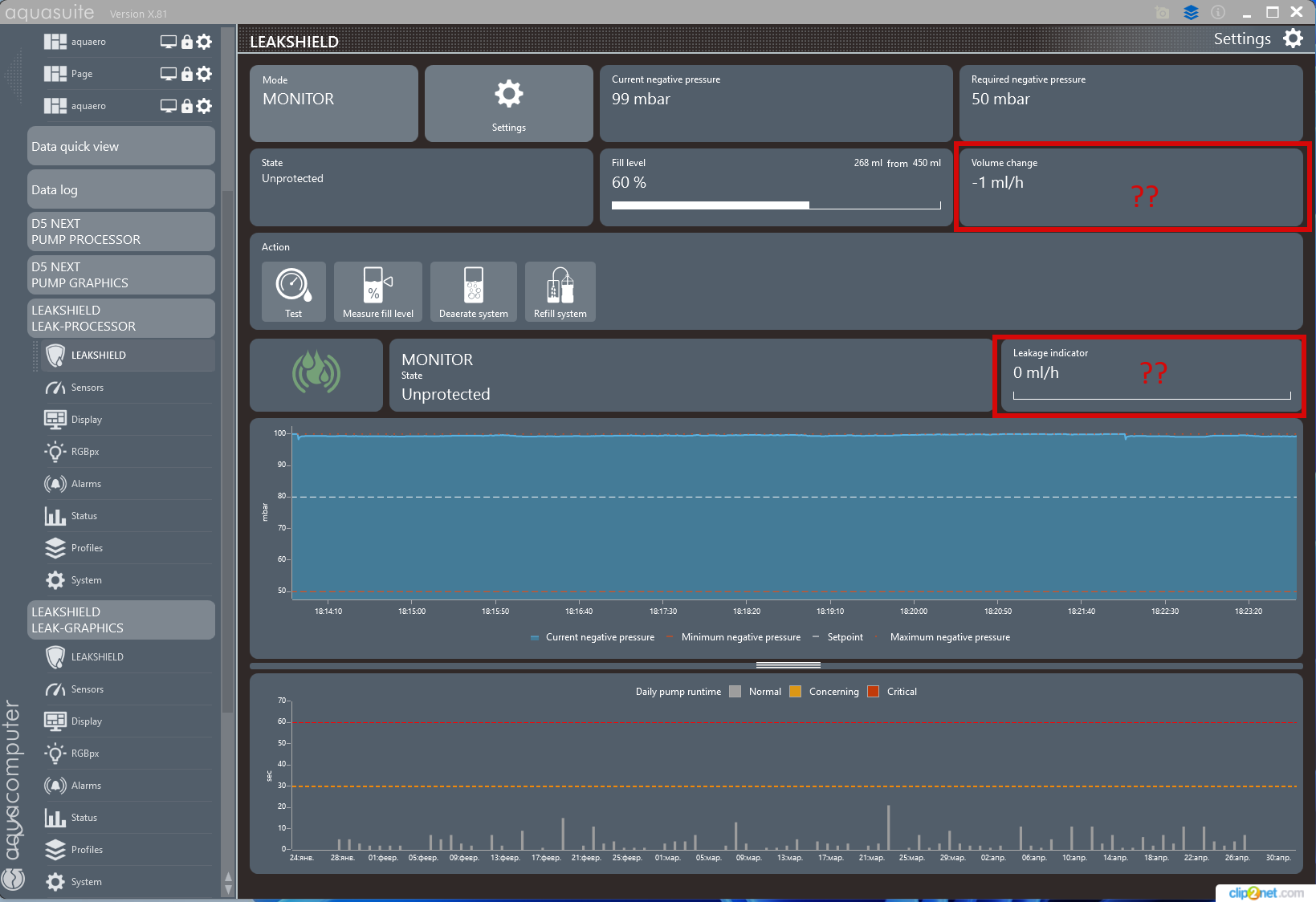

Piopi
Sonntag, 27. April 2025, 17:33
Hello everyone! Can you please explain what each graph in the picture means, circled in red squares.
I have two circuits installed, one for the processor and one for the video card. Everything is connected with copper tubes (partially flexible tubes).
On the second lickshield (video card), the negative pressure reaches minus 600 millibars, although the upper threshold is 465 millibars in the settings. This happens during games. The water temperature rises from 28 degrees to 33, the pump speed rises to 4800.
I would appreciate your help
