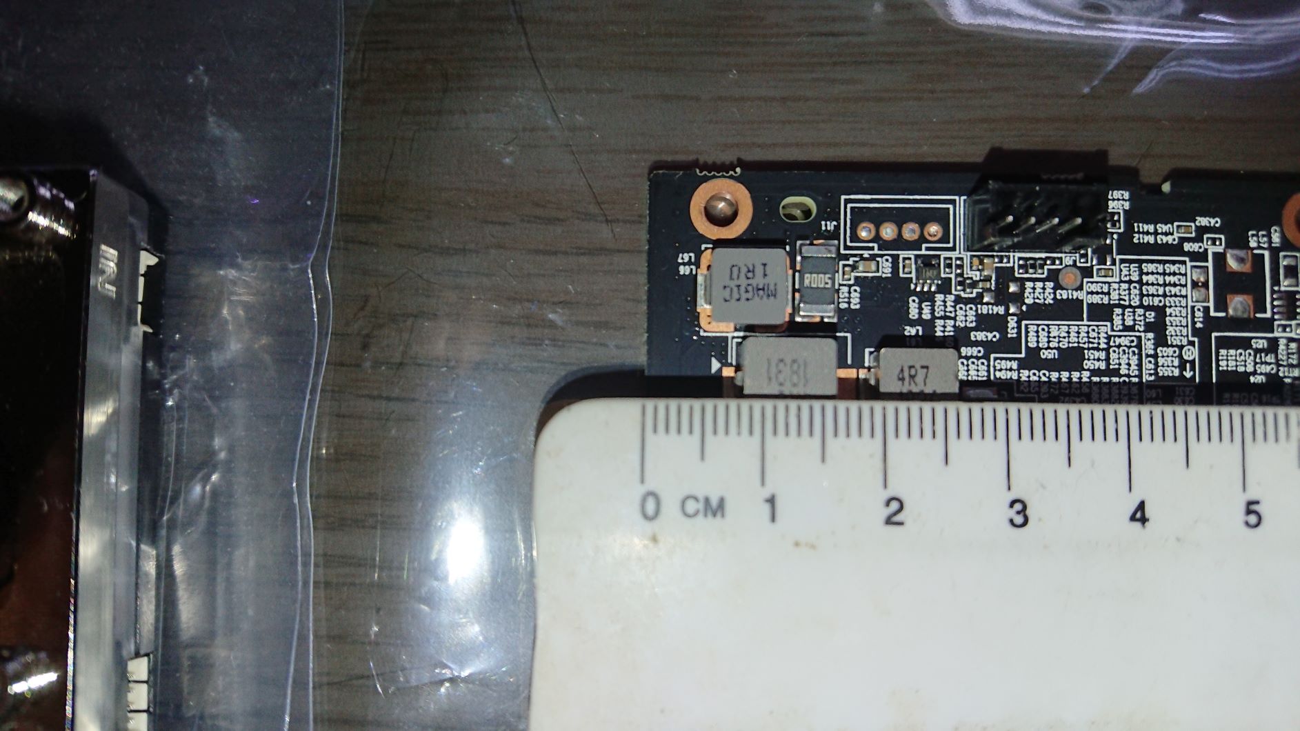

I am very disappointed at waiting 4 months for my order: 391194. To find that it doesn’t even fit my Gigabyte Gaming OC card as promised, I have attached pictures of the problem with measurements, there needs to be about another 2mm out of the slot to assure proper clearance.If you check this link : https://imgur.com/dXlTpUs it shows the difference in the FE and Gigabytes gaming OC cards. If you check the capacitors on the bottom right of the board (which is where my issue is).You can clearly see the caps are spaced out more on the gaming OC card, and you have obviously overlooked this. 8| I cannot believe that after 4 months you have still sent me a cooler with a fitment issue, I have now disassembled my graphics card assuming it would be right, and to be quite honest this is not good enough when you are charging a premium price for these, people assume it will work and it will be received in a timely manner, my experience with aquacomputer thus far is not a good one at all [font='&quot']☹[/font], I am very unhappy with the service as a whole, i have been lied to about delivery dates on 2 separate occasions, the wait is just absolutely ridiculous, especially when you factor in that you still got it wrong. I think enough is enough and you should send me a shipping label for the block and active backplate as after the wait i have had, and the fact you still made a product that is unfit for purpose, i should not be expected to pay for the return shipping, I want a full refund and i will take my business elsewhere. Sorry but, well what else can i say......... :cursing: :(X(

I have but felt others should know what there getting into when they order, as it clearly doesn't fit and the wait is long.

@ThiBor: The problem is already known on the Gigabyte cards and the cooler is already available in a new revision. See page 6 of the topic, from article # 203.
Moreover, it is Gigabyte's fault that the cooler doesn't fit, because they're cards do not stick 100% to the reference design, not Aquacomputer's.

Germanium my cooler was received a week ago and so called Gigabyte "new revision" page 12 article 236 as I requested, which has the cutout for the extra connector, but still does not fit, as explained this connector is not the issue, this is aquacomputers fault. Seems they overlooked the bigger cap spacings.:(
No, Gigabyte is clearly to blame for the misery: they advertise their GPU with the reference PCB and do not follow the instructions of Nvidia. Here is clearly the customer shitty by Gigabyte.
You purchased your cooler before it became known and introduced the change (you said your order was made over four months ago), so you got the first revision of the cooler. Please write the support, if he can change your cooler against the latest revision. A solution is always found.

As I've said, there was a note on my order and it has the cutout for the gaming oc connector, I PM'd stephan after ordering to tell him I had the gaming oc card. IT IS THE NEW REVISION !!! ?( :cursing:
I probably misunderstood that, excuse me.
As I said, write down their support. Maybe the info just went down. Aquacomputer is currently busy.
