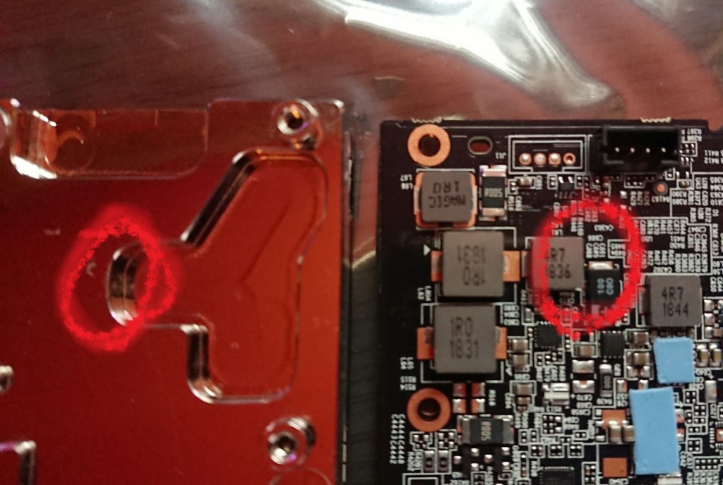

I am very disappointed at waiting 4 months for my order: 391194. To find that it doesn’t even fit my Gigabyte Gaming OC card as promised, I have attached pictures of the problem with measurements, there needs to be about another 2mm out of the slot to assure proper clearance.If you check this link : https://imgur.com/dXlTpUs it shows the difference in the FE and Gigabytes gaming OC cards. If you check the capacitors on the bottom right of the board (which is where my issue is).You can clearly see the caps are spaced out more on the gaming OC card, and you have obviously overlooked this. 8| I cannot believe that after 4 months you have still sent me a cooler with a fitment issue, I have now disassembled my graphics card assuming it would be right, and to be quite honest this is not good enough when you are charging a premium price for these, people assume it will work and it will be received in a timely manner, my experience with aquacomputer thus far is not a good one at all [font='&quot']☹[/font], I am very unhappy with the service as a whole, i have been lied to about delivery dates on 2 separate occasions, the wait is just absolutely ridiculous, especially when you factor in that you still got it wrong. I think enough is enough and you should send me a shipping label for the block and active backplate as after the wait i have had, and the fact you still made a product that is unfit for purpose, i should not be expected to pay for the return shipping, I want a full refund and i will take my business elsewhere. Sorry but, well what else can i say......... :cursing: :(X(
Dude maybe go directly to service via emal this is only a forum, where ac employees look into sometimes.

I have but felt others should know what there getting into when they order, as it clearly doesn't fit and the wait is long.

@ThiBor: The problem is already known on the Gigabyte cards and the cooler is already available in a new revision. See page 6 of the topic, from article # 203.
Moreover, it is Gigabyte's fault that the cooler doesn't fit, because they're cards do not stick 100% to the reference design, not Aquacomputer's.

Germanium my cooler was received a week ago and so called Gigabyte "new revision" page 12 article 236 as I requested, which has the cutout for the extra connector, but still does not fit, as explained this connector is not the issue, this is aquacomputers fault. Seems they overlooked the bigger cap spacings.:(

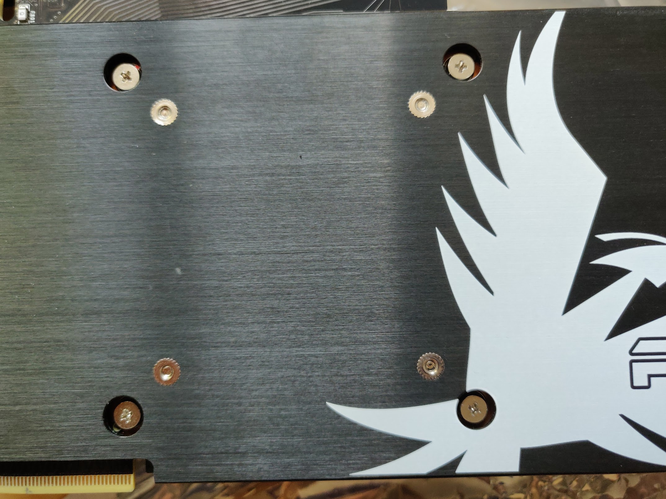

Ich habe meine kyrographics auch gestern bekommen, und ich habe ebenfalls das Problem, dass sie nicht auf meine Karte passt.
Mir ist absolut klar, dass das nicht an AquaComputer liegt, sondern am Kartenhersteller, der zwar grundsätzlich das ReferenceBoard nutzt, aber leichte Modifikationen anbringt, die es am Ende unbrauchbar für eine Custom-Kühlung machen.
In meinem Fall geht es um eine Gainward Phoenix 2080Ti GS. An zwei Stellen passt sie nicht, die eine ließe sich lösen, die andere sicher nicht so ohne weiteres.
Zunächst ist die Backplate von Gainward so angebracht, dass man sie nicht (ohne Spezialwerkzeug) entfernen kann. Die Backplate blockiert auch die vier Bohrlöcher um die GPU herum, so dass diese nicht mehr für die Kühlermontage verwerwenden werden können.:
Wenn man auf das Board schaut, dann sieht das so aus:
Man kann die vier kleinen Schräubchen um die GPU zwar entfernen, dann sieht man aber nur auf Gewinde, die Teil des Backplates sind, und die fest mit dem Board selbst verbunden sind (sieht eingepresst aus). Dieses Gewinde ist sicher nicht geeignet, einen Anpressdruck für eine GPU zu halten, und wird von Gainward auch nicht so verwendet.
Gainward montiert ihren Kühler über die 4 äußeren, Symmetrischen Löcher, wie man auf dem Bild der Backplate auch sehen kann. Die passen aber nicht für die kyrographics, weil es zwei Varianten für die Position von 2 der Löcher gibt (auf dem Bild des Boards die beiden unteren). Man sieht auf dem Board, dass es zwei Löcher gibt, die exakt symmetrisch zu den oberen Löchern sind und die auch Gainward verwendet, und zwei die etwas versetzt sind, die von AC verwendet werden, wie man hier sieht:
Die beiden versetzten Löcher gibt es zwar auf der Platine selbst, nicht aber im Backplate, das sich wie gesagt nicht entfernen lässt. Somit lässt die die kyrographics nicht verschrauben.
Das zweite Problem, dass Gainward einen zusätzlichen LED Anschluss ganz unten an der Platine verbaut, der ebenfalls my der kyrographics kollidiert, ist da fast ein kleines Problem.
Es dürfte klar sein, dass ich im Moment extrem frustriert bin. Ich gebe wie gesagt AC gar nicht die Schuld, wenn Gainward ihre Karten so zubauen obwohl sie eigentlich ein Referenzdesign sein sollten. Aber unterm Strich bedeutet das für mich einen enormen Geldverlust.
Ich bin mir noch nicht klar, was ich jetzt mache. Ganz auf eine wassergekühlte GPU verzichten (das erste mal seit über 10 Jahren)? Die GPU tauschen mit einem massiven finanziellen Verlust?
Frage an AC: Wärt ihr bereit die kyrographics zurückzunehmen? Sie ist ausgepackt, die Wärmepads und eines der beiden Wärmepaste-Spritzen ist verbraucht. Sonst ist das Teil aber völlig unbenutzt.
No, Gigabyte is clearly to blame for the misery: they advertise their GPU with the reference PCB and do not follow the instructions of Nvidia. Here is clearly the customer shitty by Gigabyte.
You purchased your cooler before it became known and introduced the change (you said your order was made over four months ago), so you got the first revision of the cooler. Please write the support, if he can change your cooler against the latest revision. A solution is always found.

As I've said, there was a note on my order and it has the cutout for the gaming oc connector, I PM'd stephan after ordering to tell him I had the gaming oc card. IT IS THE NEW REVISION !!! ?( :cursing:

Grestorn, ich verstehe dein Problem nicht so ganz. Was meinst du denn bitte mit "Entfernen nur mit Spezialwerkzeug"? Wie soll die Backplate denn fest mit dem PCB verbunden sein? Hab ich ja noch nie gehört. Verstehe ich nicht. Kann es sein, dass da einfach nur klebrige Pads drunter sind und du dich deshalb täuschst?
Und dein PCB soll abweichende Bohrungen haben? :huh: Die GW basieren doch auf dem Referenzlayout bis auf die Bestückung?!
Oder willst du unbedingt die original Backplate von Gainward verwenden?
Grestorn
Sonntag, 28. April 2019, 17:20
Ich hab es eigentlich beschrieben: Die Gewinde des Backplate der Gainward sind fest in die 4 GPU Löcher der Platine "eingepresst", d.h. ohne Gewalt bekommt man das Backplate nicht ab. Wenn es ginge würde ich die Backplate gerne abnehmen, aber das geht nicht - ich habe es durchaus probiert und dann einsehen müssen, dass ich keine Chance habe, ohne die Platine zu schrotten.
Aber selbst wenn das doch irgendwie möglich sein sollte, der LED Stecker ist ja das zweite Hindernis, das so ohne weiteres nicht zu umgehen ist.
Der zusätzliche LED-Port, der im Weg ist, ist klar. Die Backplate ist aber sicher nicht "verpresst". Ich glaube noch immer, dass deine Backplate einfach nur aufgrund der klebrigen Pads haftet, aber doch nicht fest verbunden ist.
Ich habe eine Palit und die Backplate sieht mir identisch aus (Palit / Gainward sind ja sehr ähnlich). Hat auch nur geklebt bei mir.
Dieser Beitrag wurde bereits 1 mal editiert, zuletzt von »TurricanM3« (28. April 2019, 21:36)
Grestorn
Sonntag, 28. April 2019, 21:45
Leider war ich so frustriert, dass ich vergessen habe, ein Bild von der Platine OHNE Schrauben zu machen. Und jetzt ist der Originalkühlkörper wieder montiert und ich komm nicht mehr ran, oder wieder alles zu demontieren.
Aber glaub es mir einfach: Wenn man die kleinen Schräubchen wegmacht, die man im Bild sieht, dann sieht man Gewinde, die absolut plan mit dem Board selbst sind, d.h. die Oberkante des Gewindes ist exakt auf der selben Höhe wie das Board selbst. Das meine ich, wenn ich schreibe, dass die Gewinde in die Löcher "eingepresst" wurden.
Ich denke schon, dass man ggf. mit dem richtigen Werkzeug die Dinger wieder rausdrücken kann. Mit normalem Ziehen am Backplate, um es vom Board zu lösen, geht es nicht, und das liegt m.e. nicht an irgendwelchen Klebern oder Wärmepads, weil das BP genau an eben diesen 4 Gewindebuchsen am Board festhängt. Mehr Gewalt wollte ich nicht anwenden, weil ich die Karte nicht zerstören wollte.
Zeig mal Deine Palit Backplate, wenn Du sie noch hast. Mach ein Bild davon (von der Seite, die zum Board zeigt), dann sehe ich sofort, ob das bei Dir genauso verbaut ist, wie bei Gainward. Ich möchte ja nicht zu 100% ausschließen, dass ich einfach zu doof war, aber ich kann es nicht glauben.
Aber wie gesagt, selbst wenn, dann wär das immer noch nur die halbe Miete. Wenn Problem mit dem LED Port nicht gewesen wäre, hätte ich vielleicht auch noch nachdrücklicher versucht, dass Backplate zu entfernen. Aber das hätte ja am Ende auch nicht zum Ziel geführt, und ich laufe dabei Gefahr, €1100 in den Lokus zu schieben, wenn ich die Karte damit ruiniere.
Bei Deiner Palit gab es am Board keinen zusätzlichen LED Port, oder?
Dieser Beitrag wurde bereits 3 mal editiert, zuletzt von »Grestorn« (29. April 2019, 08:14)
