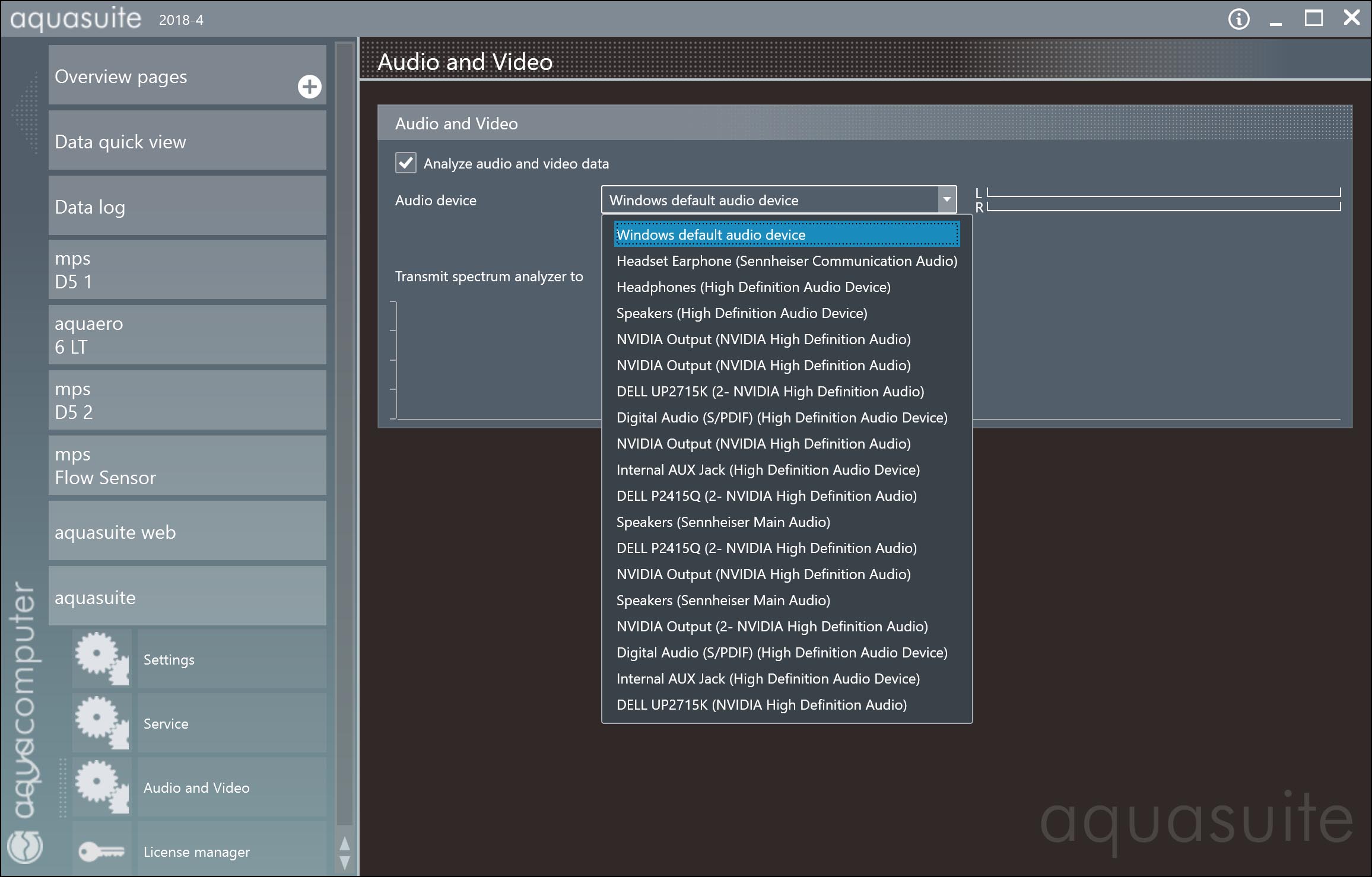

multiple audio devices in the drop down menu for Audio and Video
Samstag, 4. August 2018, 17:37
I have way too many audio devices in the drop down menu. Is this normal?

RE: multiple audio devices in the drop down menu for Audio and Video
Mittwoch, 8. August 2018, 06:27
My list looks similar in length.

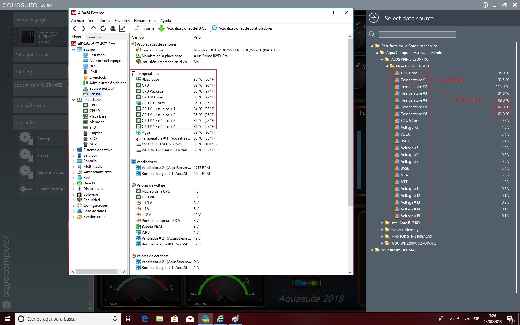

Hardware Monitor service
Montag, 13. August 2018, 07:32
Hello everyone.
Hardware does not identify the name of the sensors.
the temperatures are not correct.

RE: Hardware Monitor service
Montag, 13. August 2018, 15:25
Hello everyone.
I leave photo
You may want to install the free HWiNFO to monitor your PC's hardware.
The aquasuite does it to a degree, but it is not it's strength.
That way you can also compare the values reported between both services.

novax1
Montag, 13. August 2018, 17:54
hello thank you for answering.
I apologize but I have to translate from Spanish to English if there is something written that is not understood.
With the previous aquasuite verifications afuncionado perfectly.
and compared to aida64 the information is not correct at some temperatures.
ino identifies the names of the sensors.
example I leave an image.
