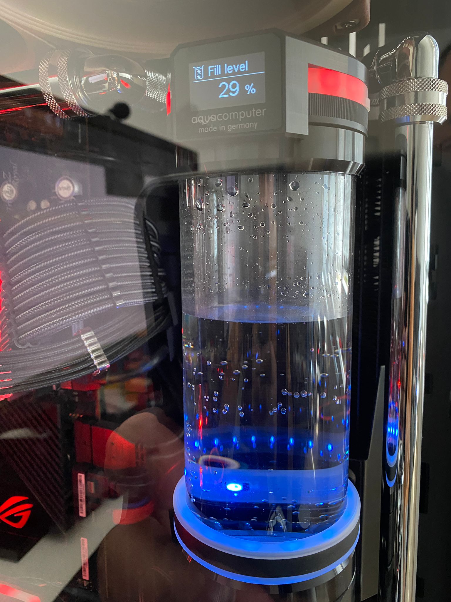

DaLiu
Freitag, 10. Mai 2024, 14:13
I changed my water in the system yesterday and I have a problem with Leakshield detecting the water level in the Ultitube 150, he says its only 29% full when in reality its most likely to be 60% full, how can I fix this?
»DaLiu« hat folgende Datei angehängt:
Freitag, 10. Mai 2024, 14:25
The LEAKSHIELD measures the entire water circuit and therefore also records all the air in the circuit.
If your system is completely vented, it should look better.
