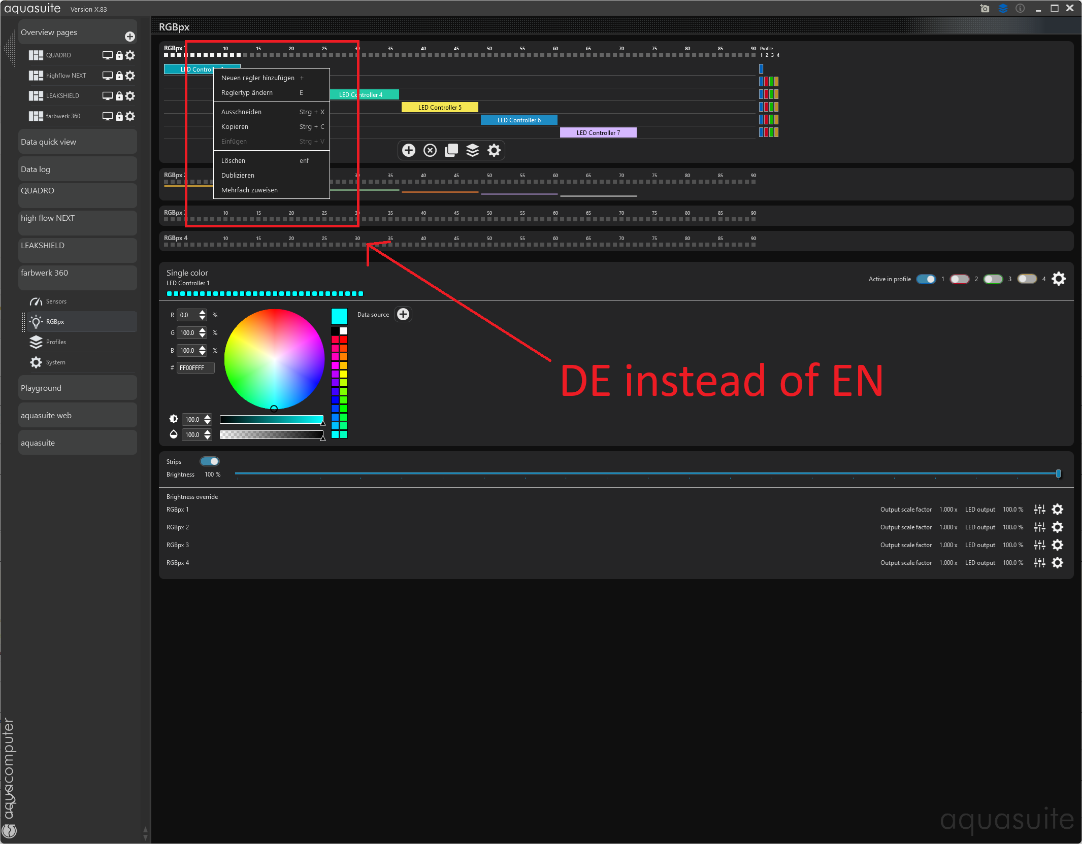

Can anyone confirm my two bug reports last page since 2025-09-02 update?
- RGBpx controller right-click menu is in German even if Aquasuite is set to English, picture attached
- Farbwerk 360 profile resetting to Profile 1 on cold boot

I always use profile 1 so i can't tell ^^
But the RGBPX menu is indeed in german for me as well
Farbwerk360 German Context Menu - I have confirmed that the RGBpx LED Controller right-click menu is in German when Aquasuite is set to English. This is true for all devices that have an RGBpx port including Farbwerk360, Octo, D5 Next, High Flow Next, and Leakshield. I think this is an Aquasuite issue and not specific to the Farbwerk360.

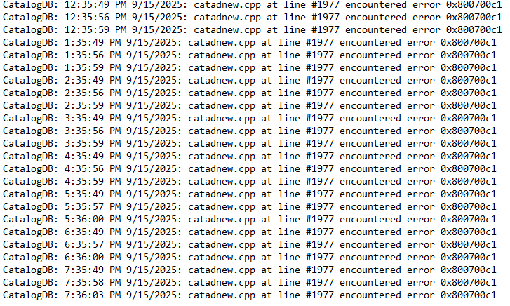

I’ve noticed something odd since updating Aquasuite to X.83 on my Windows 10 Pro 64-bit system. Starting the day after I updated (Sept 3), I’ve been seeing repeated catalog database errors logged in: C:\Windows\System32\catroot2\dberr.txt.
The entries look like this: CatalogDB: 8:29:43 PM 9/14/2025: catadnew.cpp at line #1977 encountered error 0x800700c1.
This error (0x800700C1 = ERROR_BAD_EXE_FORMAT) normally means Windows rejected a malformed or unsigned driver file. Based on timing, I suspect it’s related to the AquaComputerService.sys driver. It seems that AquaComputer may have moved the old WinRing0 Kernel-mode functions into AquaComputerService.sys instead of shipping it as a separate driver file. I think this is what is causing the repeated catalog errors logged in C:\Windows\System32\catroot2\dberr.txt. Since the day I updated to X.83 I have been getting ~65 of these errors per day. If you would like to check your system for this error, go to: C:\Windows\System32\catroot2\ and open the log file “dberr.txt”. Scroll to the bottom for the most recent dates and see if you have repeated catadnew.cpp … error 0x800700c1 entries starting after you updated to X.83. I would like to confirm that these errors are not specific to my system so I would appreciate if forum members who also see these errors in the log file “dberr.txt” would post to confirm the problem. Here is a screenshot of what these errors look like.

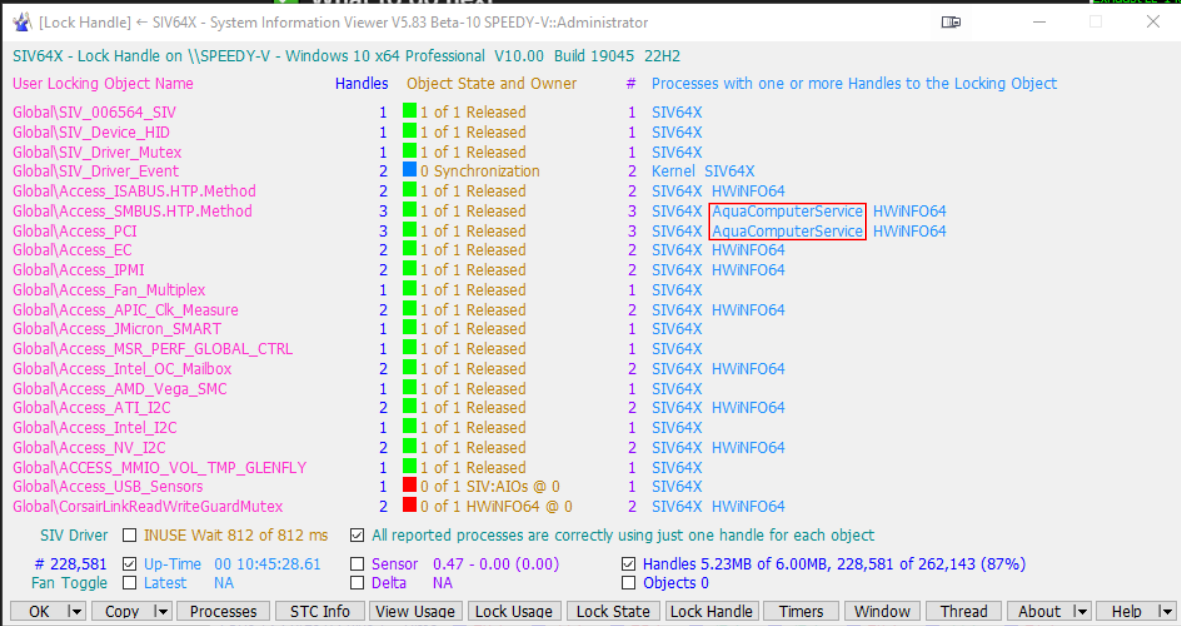

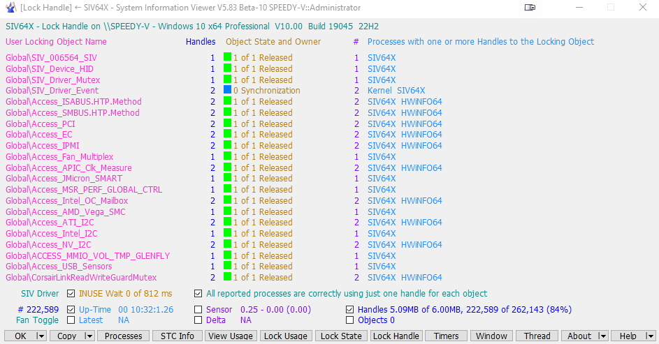

I tested to see if AquaComputer moved the Winring0 Kernel-mode functions into the AquaComputerService.sys driver, and my observations indicate that they have. When I enable any hardware monitoring in Aquasuite, the behavior is different than what it used to be. I use a program called SIV to monitor various hardware sensors. SIV is similar to HWINFO, but with deeper diagnostic tools. It has a panel called Lock Handle that shows which drivers are holding system mutexes while polling hardware sensors. The first screenshot below shows what the SIV Lock Handle panel looks like when I have not enabled any hardware monitoring in Aquasuite. The panel shows that SIV and HWINFO are both holding system mutexes (locks) while polling hardware sensors. This is normal.
Before the X.83 update, enabling any Hardware Monitoring category in Aquasuite caused Winring0 to appear in the SIV Lock Handle panel. Disabling all Aquasuite hardware monitoring made Wingring0 disappear from the Lock Handle panel. After updating to X.83, I have observed new behavior. Now, enabling any Hardware Monitoring in Aquasuite makes AquaComputerService appear in Lock Handle instead of Winring0. Windows Defender also immediately issues a Severe Threat warning, listing Winring0 as detected in AquacomputerService.sys. In addition, disabling all Hardware Monitoring in Aquasuite no longer makes it disappear from Lock Handle. Once triggered, the AquaComputerService.sys driver persists after disabling all Hardware Monitoring in Aquasuite, and even after closing Aquasuite. The only way to unload it is to stop/restart the Aqua Computer Service or reboot. The Lock Handle panel below shows AquaComputerService.sys is still running even after disabling all Hardware Monitoring in Aquasuite. The next image shows Windows Defender immediately detected Winring0 in AquaComputerService.sys.
This behavior leads me to believe AquaComputer integrated the WinRing0 kernel-mode code into a new driver named AquaComputerService.sys in X.83. The separate AquaComputerService.exe process is still required for Aquasuite to function (tray icons, presets, RGB control, and USB device communication), whereas AquaComputerService.sys exists only to provide low-level PC hardware monitoring. Enabling hardware monitoring now loads the embedded kernel-mode component in AquaComputerService.sys. Once active, this driver persists and is immediately flagged by Defender. I don’t understand why Aquacomputer would do this. Integrating an unsigned Winring0-style kernel-mode driver into AquaComputerService.sys is now causing Defender to flag AquaComputerService.sys as a Severe Threat. Eventually Defender will delete AquaComputerService.sys, which it did while I was testing. Also, once this driver is started, it is no longer unloaded by disabling hardware monitoring in Aquasuite or even closing Aquasuite. It is also likely causing the catalog errors being logged in C:\Windows\System32\catroot2\dberr.txt likely since Windows now treats AquaComputerService.sys as a driver package that must be signed, unlike the old WinRing0.sys which CatalogDB ignored.
By embedding the old WinRing0 kernel-mode functions directly into AquaComputerService.sys instead of replacing them with a properly signed driver, AquaComputer has actually made the situation worse. Previously, WinRing0.sys was an unsigned add-on file that Defender sometimes flagged but CatalogDB ignored. Now, with X.83, the new AquaComputerService.sys driver is treated as a full driver package, so Defender still flags it as vulnerable and Windows now logs continuous catalog validation errors. The WinRing0 code is still there, but the integration has introduced new problems on top of the old ones. These issues will persist until AquaComputer fully eradicates WinRing0 code and replaces it with a properly signed driver.
Farbwerk360 Profile Load - I have 2 Fabwerk360s in my system. They are loading the proper profile after booting up. In my case, the profile they load is determined by a Global Profile, which is set to load Profile 4 at system startup. If you are using Global Profiles, I suggest checking how they are set up. Your Farbwerk360 profile may be getting changed to Profile 1 in your default Global Profile
Thank you for confirming the language issue in those menus. I hope it gets fixed soon and we don't have to wait several months between updates like last time.

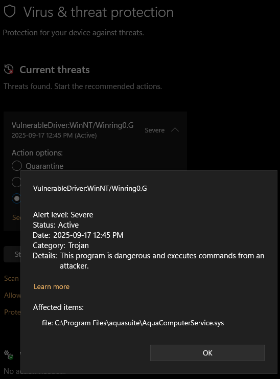

As of Sept 17, 2025 Windows Defender is now upset about Aquacomputer's use of WinRing0 on my machine as well. I understand a fix is coming, when might that be?
Information about Windows Defender warning "HackTool:Win32/Winring0" (AquaComputerService.sys)
[attach]11162[/attach]
Same here, I though that disabling all hardware monitoring from aquasuite got round this problem; obviously not.
Edit: Its not affected aquasuite functionality for me as far as I can tell.
