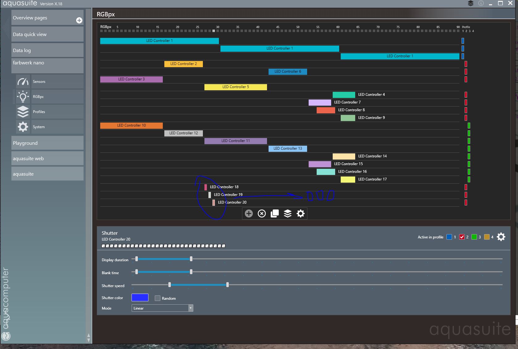

Hello. I've just tested insider vesrion x18 with new RGBpx effects. But i have a question. Will it be possible in near future make possible like divide leds in one line.
F.e. now you can apply only 1 effect on one line. And to add new affect need to use another line. But the maximum number of lines are 20. If you copy not multiassign.
F.e. on the other hand thermaltake now have their new software for creating effects and they going in 1 line. One by one. Is this possible to make in aquasuite?
Maybe this is bad example.
